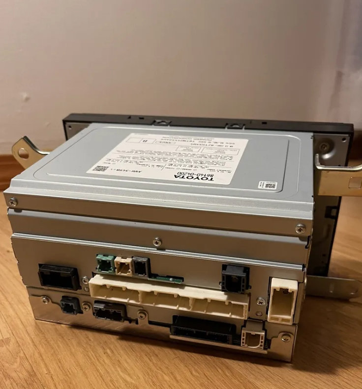

    I have a 2019, premium audio non-JBL. Looking to upgrade to a navigation capable 2020+ HU. 86140-04200 is what I’m after? Pic below, looks like it has the gps unit?

    You are correct.

    I think I know the answer, but is there any way to use the nav unit (lower portion below main head unit) from my 2019 for a non nav capable 2020+ unit?

    No it won’t work.

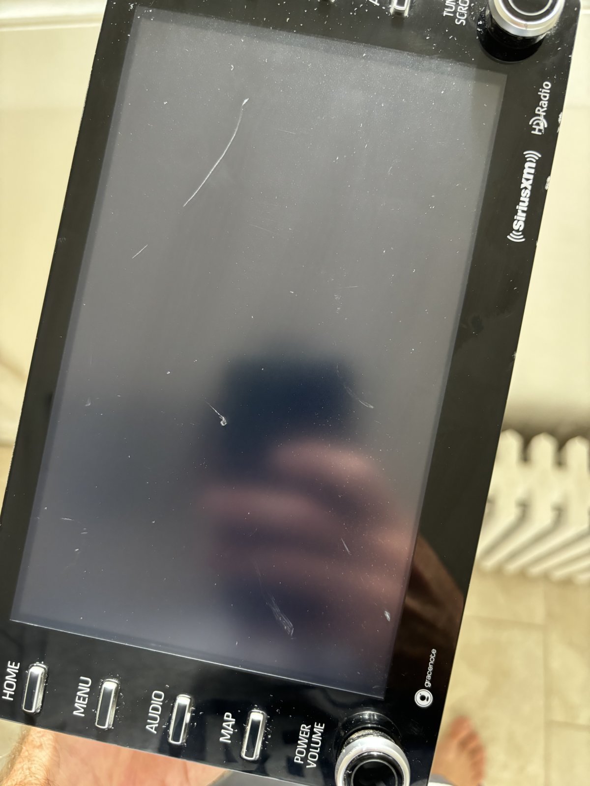

    Anyone have experience with replacing the front of a head unit? Everything works, just have some scratches I don’t want to look at

    I would go with an aftermarket, I did and only thing I miss is the receiving text messages through the entune.

    I suppose you could see if a screen protector that goes on wet makes the scratches bearable.
    Otherwise, do your research on Crutchfield.Com for aftermarket units that fit the truck.
