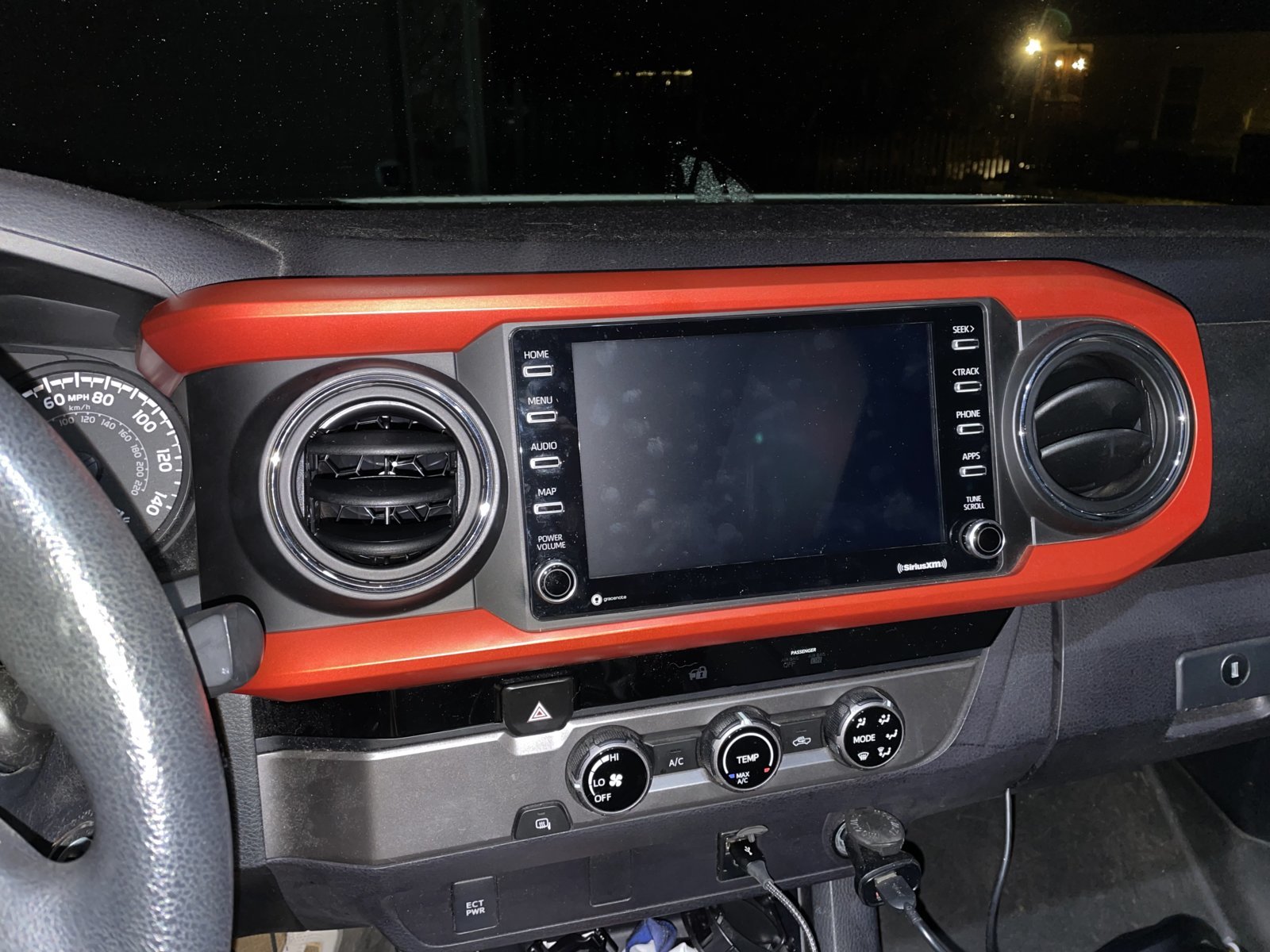

    Adding a little color to dash with the new Entune 3.0 Plus 86140-04230 head unit.

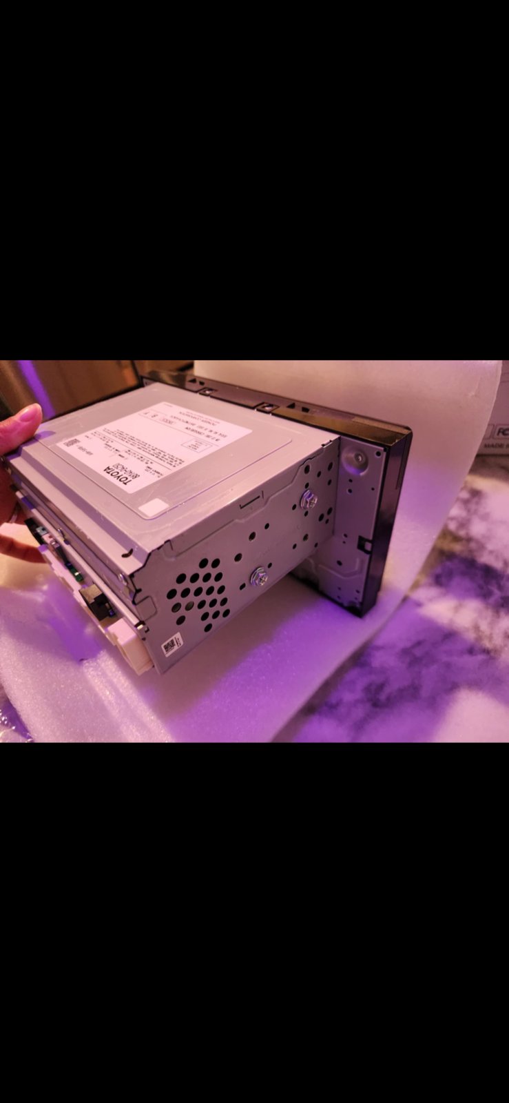

  19. May 9, 2024 at 2:57 PM
    #79
    Captbrad88
    Captbrad88 Well-Known Member
    Jul 18, 2018
    #259774
    383
    Brad

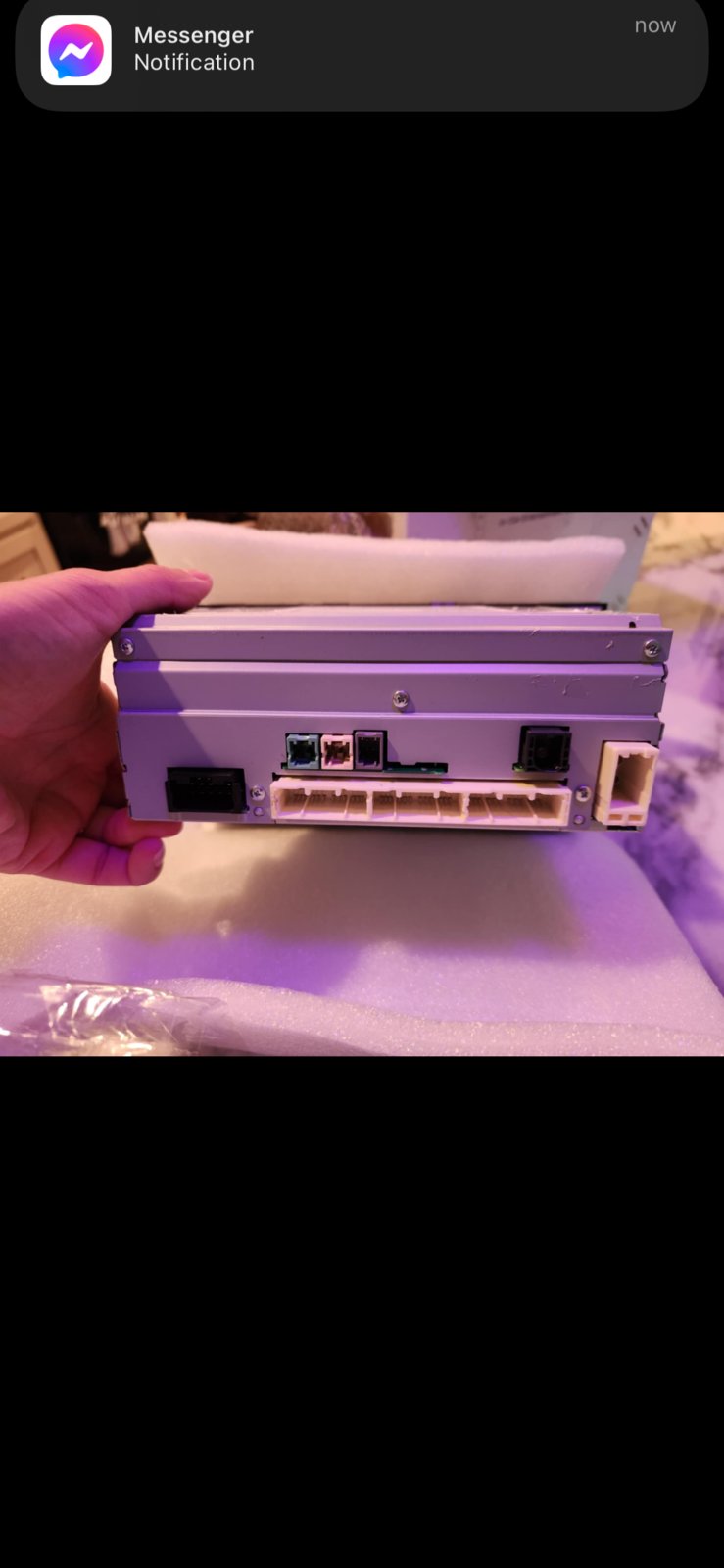

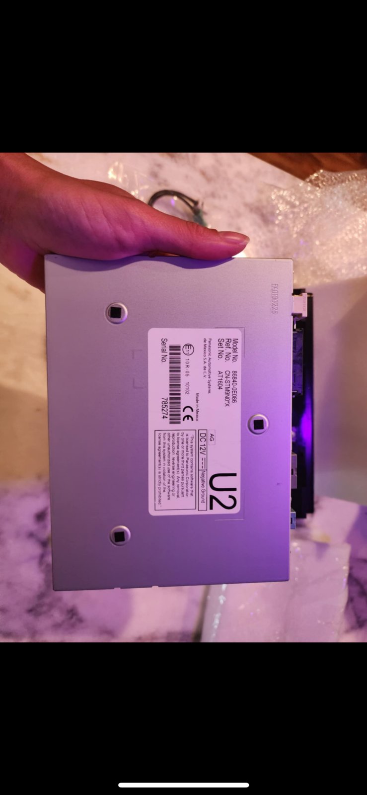

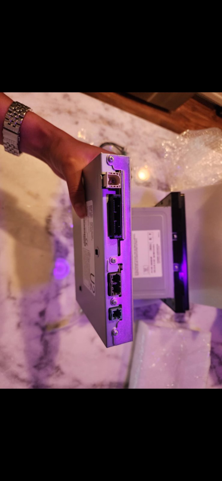

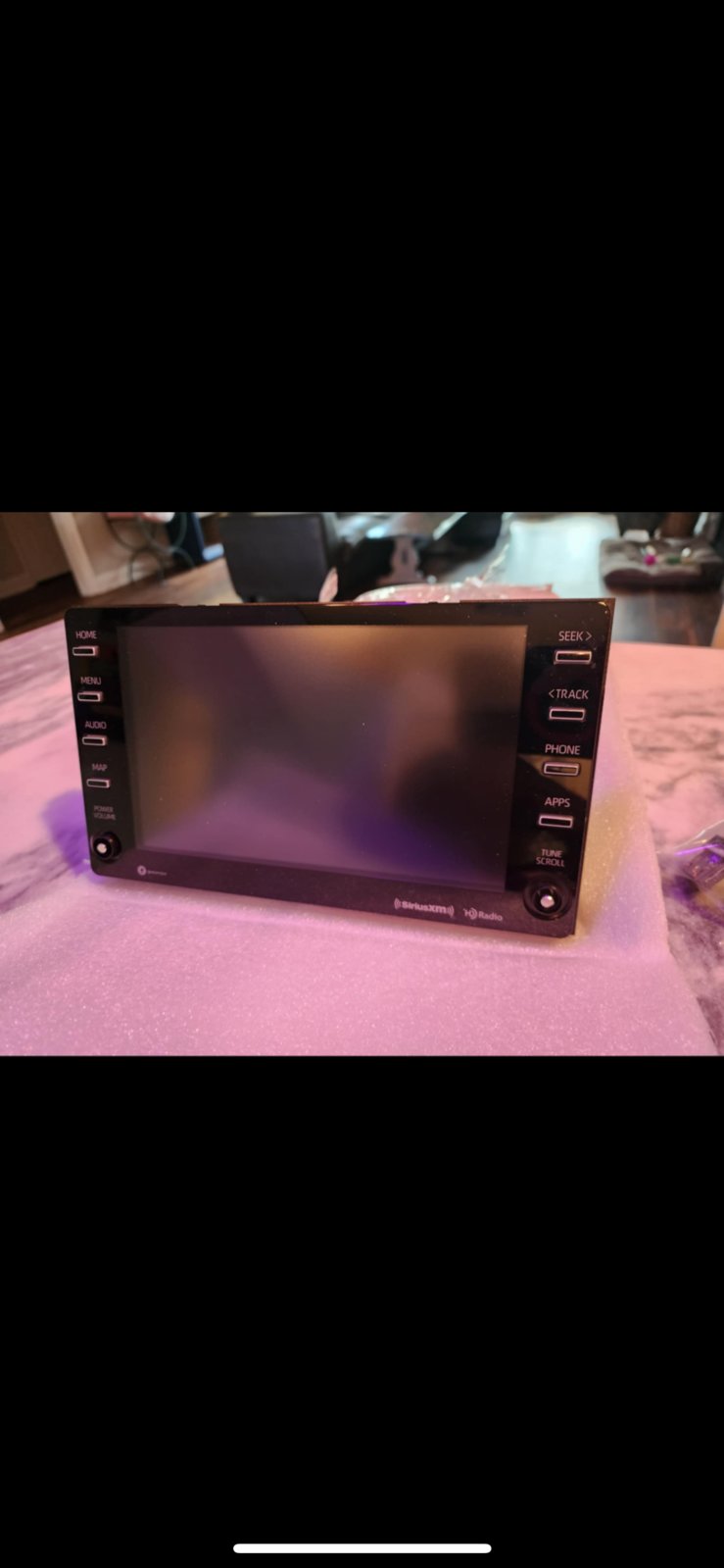

    2018 Tacoma trd offroad
  20. May 9, 2024 at 2:59 PM
    #80
    Captbrad88
    Jul 18, 2018
    #259774
    383
    Brad
    My new radio I got from a user on here jsut got in, I’m kinda stuck at work for the next two weeks so don’t get my hands on. But I’m assuming that small box is the nav unit. I ordered the harness without that nav, I’m assuming I messed up and should have got the harness that has the nav unit.
