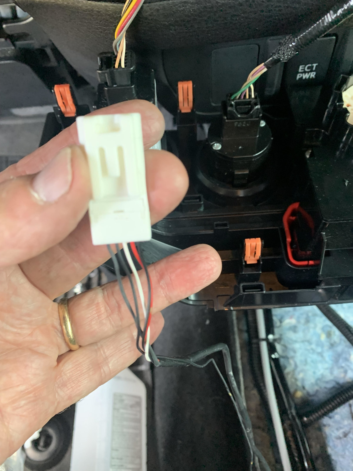

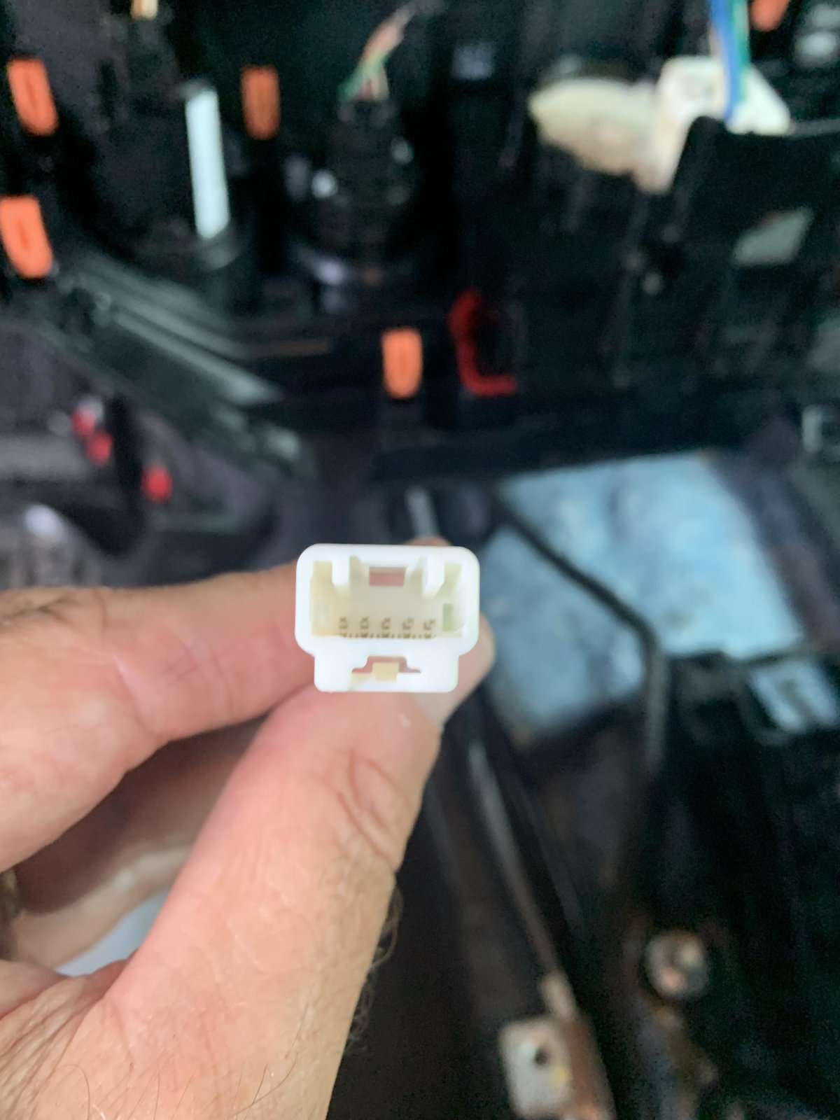

    I have this HU currently 86100-04163 premium-non JBL. Would you be able to tell me (identify) which port is the 3.5mm on the radio? I have abandoned the factory harness for the media port and successfully turned the port into a fast charger. I want to disconnect at the HU the five wires that went to the 3.5mm jack but can't figure out which is which. In addition, I want to connect the HU with a cable for the 3.5mm jack to the Leewa cable below. Any ideas if such a cable exists? Thanks!
    LEEWA Car Audio USB AUX Interface Adapter for Toyota Corolla Camry Highlander Sienna RAV4 Prius AUX Cable #CA7160 (aliexpress.us)
    Here are some closeups of the female end for the 3.5mm jack. I need a cable from here to the HU 3.5mm connection.

    The grey plug at the HU is for the USB is there a plug at the HU for the 3.5mm jack as well?
