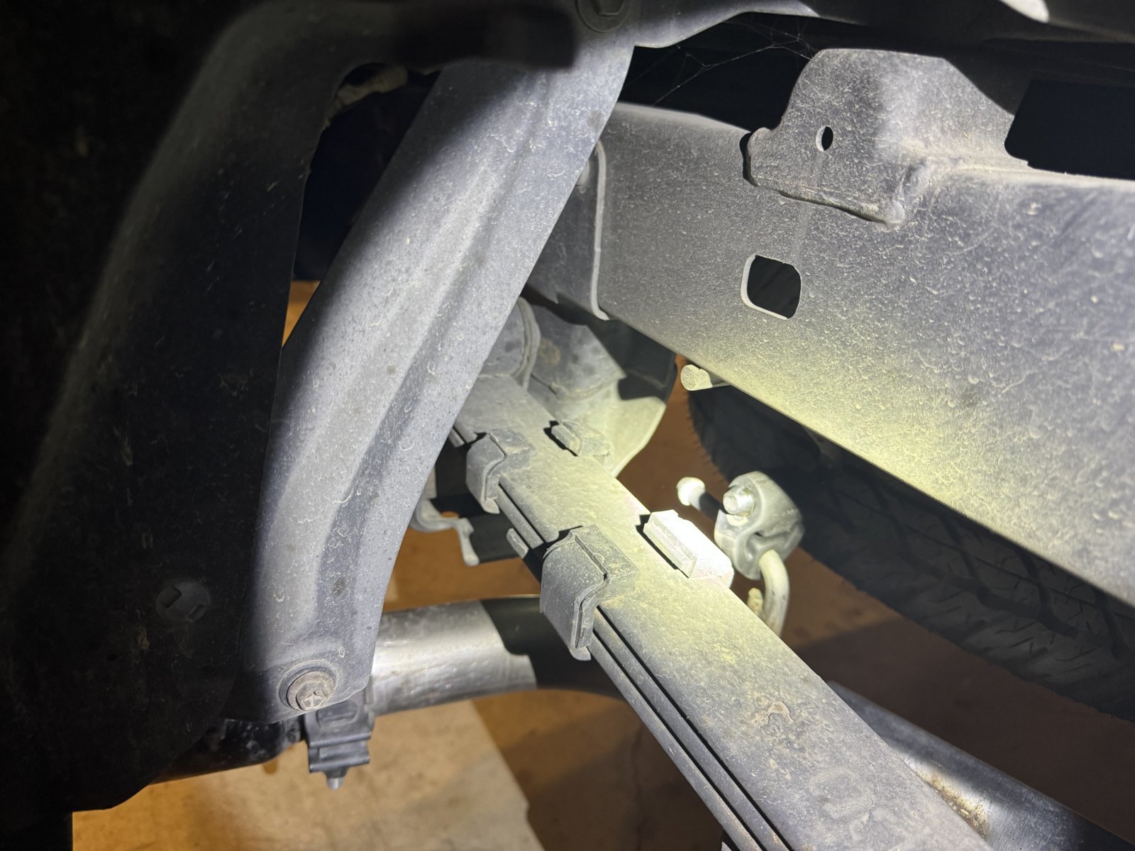

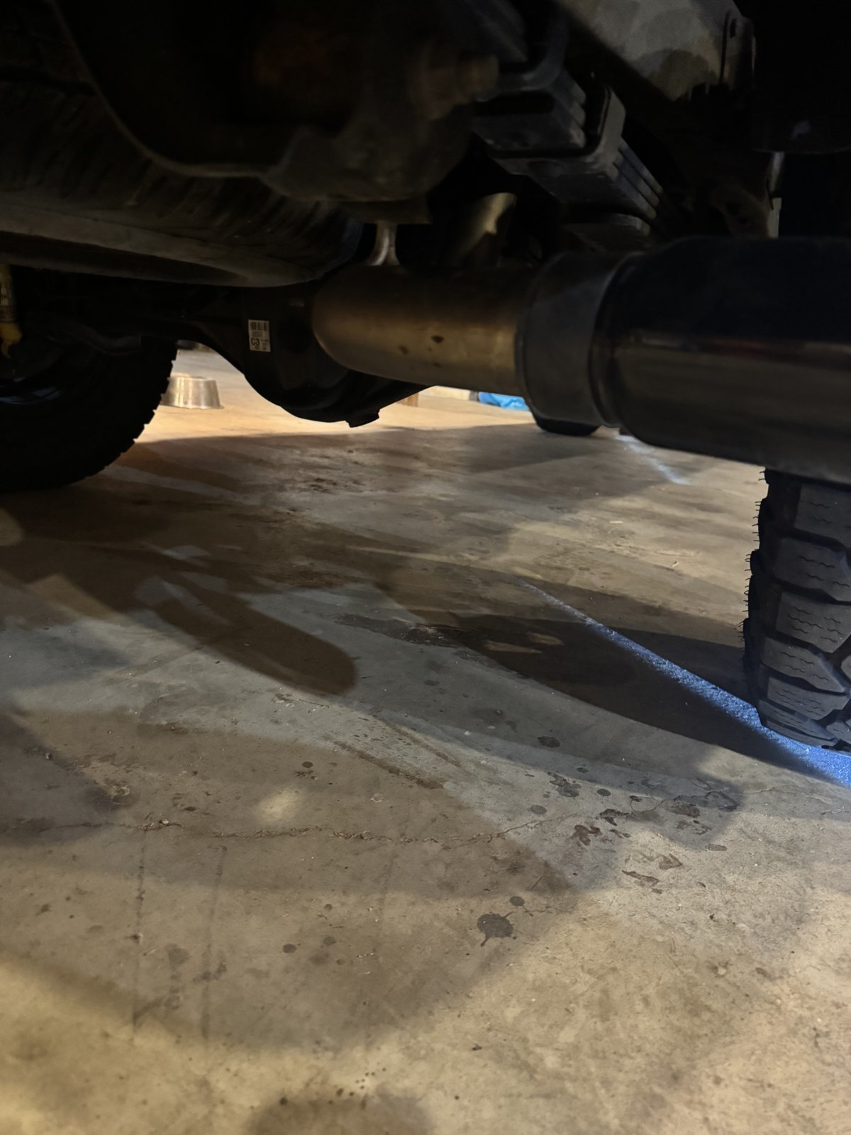

    Yes it works, a little work but nothing horrible. I was tired of waiting for the 2nd gen exhaust I ordered to arrive. So I picked up a nice take off locally for $100. Did this on my lunch break at work with a lift, it could be done in the ground though.

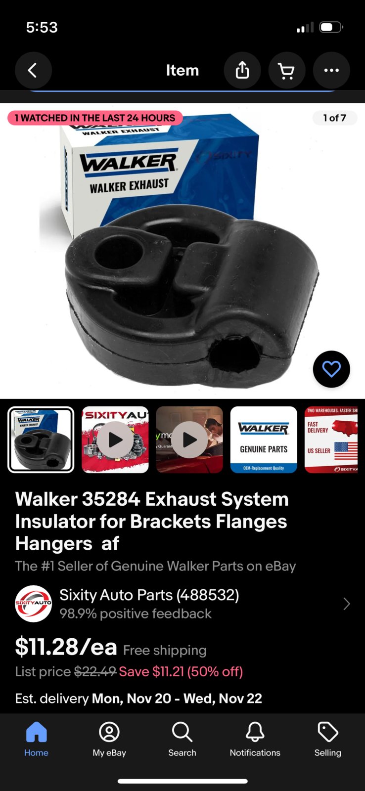

    Step 1 was to cut the factory exhaust off right where it straightens out and take the old muffler/tailpipe off. You will reuse all the rubber isolators except the rear most one. Replace it with this;

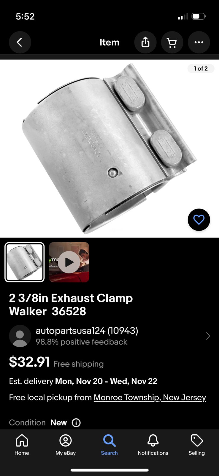

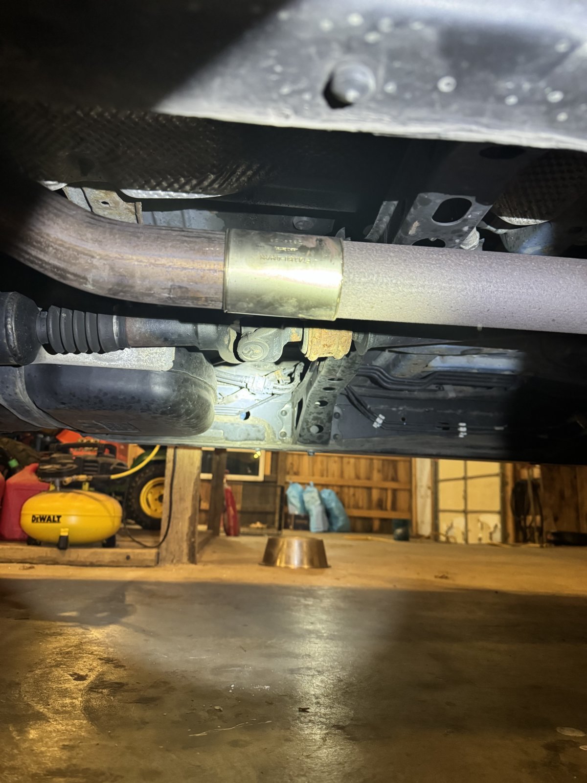

    Next cut the flange off your new 3rd gen exhaust, and mount the assembly onto the truck. Get it in place then mark and cut the original pipe leaving a half inch or so play for the clamp. Next use this clamp it’s the perfect size and much more heavy duty than the crap ones at chain auto stores.
    Next mount them together and tighten the clamp, add your tip and you’re done!

    Does it leak at the joint where the two pipes meet?

    Nope it’s a pretty heavy duty clamp, tightened it down with an impact and checked with it running. No signs of leaking. You could always weld it too.

    that clamp is what German cars come with.
    it helps when installing them to clean the surface, lube it, and anti size or exhaust paste the bolts and finish with hand feel or torque spec.
