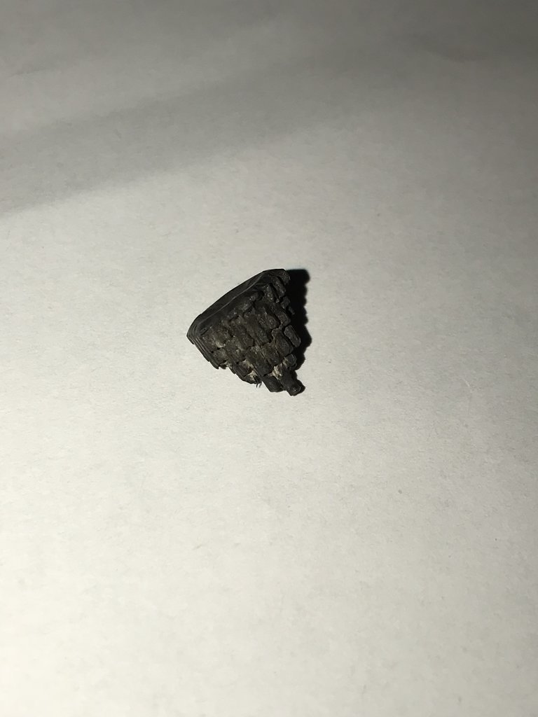

    Well, finally took it to Toyota to have the front body mount squeak addressed and asked them about this noise. And of course at first it was the usual we can get it to replicate the sound. So, after some discussion and pushing they were able to replicate. Tech looked and finally removed the passenger side exhaust section between the two converters and found this metallic piece below. Looks to maybe be part of the converter, any observations? It’s about 3/8 inch wide.

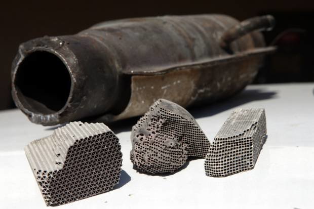

    Looks like a chunk of the substrate from a catalytic converter. They are known to blow these chunks out from time to time.

  11. Oct 15, 2017 at 6:50 AM

    My buddy had a piece like that turn sideways in his exhaust. The car ran like dog shit until we found and fixed it.

    To me, your photo looks like a small piece of substrate. Does it have the regular geometric pattern it looks like it has in your photo?

    This piece is very small about the size of a dime. It’s not of a honey comb shape where gas could pass through it. My truck only has 7k miles on it and no loud pop. It almost looks like some type of deburring tool or sorts.
