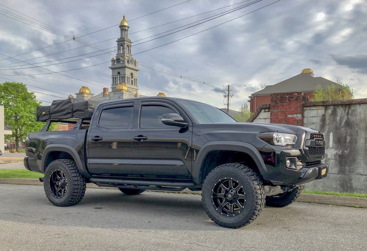

    So I just got these fuel wheels today, and on the front when they were putting the wheels on at the tire shop I noticed the lug nuts are only hitting like three or 4 threads. Makes me nervous, so I’m trying to find a good brand of longer studs to press in but I’m having trouble finding a good set. Sorry if this is already a thread I’m new on here and when I searched it nothing really came up. Thanks for any help!
