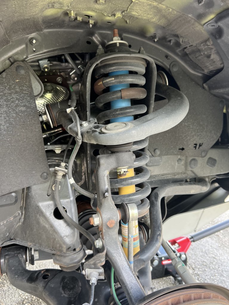

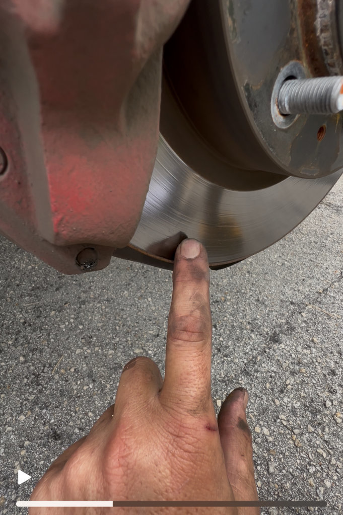

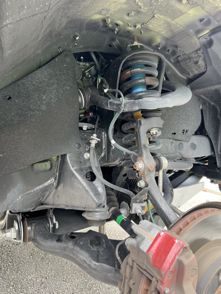

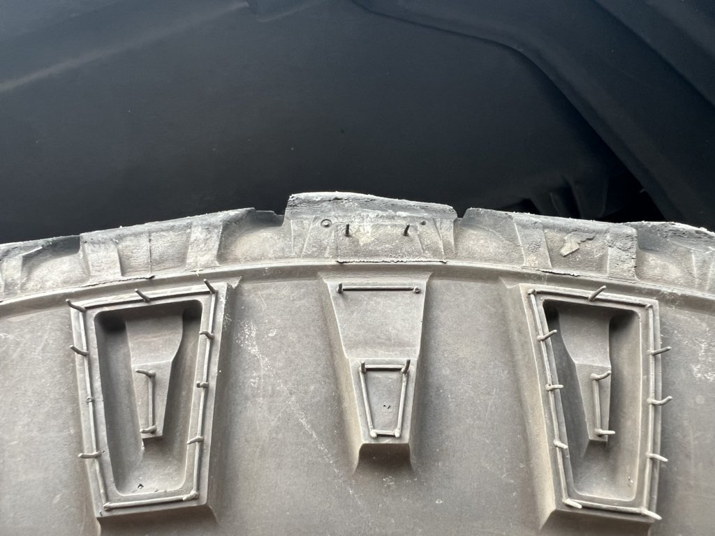

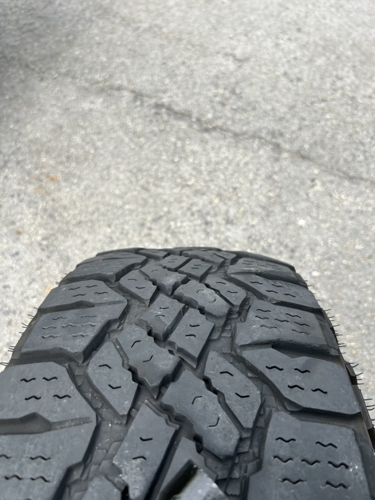

    Hey i’d be delighted if it was that easy! :) I’ll certainly give it a look but what I’m feeling is definitely something underneath, when the truck settles back. Doesn’t happen if I’m creeping along real slow at like 5 or 10 mph and then brake. I have to be showing down from at least about 30 mph to feel it. It’s right after the small rebound, when the truck returns to level.
    I know I was a little late in my tire rotation this interval :eek:, but I had noticed the tire wear and thought it might’ve been the way the m+s treads were designed… It wasn’t until a friend of mine who used to own a tire shop in Brazil mentioned to me that my tires were shot when he saw them.
    @MGMDesertTaco, yeah, I’m definitely guilty of going a little too long without rotating them this time around, but I’ll have to have somebody with the more knowledge to me check everything out. I mean, I’m in South Florida and the truck doesn’t get abused .. everything underneath pretty much still looks new, well, for a truck with 38,000 miles

    You gotta reverse rotate duratracs. I cross rotated them every oil change when I had them.
    Around 50% wear they are dreadful tires to own.
