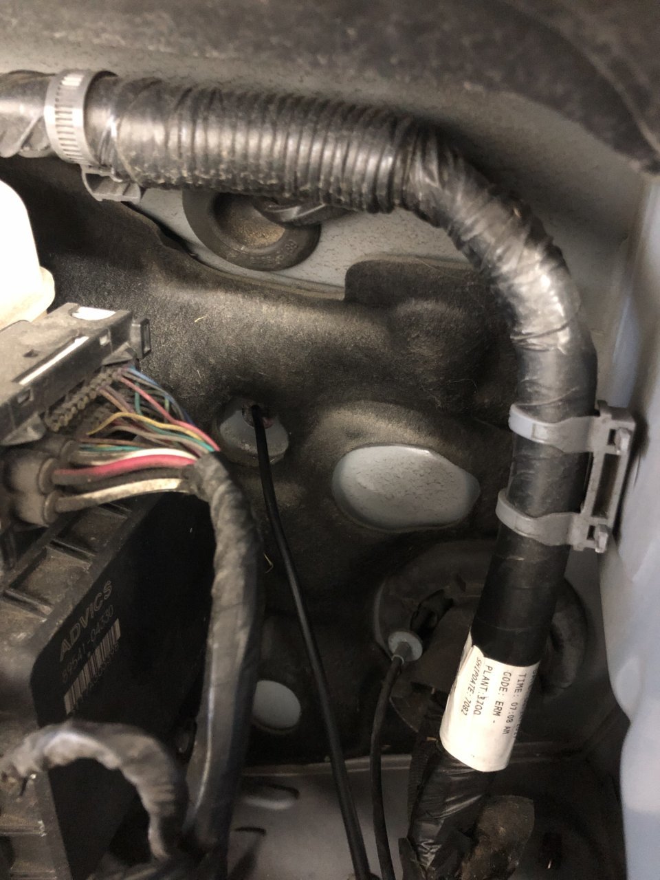

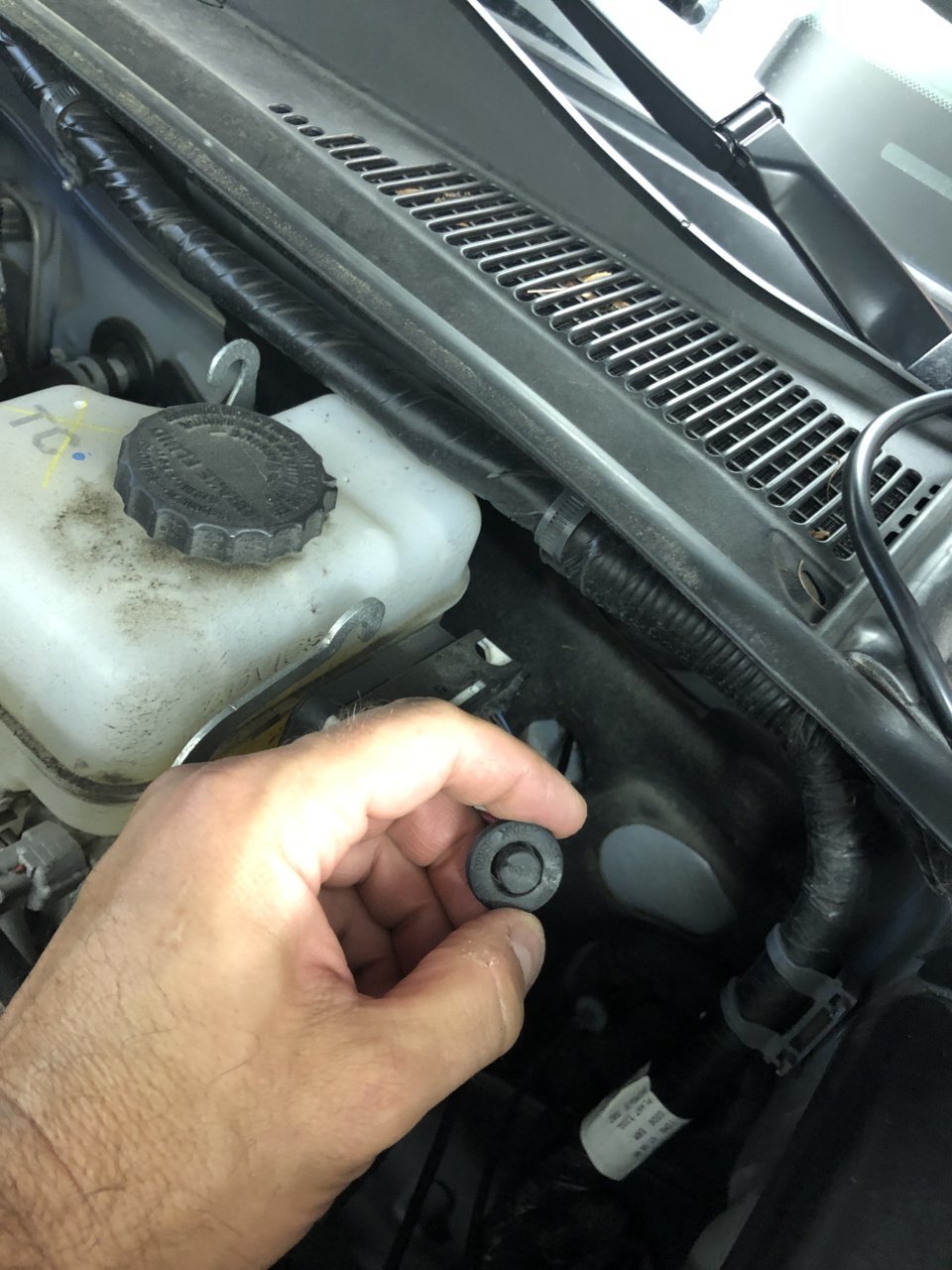

    Even better, you can stay away from the main loom. On the drivers side of the fire wall near the brake booster there is an unused rubber grommet, maybe an inch in diameter. Remove it, poke a hole in it, and run your wires through that.

    On the 2nd gens there should be at least one spare grommet in the firewall, more toward the passenger side. I assume thats the same in the 3rd gen. If your cable isn't huge, it might be better to go that route

    353DEC86-18B0-46FE-AE5E-826F5A2EA1D8.jpg EECDC7E7-4FCC-4FCD-B4F8-E6D122B69361.jpg
    There a spot to the left of the wire loom. I took out the plug, drilled the plug and then cut a small hole in the carpet on the other side. I ran the wire through the plug and put it back in place. Worked great for my ditch lights.
