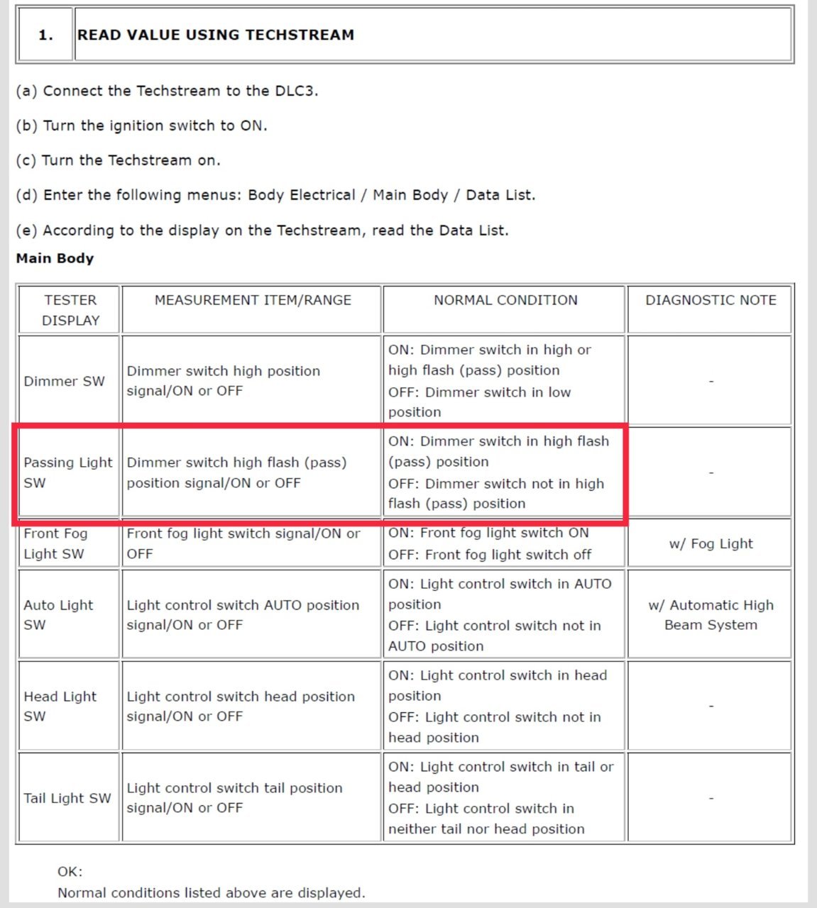

    My reasons for starting the thread were exactly what I stated. And if it's my choice of words "flash to pass" that has you all butt hurt, then take your fight up with Toyota. Here is there wording in their service manual and why I chose such offensive wording:
