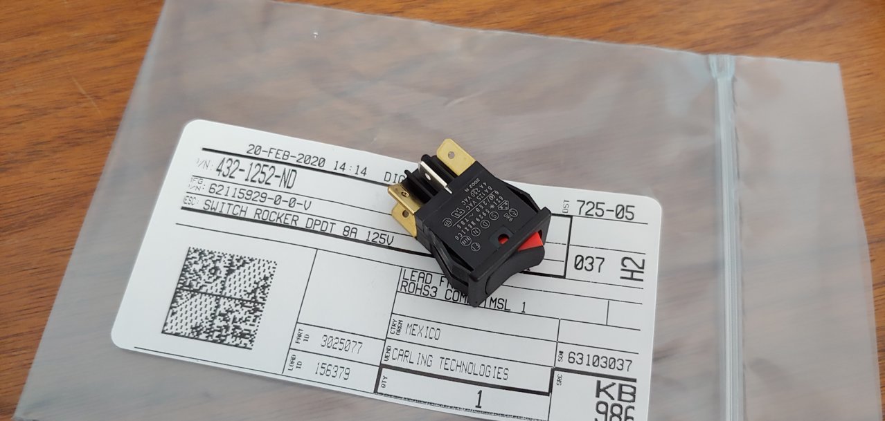

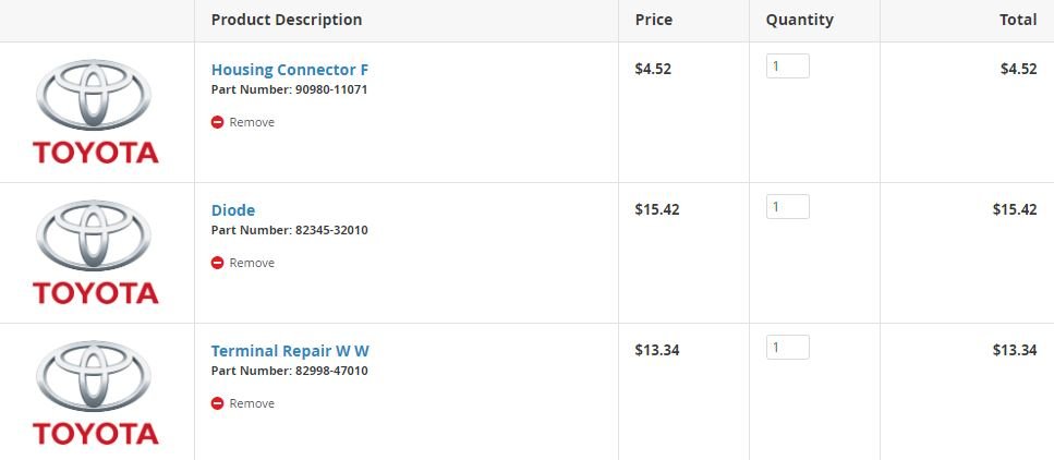

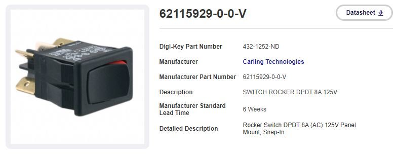

    Need to order supplies. The open barrel female terminals, 3-slot diode connector, DPDT mini switch, and diode. I have everything else. I'm going to go shopping with your part numbers tonight. Thanks again for everything. I'll take some pics to share along the way.

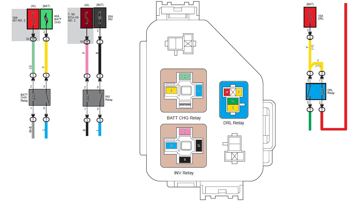

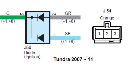

    I can tell you now that the choice tap is due to proximity, but if you leave the fog switch ON, you'll get an illumination of the lamps when the vehicle does it's fuel pump check.
    The one I use is in the side relay box, (2 choices there): 10A IG1 No. 2 is the Battery Charger IGN supply and 7.5A ECU_IG No.2 for the Inverter Relay. A little work to get the small wire from the side relay box into the main relay/fuse box,. Just follow the harness out then into...

    Why is it bad for the lights to come on when the truck does its fuel pump check? It only does that when i'm starting the engine, correct? What am I not considering?
    I'm okay with extra work just want to understand. I assume this behavior is exclusive to IGN-MAIN and not the other two relays you mentioned in the side relay box.

    It'll spook anyone not knowing why the fog lights are on after a few hours have passed. It's related to a pump check the truck does.
    And you are correct that the other locations do not behave like the circuit mentioned.

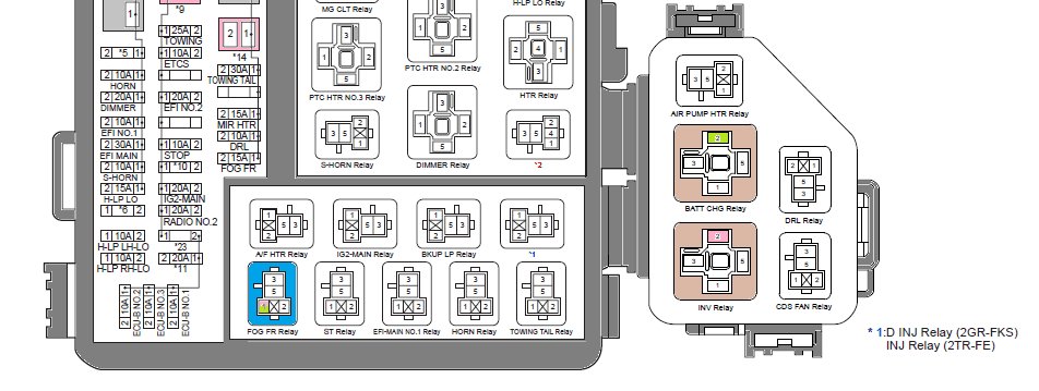

    So FOG FR Relay pin 1 to BATT CHG Relay pin 2 lime or INV Relay pin 2 pink? Dealers choice

    That is correct...:thumbsup:

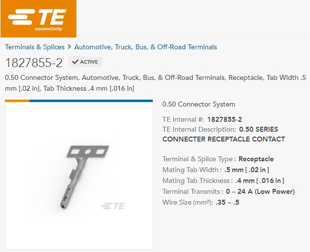

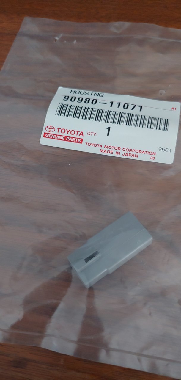

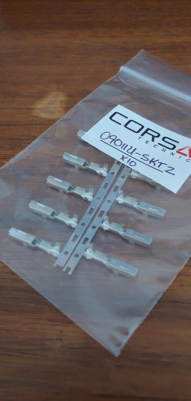

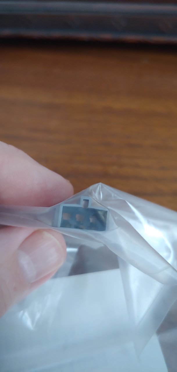

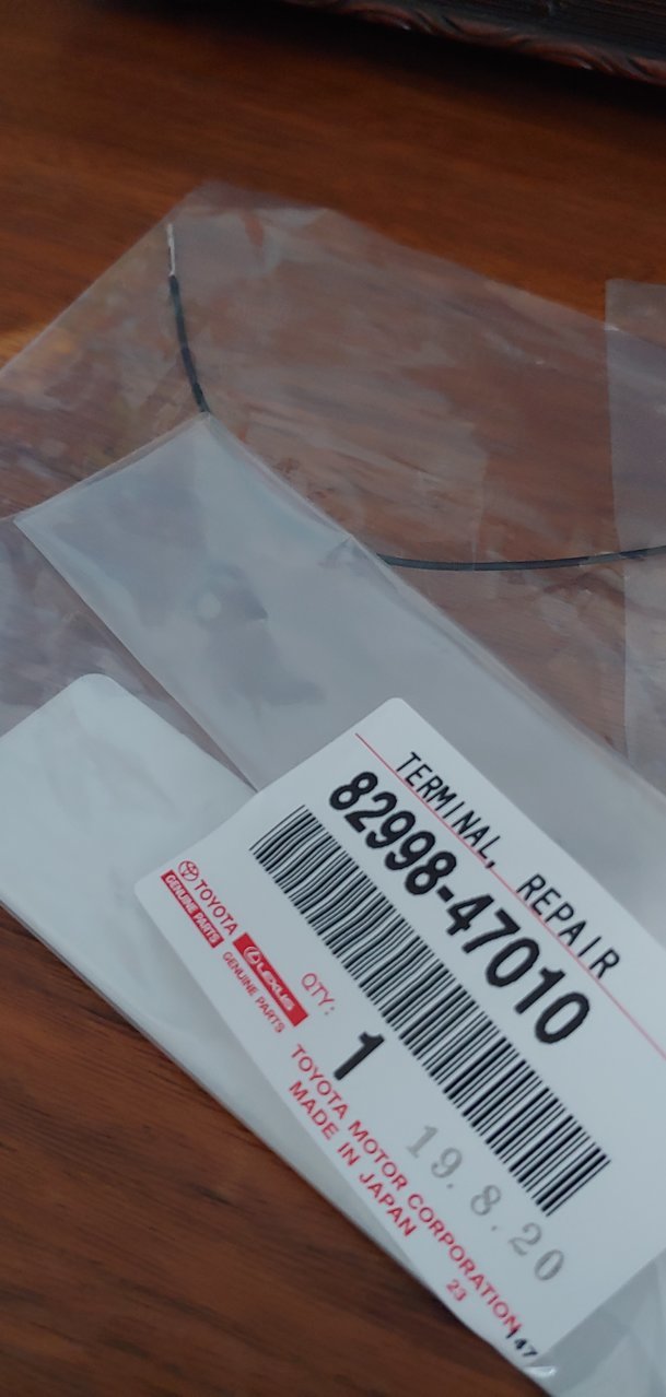

    Can you point me in the right direction for the female molex 090/2.3ii jacks going into the diode connector 90980-11071?

  11. Feb 20, 2020 at 8:33 AM
    #51
    caribe makaira
    caribe makaira [OP] Well-Known Member
    Feb 13, 2011
    #51121
    11,809
    Caribbean, Puerto Rico
    05 PreRunner TRD Offroad AutoTrans
    Hood Struts, My version Fogs always ON, Map & Overhead Light Mod,
    This is the terminal that inserts into the M6 connector slot 26 (blue wire)
    But I suggest the repair wire, less of a chore.

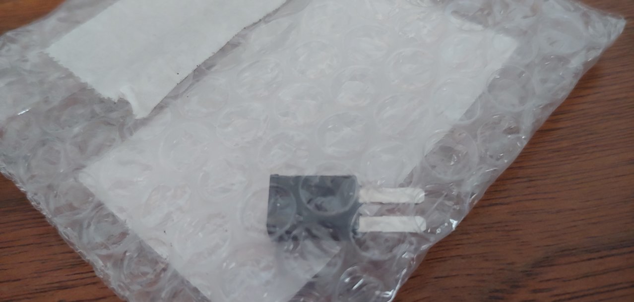

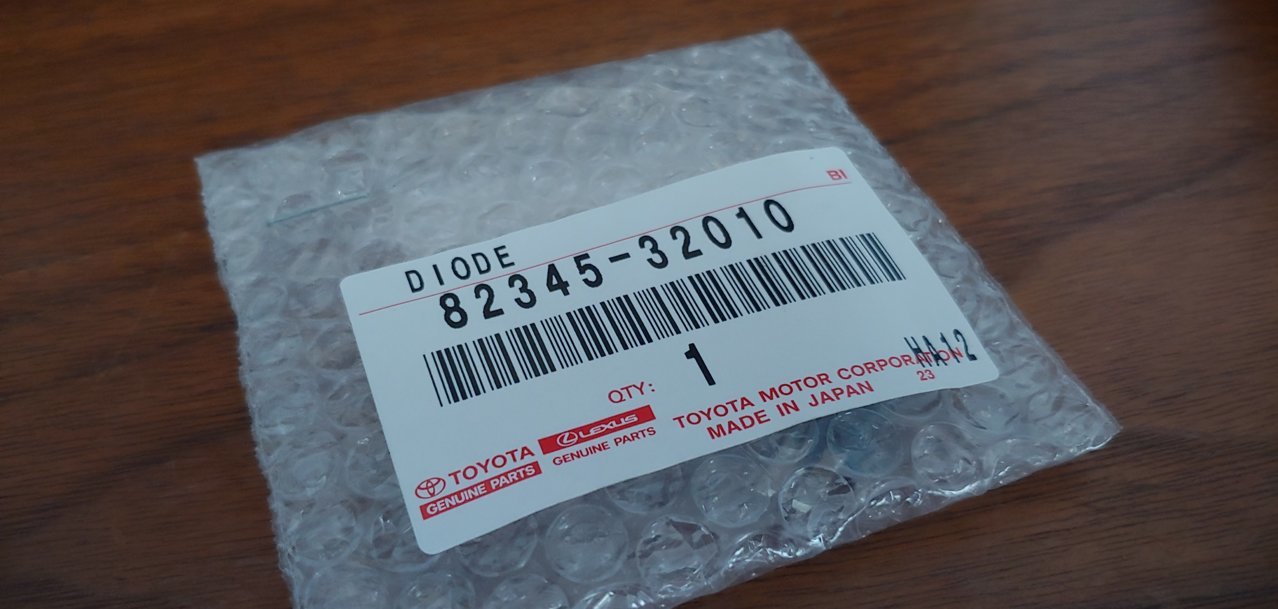

    Diode doesn't look as expected. Does it look right to you @caribe makaira?
  15. Feb 25, 2020 at 2:05 PM
    #55
    caribe makaira
    Feb 13, 2011
    #51121
    11,809

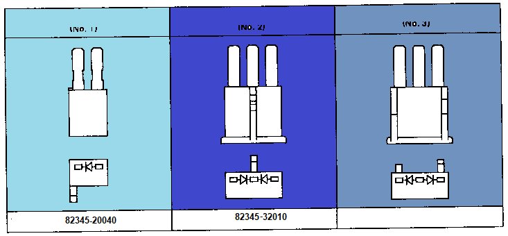

    I'm afraid the diode is not the one needed. I verified the part #.
    Maybe they made a mistake when they packaged it....
    I used the HONDA one, it's made by Sumitomo and it was $9.00...

    Honda 2 way diode...

    That sucks. I'll call them tomorrow and see what they say. Thanks

    Show them the picture of the various Toyota diodes...

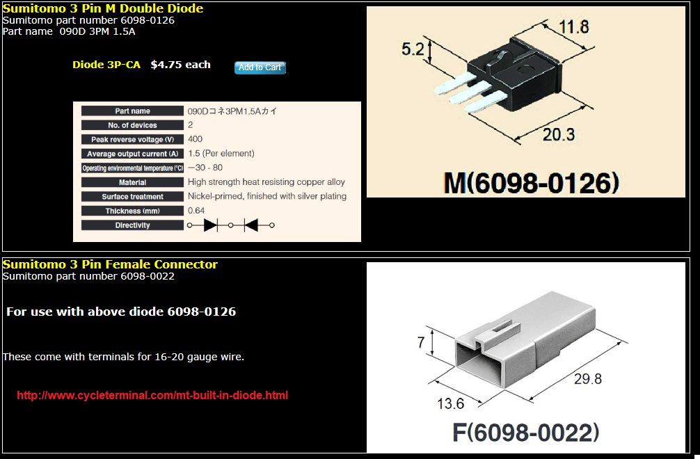

  19. Feb 26, 2020 at 8:45 PM
    #59
    caribe makaira
    Feb 13, 2011
    #51121
    11,809
    Another source for a 3 way diode and its connector:
