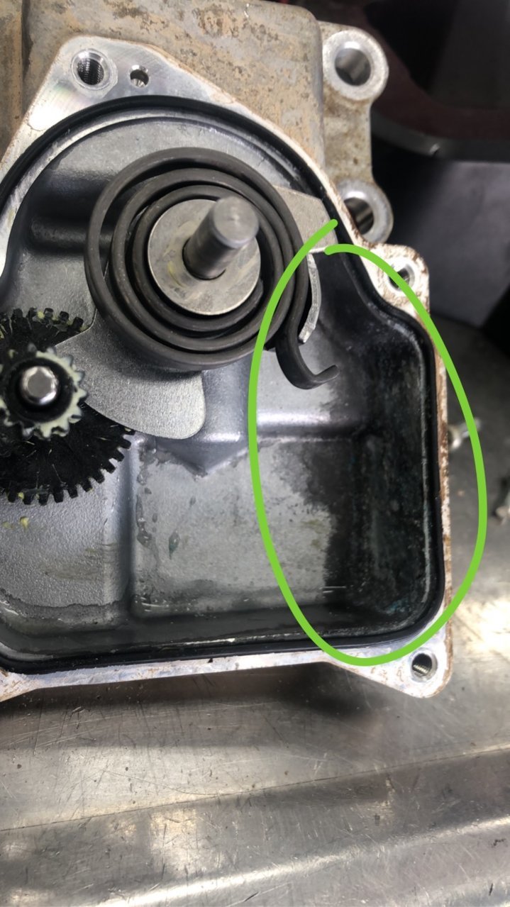

    So did you ever fix your issue?

    Yes it was fixed a week later. I was lucky it disengaged out of 4 wheel drive for my trip home. I will see if i have the pics still of the actuator opened up.

    That was right after you pulled it? Looks like it had been wet before.

    Dealer told me the same the diff had to come out. I bought a new actuator and had it installed by a local mechanic for $300 labor. Diff did not come out. He had a lift that made it easier to deal with getting the old one out and new one in. He did say it was really tight but with some patience he got done.

    That was 2 days after going across the stream. Never saw water before that crossing. I was shocked how bad it did look.

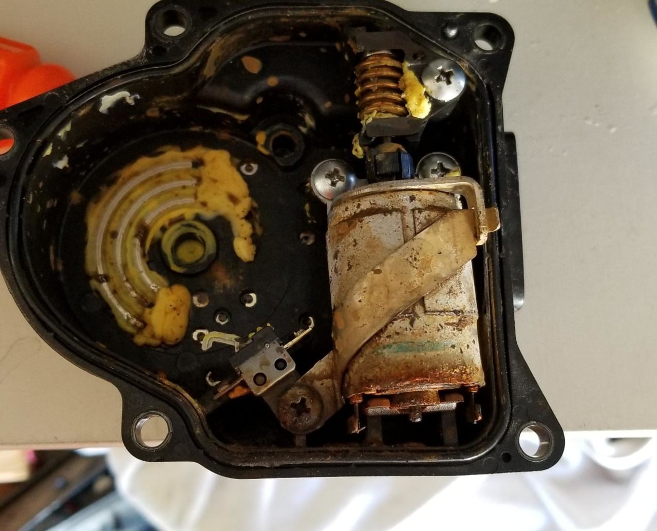

    The same exact thing happened to me. Water got into the ADD and it shorted out. They replaced it under warranty and told me they would not do it for free again. Then they tried to explain how the system is water proof but you can’t submerged it.
    It seems that the ADD is a week point in the system.

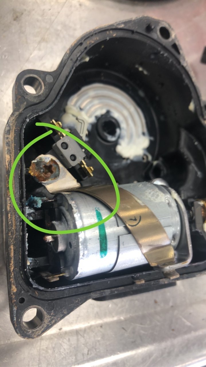

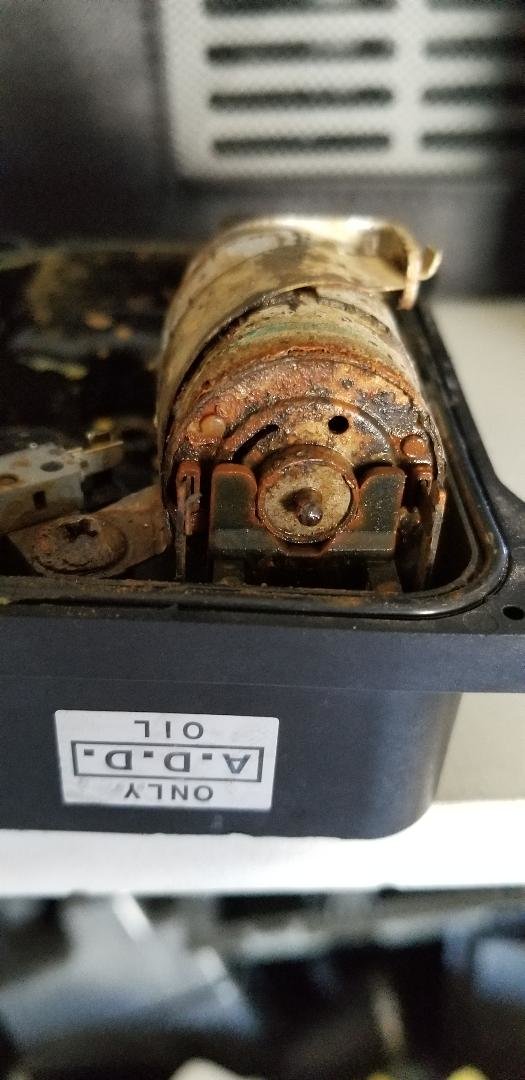

    Yikes. Yours was really bad. Mine wasn't that bad but still failed. The sucky part was, I was on a trip during winter and woke up to a bunch of snow and I was stuck. Had to dig the truck out.

    That doesn't look half as bad as mine! I was on a trip up near Bishop in July 2019.

    My failure happened instantly. As soon as I crossed the water, the system failed. It's the little contact on the motor that failed. In the 2nd picture you can see it. $40,000 truck and this happens.
