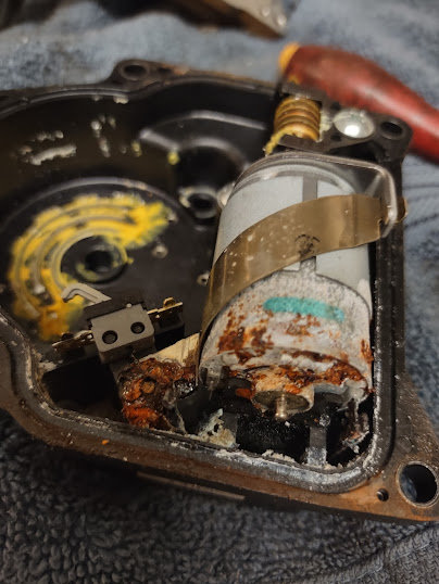

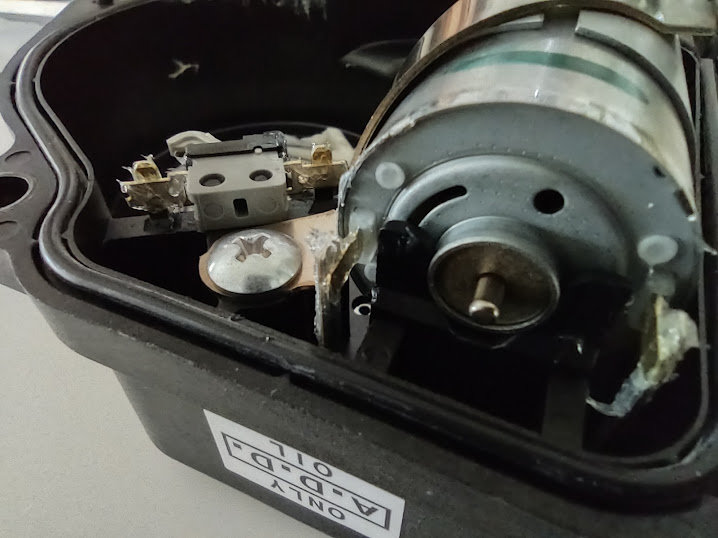

    Had the same problem with water getting in the actuator.
    Replaced with AISIN SAT-017 OE Replacement (link below)
    https://www.amazon.com/dp/B076C2KQS3
    I took the new one apart and the connections were spot tacked on the motor and other connection.
    I applied some dielectric grease to prevent corrosion and reassembled.
    Installed in the truck and 4x4 is working great.
    I would reccomend that if you still have the stock actuator to solder the contacts and check the breather hose.
    The stock breather hose is known to let water in and is what caused my problems.
