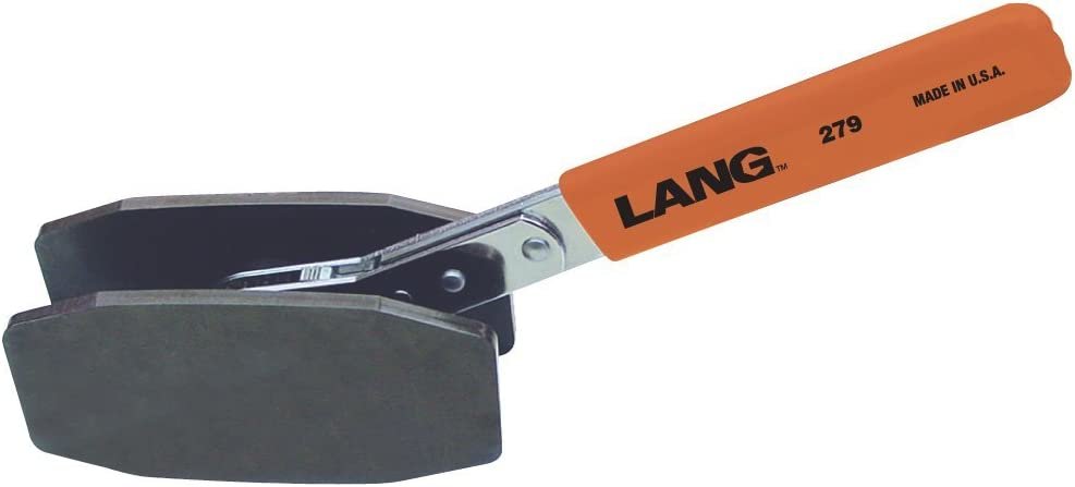

    Doing a job is always a good excuse to buy tools. This one will compress all four pistons nice and smooth all at once.
    Big tall dave and JmsWms like this.

    Don't forget to grab an 8mm bolt I believe to pop the rotor from the hub. I just did my pads and rotors the other day and had no issues.
    I do have the caliper spreader shown above, but ended up using the 2 screwdriver trick. Also I opened the bleeder to let the pressure out instead of forcing it back through the expensive system. I ended up gravity draining about half my brake fluid doing it this way.
