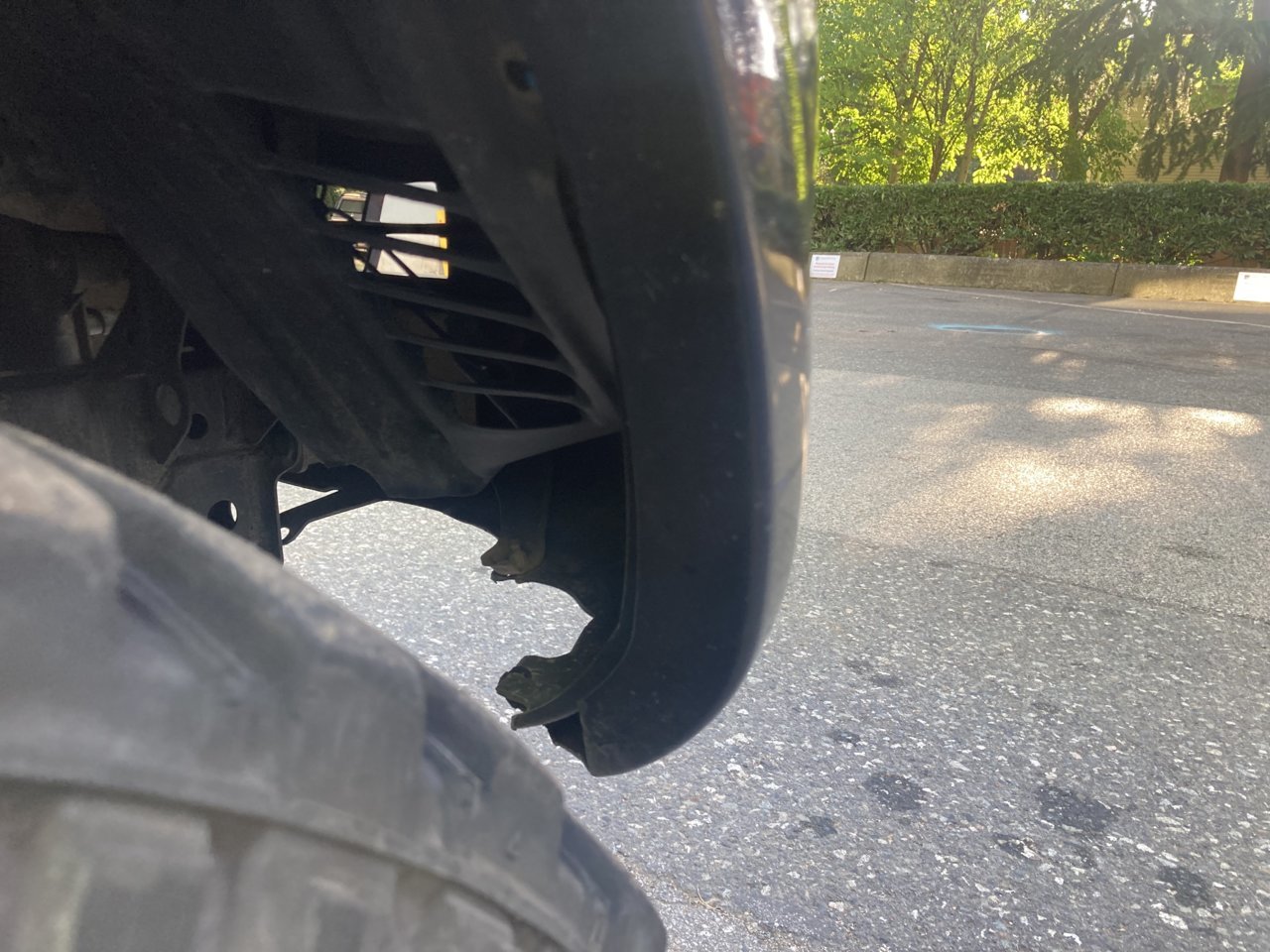

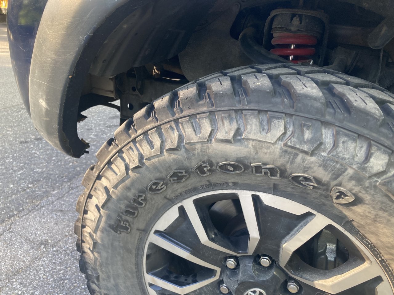

    Tall and Skinny tires.
    I have 285/75/17 for off-road.
    You need to trim the front fender liner on passenger and driver side.
    and delete your mud flaps. See photo.
    They will fit with no steel chopping or aggressive surgery.
    Don’t do what I did, and zip tie the plastic liner more forward. Just chop/trim it off. It will save you grief if and when the zip tie breaks.

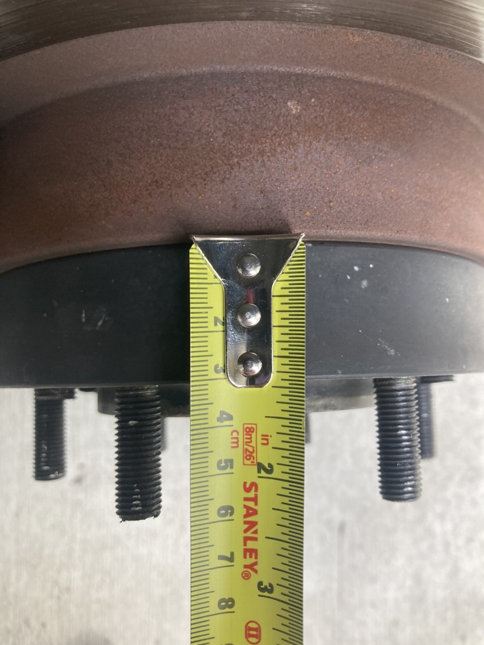

    From what iv read my wheels are 3rd gen wheels with 25mm offset 7 inches wide. What wheels and offset are you running? Spacers or no? Seems as if most people are running spacers on toyota wheels to save from hitting the uca.

    Spacers are a good way to weaken the connection between the wheel and hub. Fine for a mall crawler, but ill advised for any serious off-roading.

    The truck wont see any serious off roading. However it is my daughter's daily drive. Thats why im leaning toward 265/75r16 and no spacers. When i do tear into it the truck is getting new breaks, and ball joints if needed. I believe im gonna stick with 1.5 rear 2 in the front.

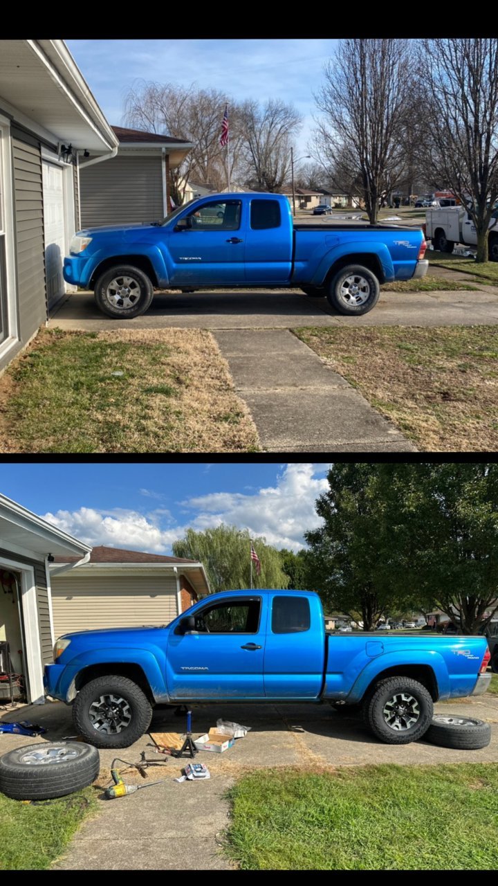

    Here is the before and after. Falken wildpeak at3 265/75r16. 5100s on the second setting from the bottom. I believe since the springs we used were from a crew cab we got more lift in the front than expected. On the test drive the truck rode great. Have not installed the icon progresive aal yet. Going to have her drive it for a week or 2 and see if the front settles in some.

    Looks great, I ran those wheels on mine for a while. Such a difference.
