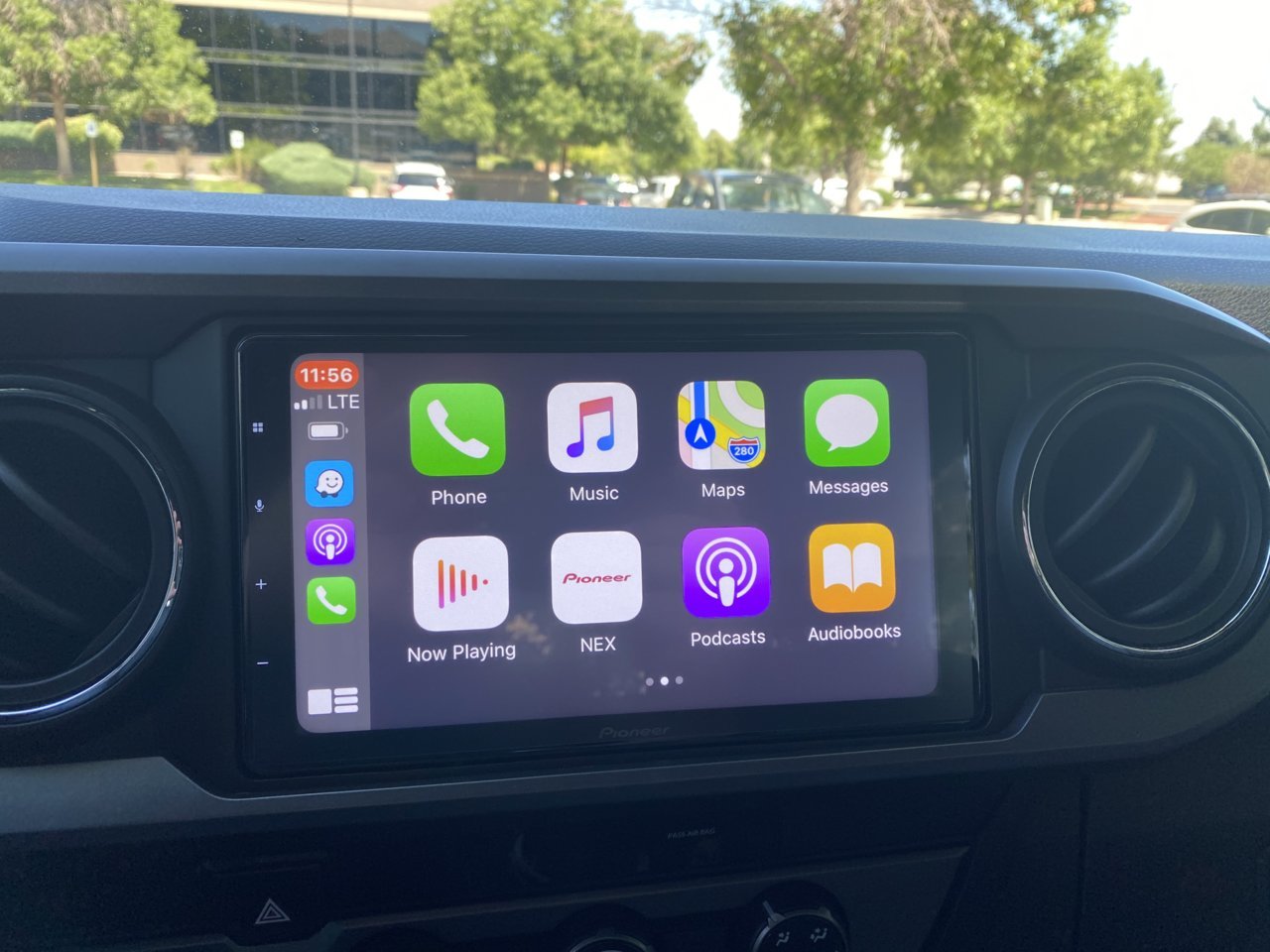

    I just upgraded mine to the Pioneer DMH-WC6600NEX. Fits flush with a little bit of work and fits the premium bezel perfectly. The only functionality that I lost was the compass and the turn by turn directions on the screen above the steering wheel but your going to lose those with any aftermarket headunit. I still have the compass in my mirror and being able to use Waze and Google maps on a big beautiful screen make you forget about losing those in a hurry.D8DEC2C9-6407-4897-833B-D6813A7B3CDA.jpg

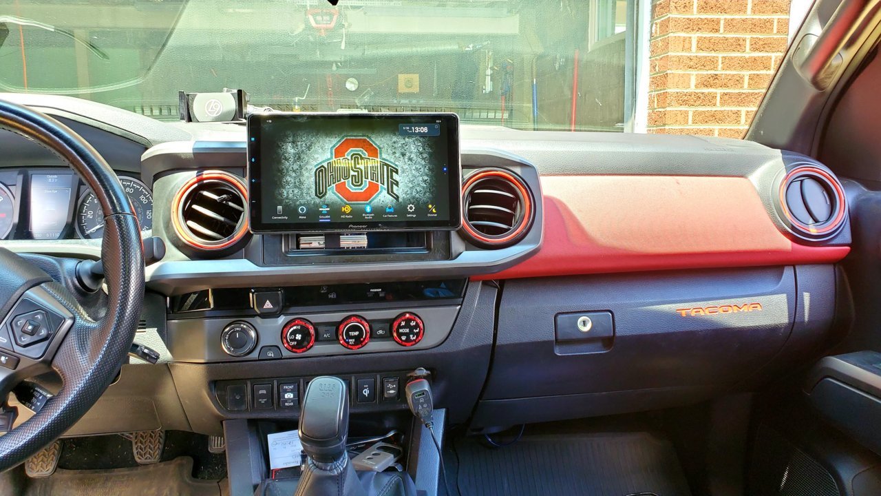

    I have the Pioneer DMH-WT8600NEX with the 10.1" screen. Like the last guy said, I only lost in dash compass and turn by turn. I kept everything else with the Maestro RR. 20200729_165004.jpg
