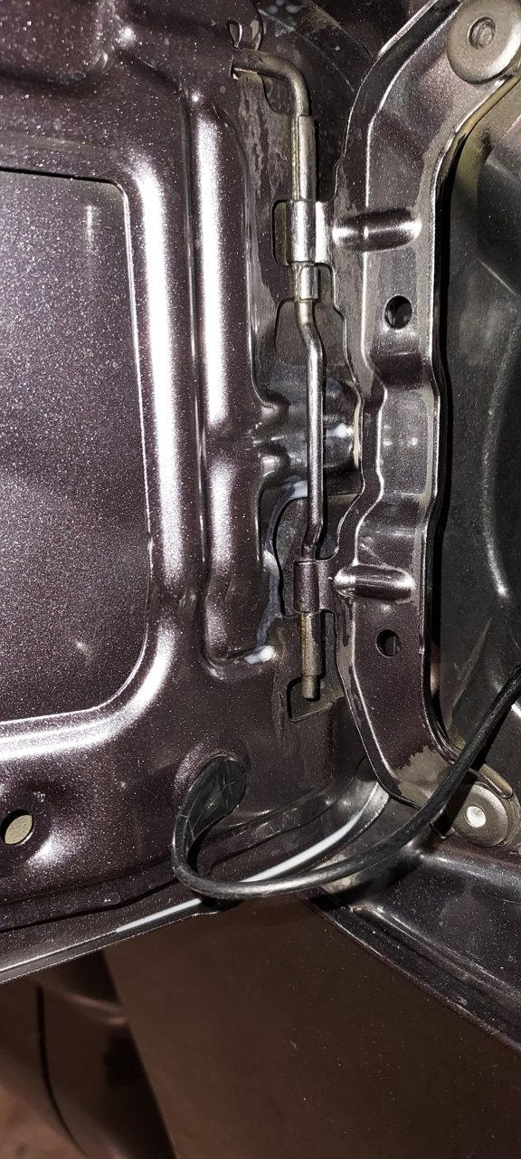

    Here's mine for comparison.
    Lt. Dangle[QUOTED] likes this.
