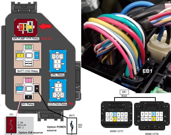

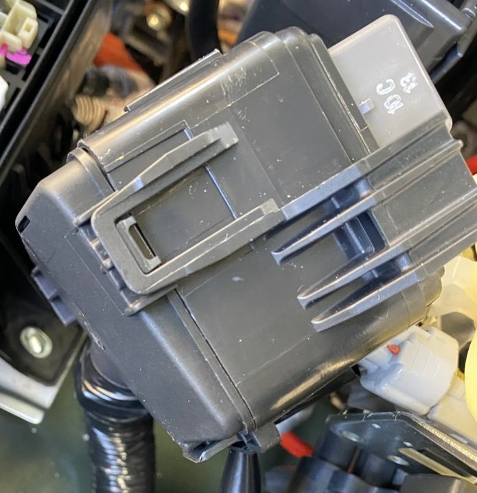

    Hood Struts, My version Fogs always ON, Map & Overhead Light Mod,
    Aux relay box comes off by pulling straight up.
    It has a removable bottom lid.
    Photo @hcenteno21
    Use 2.8 mm male terminals (or your choice) to wedge between the relay terminal and the slot. Use mini zip ties or tape on the added wires to the selected wires to be tapped, so the are not displaced.
    Route the wires following the wire bundle, or your personal preference.
    Since there are a few China versions of the lamps, test with the smallest fuse. I wouldn't pass over a 5A. (four LED's) smaller for fewer LED's.

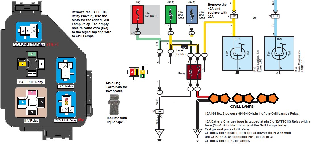

    Another way:

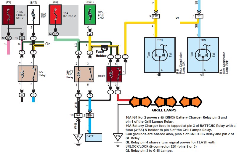

    Wish I could understand these diagrams.
