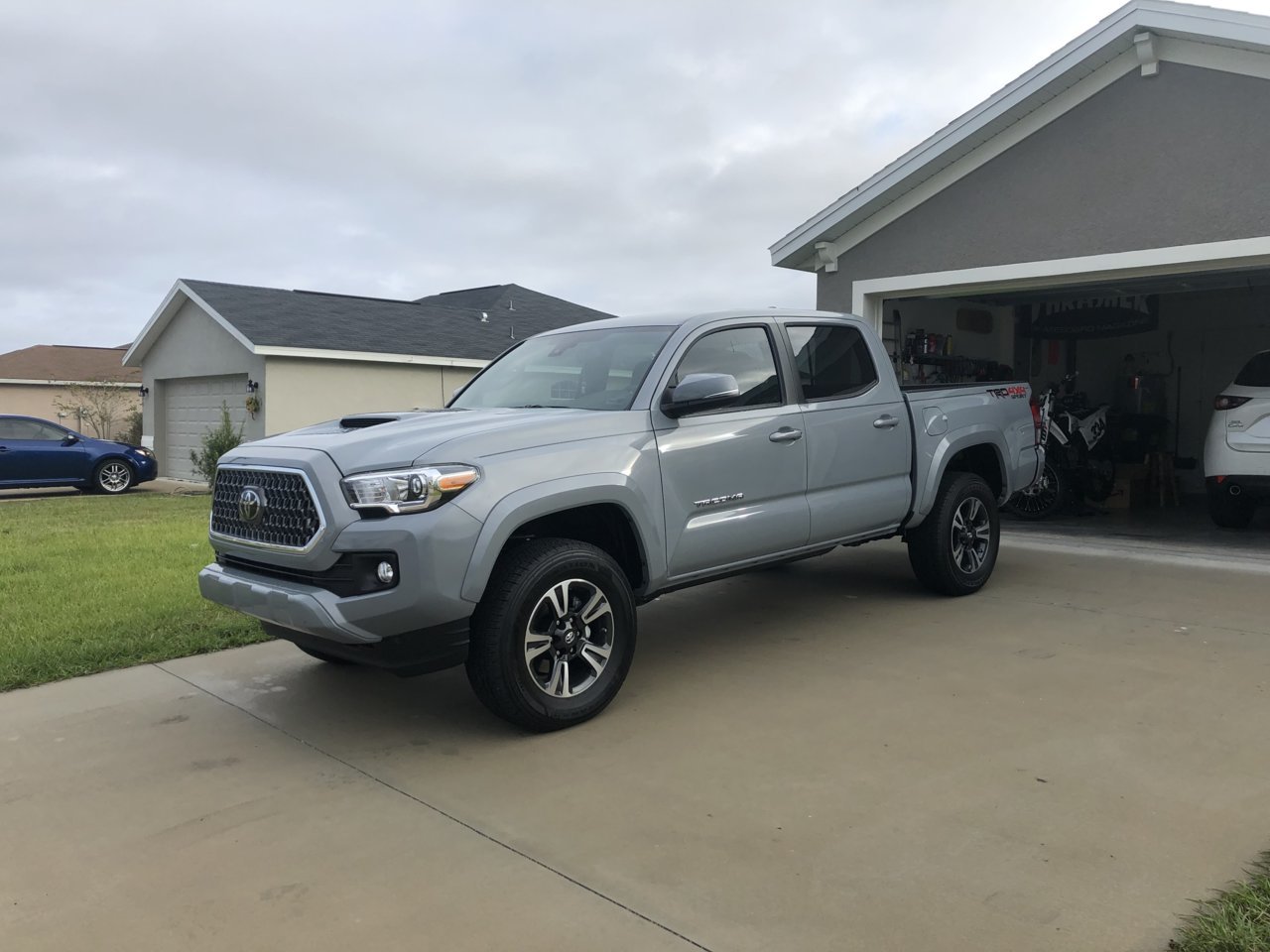

    hey everyone. New to the forum. Just traded in my second gen and got a 2019 trd sport, cement gray. I’ve seen a couple of ppl do it I think but wondering if the 3rd gen TRD Pro grills mount right up to replace my sport gril. If not why do I need to do. Thanks. 6AB75C58-27B9-44B3-9A1F-3D12C312D39A.jpg

    Quite a few YouTube videos of the install. 2 clips and 2 bolts to remove the whole thing. Unhook the TSS RADAR. Remove a bunch of screws to get the bezel off. Then a bunch of frustration pushing out an interminable number of clips.
    Push the new grill in until it clicks then reinstall the sensor. Don’t forget to get the $80 cover piece (garnish) to cover it.

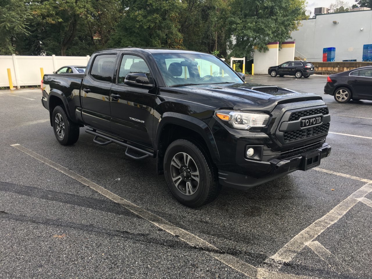

    Ee-zee Pe-zee Taco Squeez-ee... took me 25 min.

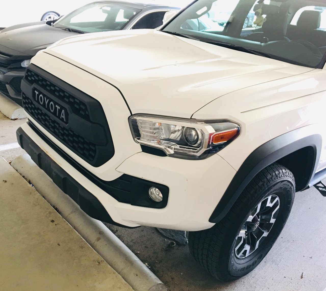

    TRD Pro Grill Auxbeam LED Headlights
