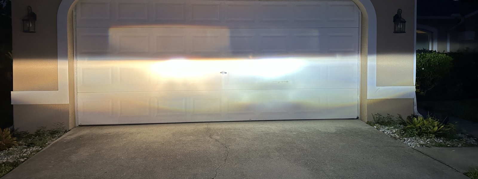

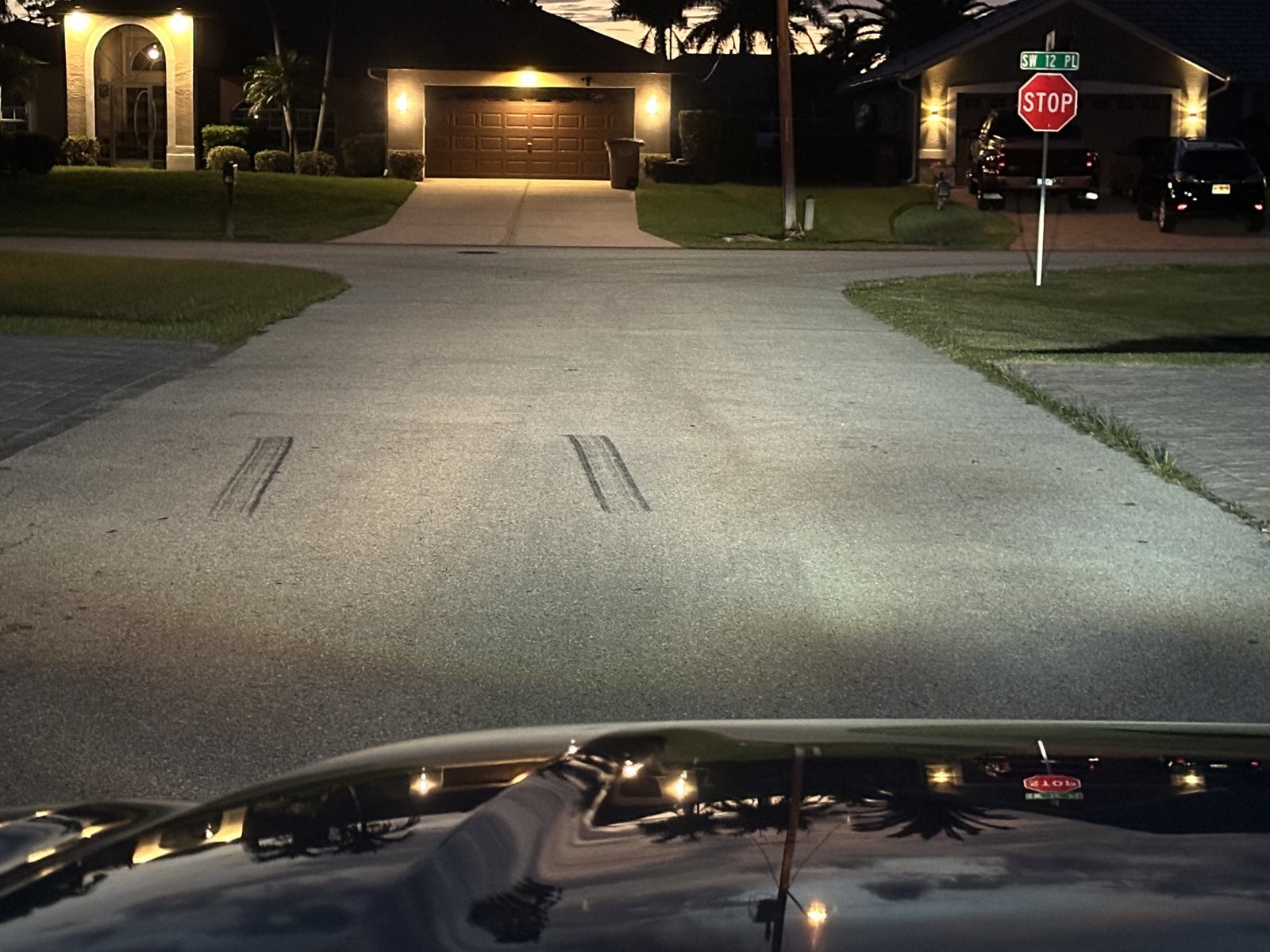

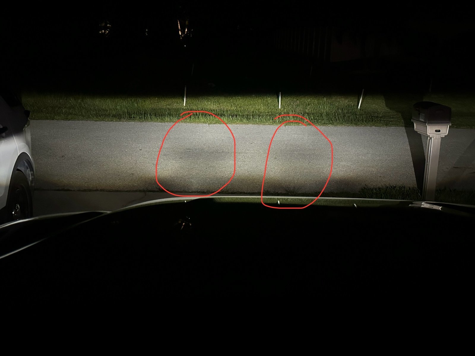

    So as I’ve been reading about how LED’s aren’t really designed to be in Halogen housings, but the rave about how bright they are, I took the chance and bought some of the recommend auto one LED bulbs for the H11 low beams. I put them in and took a drive at night. I didn’t really notice they were really any bright than the factory Halogen Osrams.
    One thing I did notice and which is truly the reason why I returned them and ended up getting the Osram night breaker, is a strange dark spot that the LEDs produced seen below.
    I could not stand that strange pattern. So I went ahead and installed one of the night breakers to compare. Night breaker left and LED right.
    Again. Night breaker left and LED right. Notice the difference in the dark spot / void.
    Needless to say. I kept the NightBreaker +200 and the LEDs are gone.

    Since the plug and play LED bulbs only have emitters at 3 and 9 o'clock they do not accurately replicate the 360 degree output of a halogen and will result in those spots as well as far less "uplight" to illuminate overhead signs.

    "Reflector" assemblies ... take light from all directions as halogens make and focus it. LEDs make light in specific directions but not all directions ... your "dark spot".
    Buy H9 bulbs to replace the H11 low-beam, or buy the OEM LED assemblies and the harnesses from daveeasa or Puppypunter.
    Read the first post in this ... the man explains why LEDs do not belong in halogen assemblies: https://www.tacomaworld.com/threads/3rd-gen-hid-vs-led-vs-halogen-h11-projector-headlights.589465/

    Nope. It would make a bigger mess as the emitters are very far apart putting it way out of focus. I'd suggest reading the big headlight thread on here. You'll learn a lot.
    You're better off with a decent HID kit like Morimoto in the projectors but they can cause excessive uplight that may blind other drivers. I've got an HID kit in my stock projectors but would like to go with OEM LED housings eventually.
