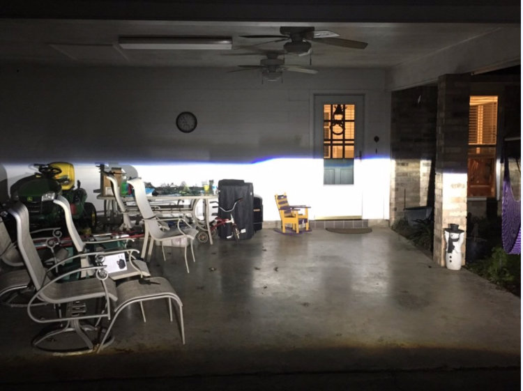

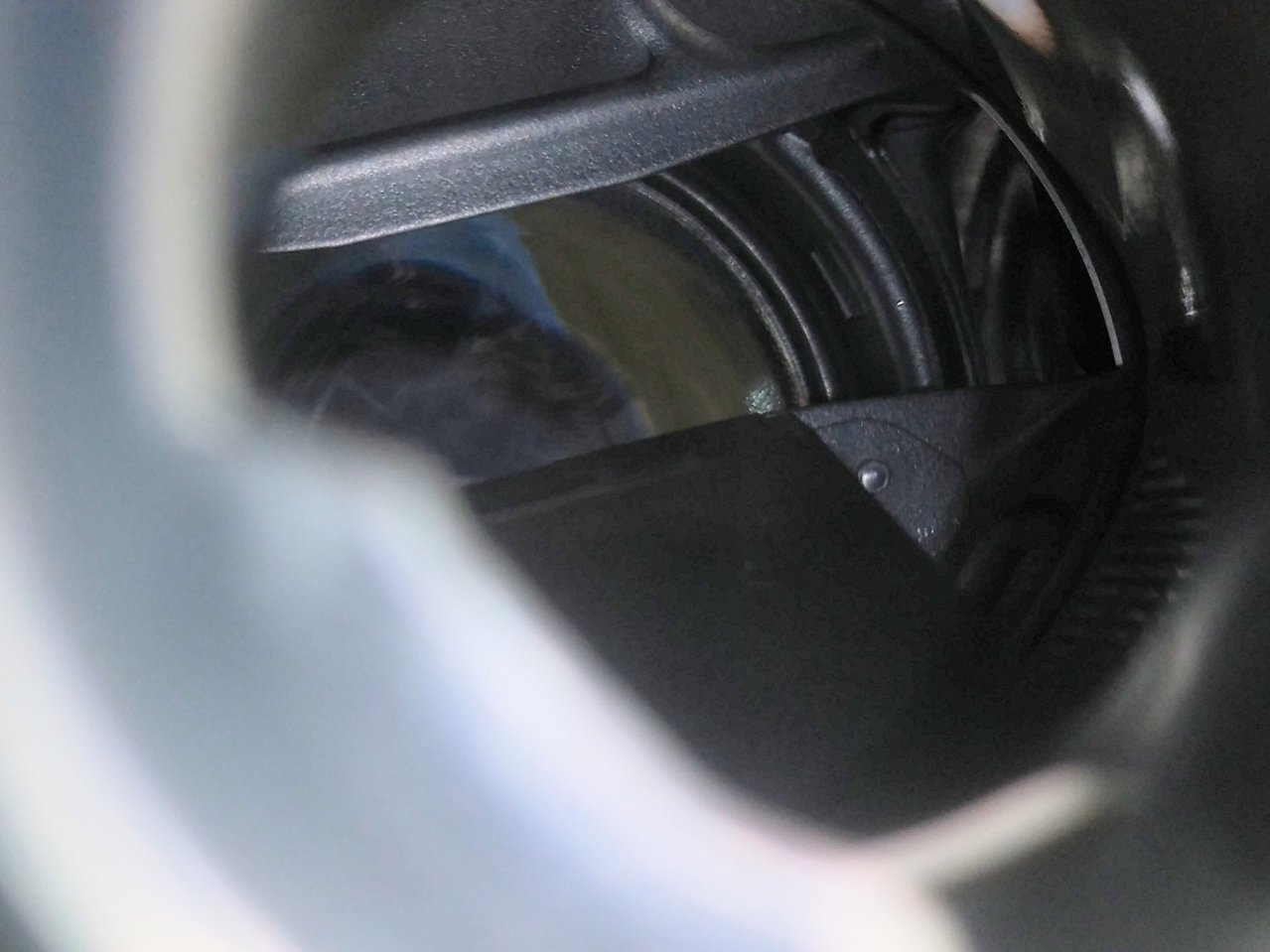

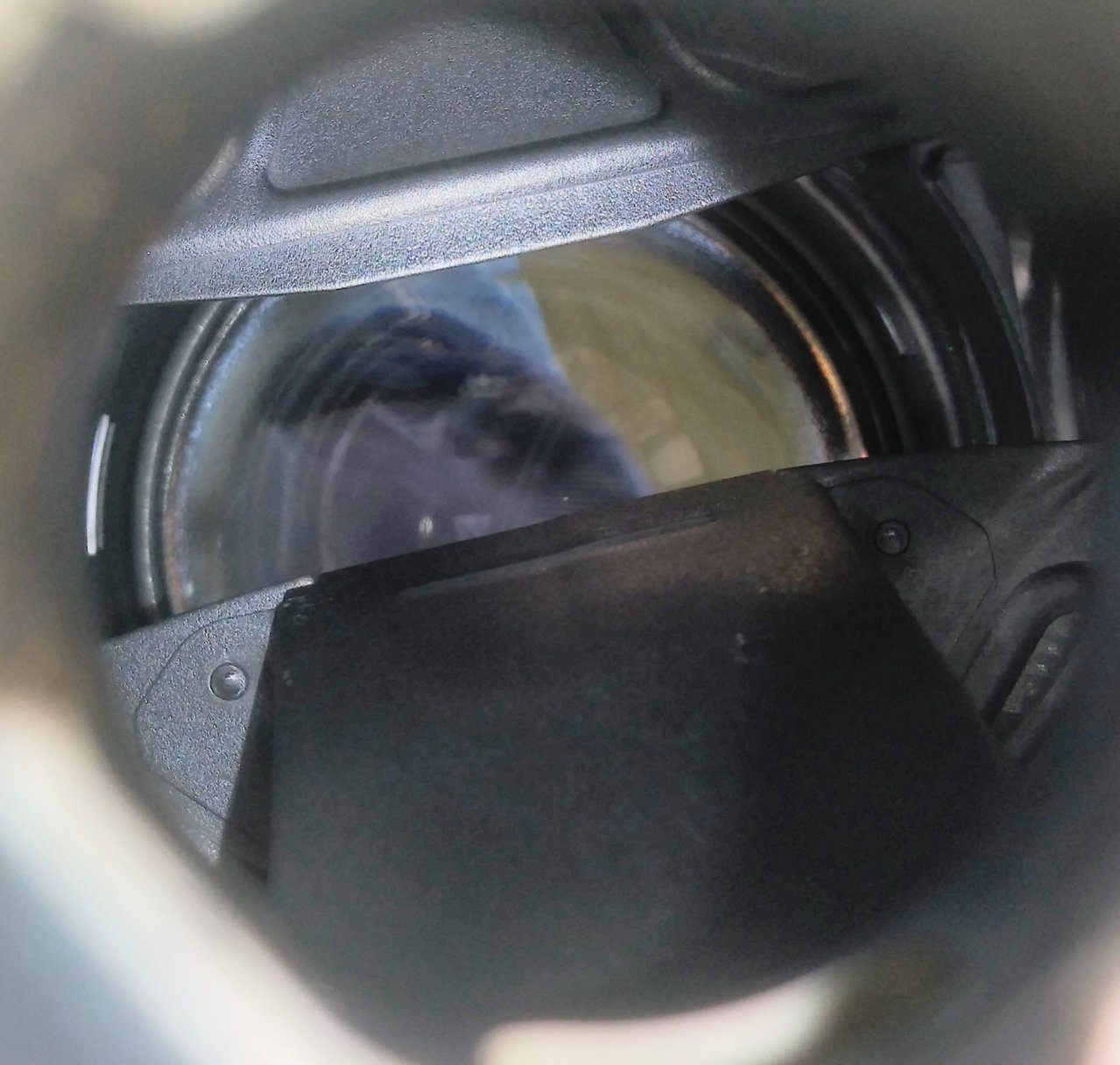

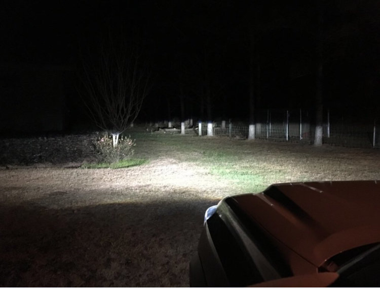

    recently got a lesson on projector lenses. (look @ pic) you can put a led bulb in projector. but they work best if the led is adjustable. i have led bulbs that the leds are side to side. the one i bought there all in one side. and i clocked the leds to point up once installed. and got better output than side to side. seems tacoma projectors are closed on top and bottom so not to blind oncoming drivers.
    the top shield seems to be shorter than bottom shield.
    in other words top seems to stick out less than bottom one goes out further into projector.....
    thats why (imo) HIDS work so well no clocking needed.....
