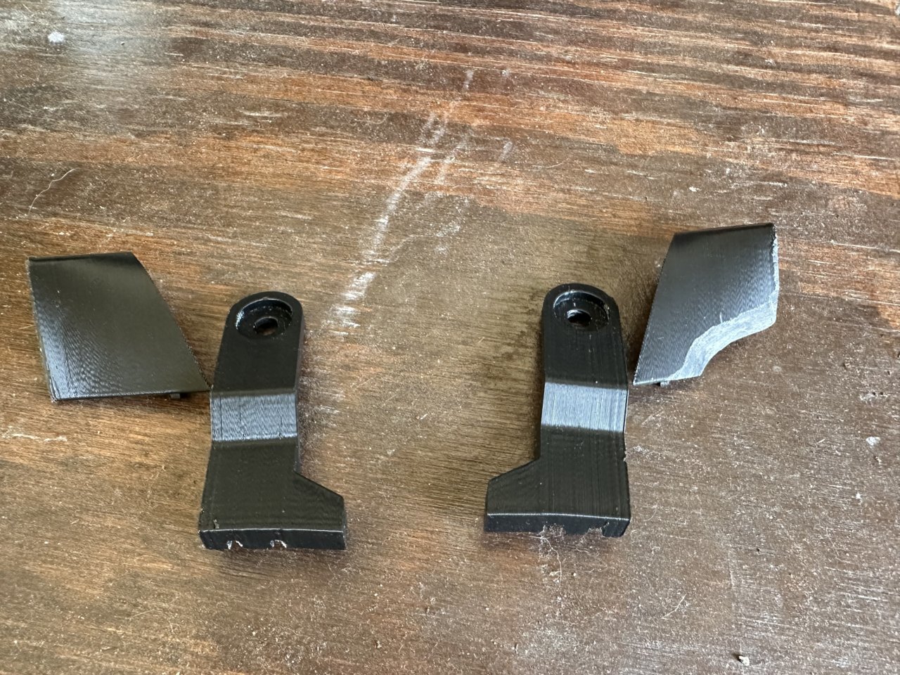

    Tell me about it. That alone took 5 hours to print and its 85% hollow, doing a set is going to be most of a day.
    Thankfully this part does not need to be solid, actually 3D printing is better IMO as you can create "solids" that are air inside, unlike traditional manufacturing that has to use thin features with support ribs. I would argue that this part, with only 1.5 walls and 85% empty space, is stronger than the OEM piece.

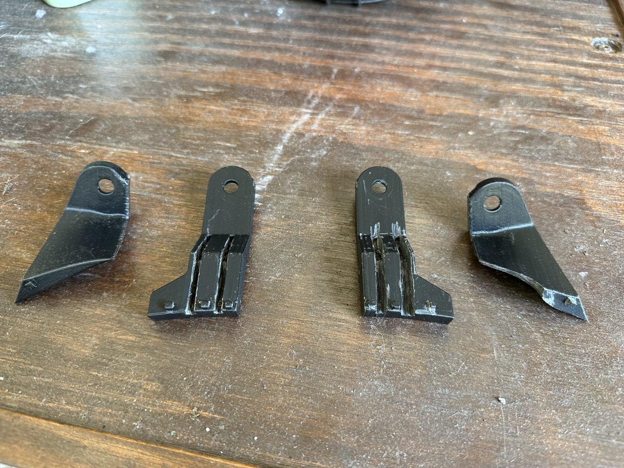

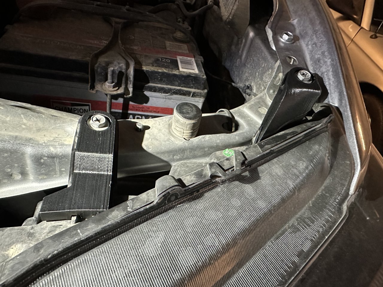

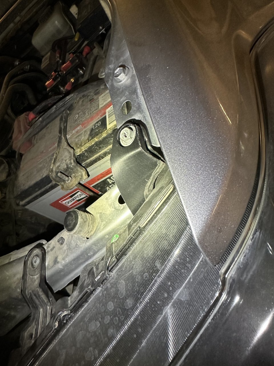

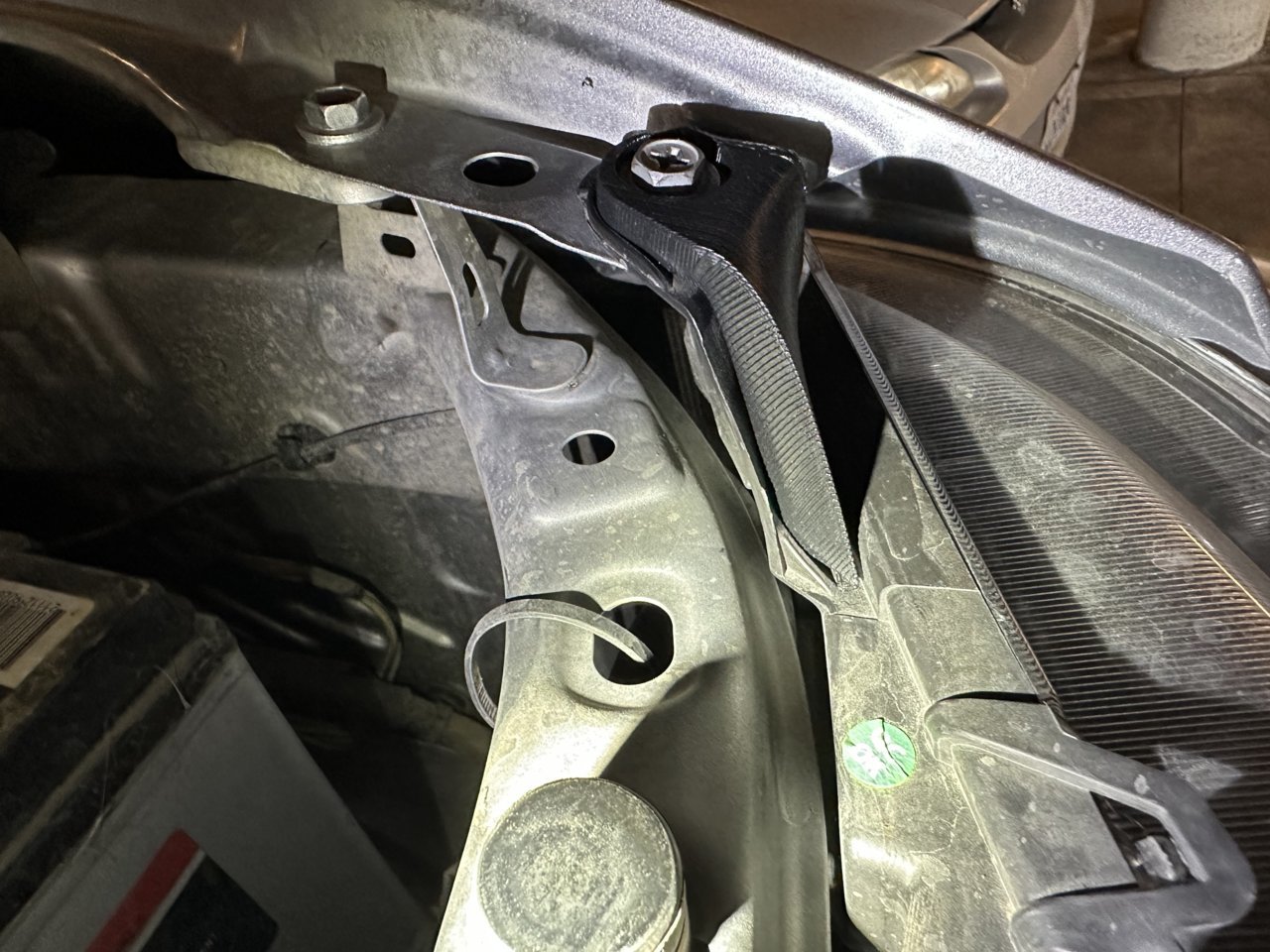

    @Firn was kind enough to send me some tabs to test out on my morimotos. They did require a bit of modification to get to fit, but overall a cool product that will give me a little more peace of mind with my investment into these aftermarket headlights.
    see description and images of modifications below:
    - had to widen out the channels on the inboard tab as the ribs on the morimotos must not be in the same location as OEM
    - had to trim some of the little plastic nubs on the inboard and outboard tabs since they didn’t line up with the holes on my housings
    -had to trim one corner of the outboard tab and taper it.
    - the only spot that really didn’t line up is the outside edge of the outboard tab. In the pics you can see a slight gap since the angles in the tab don’t match the housing. Epoxy should fill that in no problem.
    this was all easy enough to do with a blade and dremel as the material is easy to work with.
