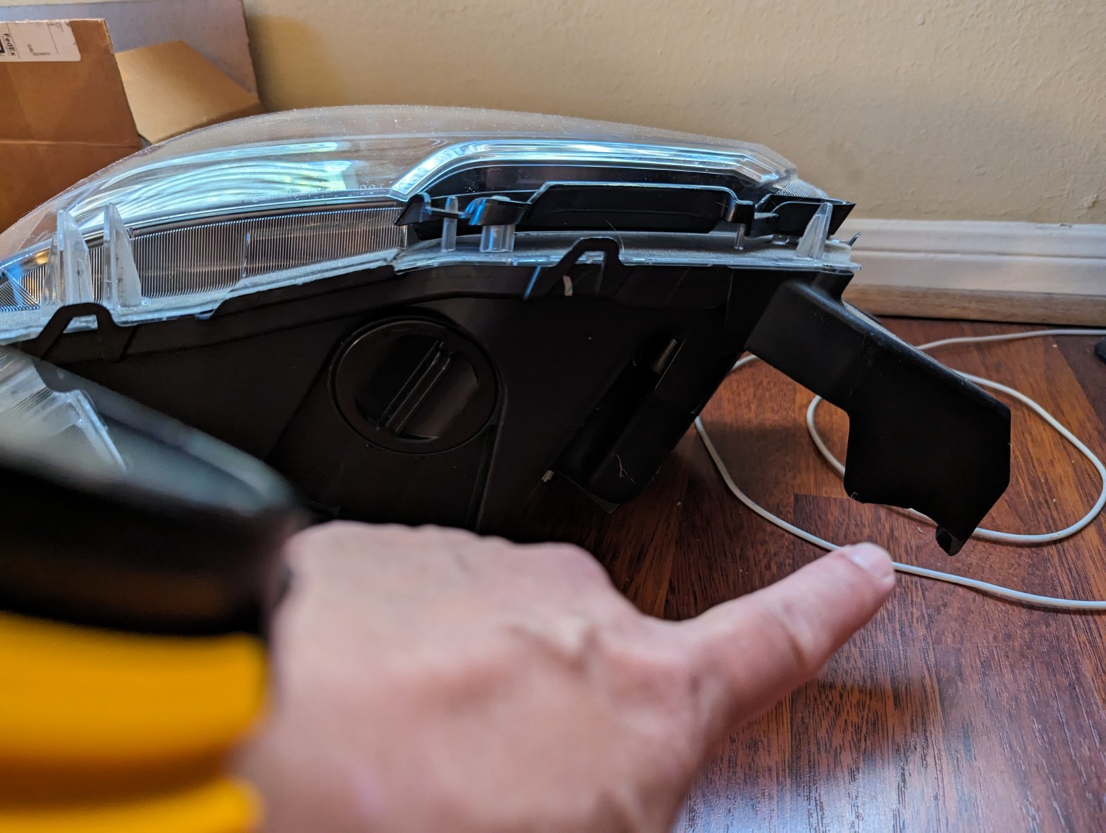

    Hey boss. I was scrolling through the forum and noticed you made every single tab except for the one that's broken on mine. It's the inner most tab closest to the grille with the square hole. 2023 LED light. Let me know if you've already made them plz!

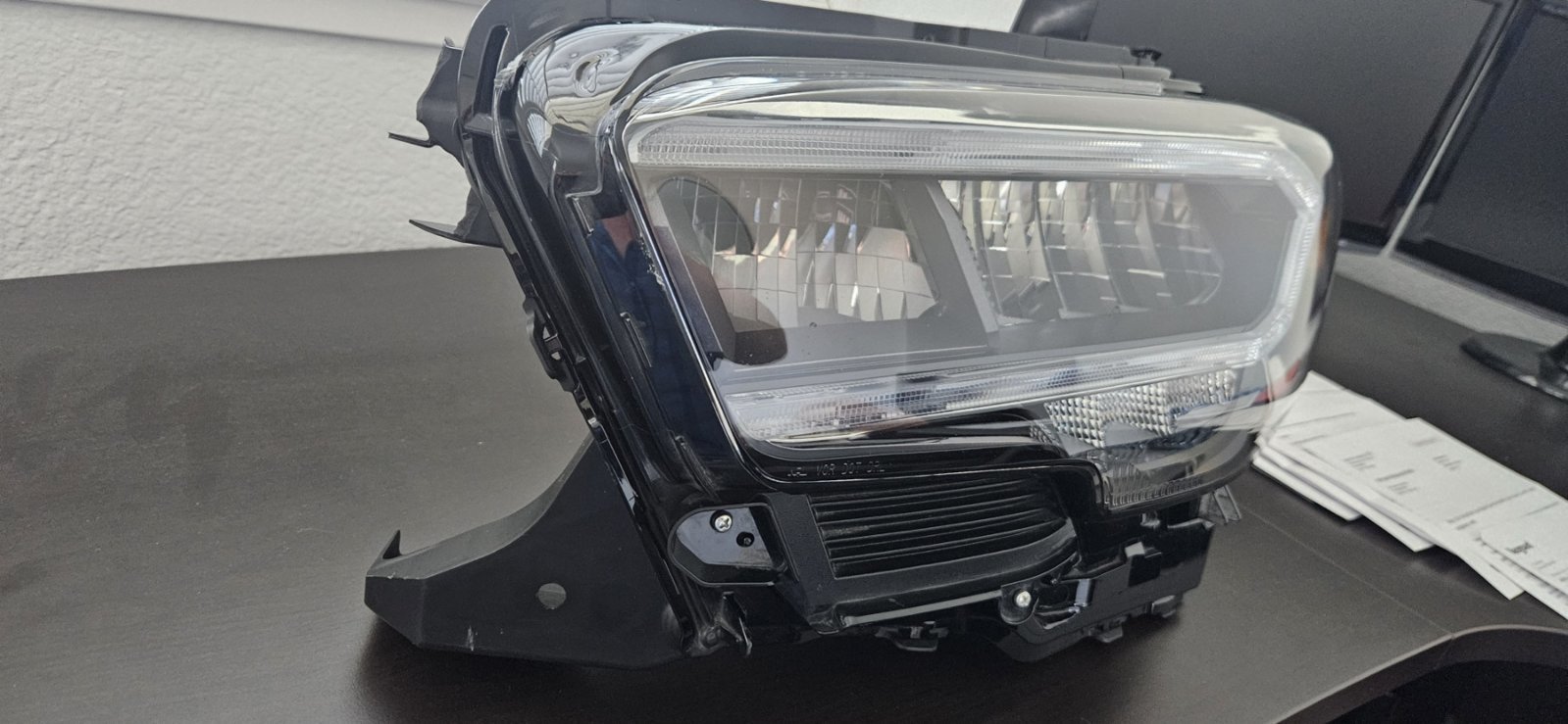

    Here are 2 pictures of my tabs. One is of them being reinforced, the other one is of them being fixed.
