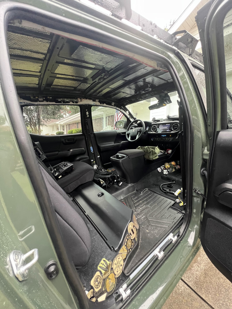

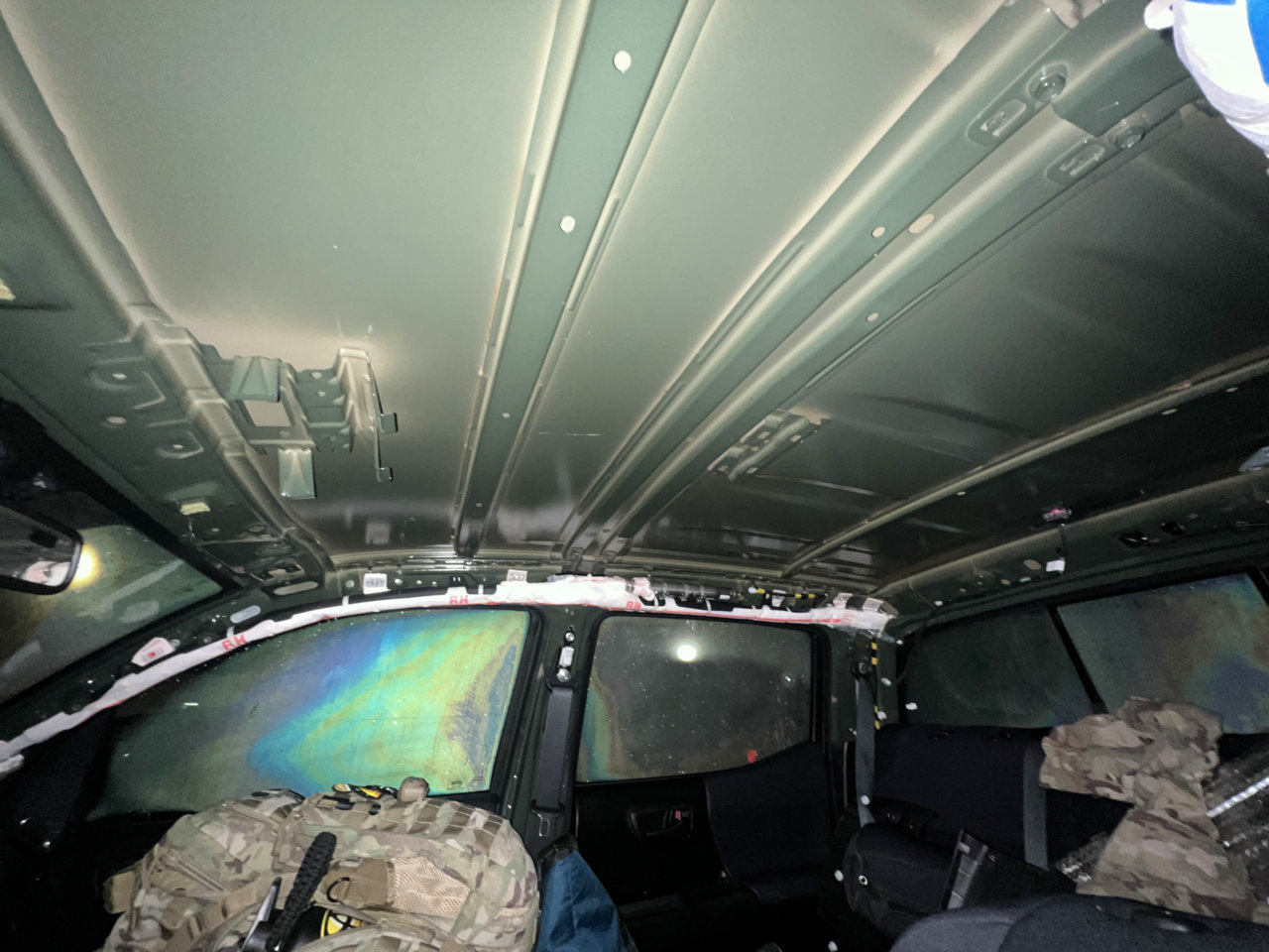

    First Step: Remove trim and seats
    tip: watch this for removal of rear grab handles and coat hooks https://youtu.be/aGv6AbZRuus?si=pIOmayGSEbl-FOhY
    Sun visor- #2 Philips and pull down.
    Sun visor supports- twist off
    Second Step
    :Unplug all wires on headliner and remove by going out the back door(double cab)

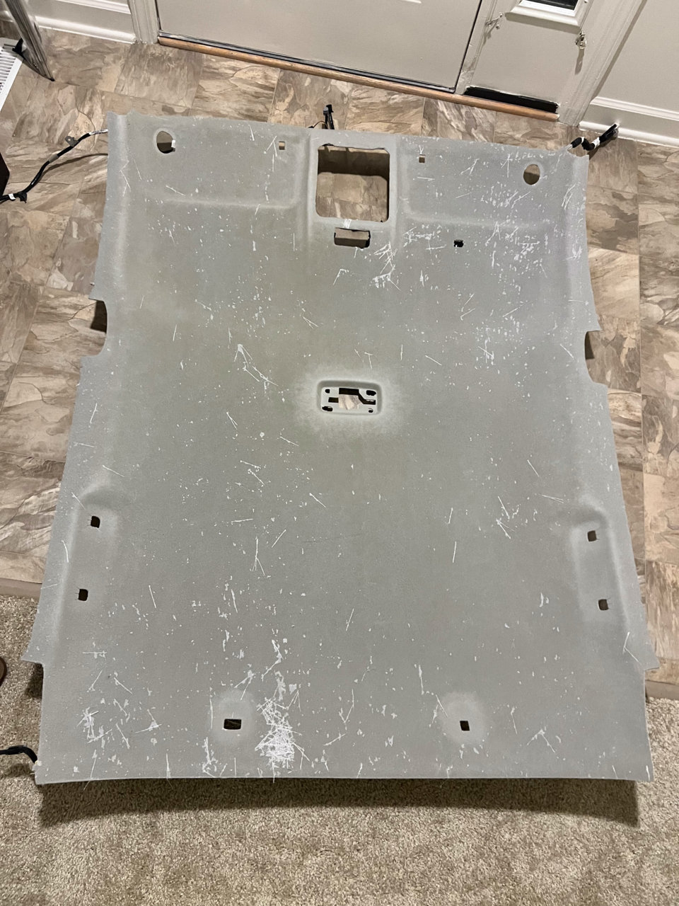

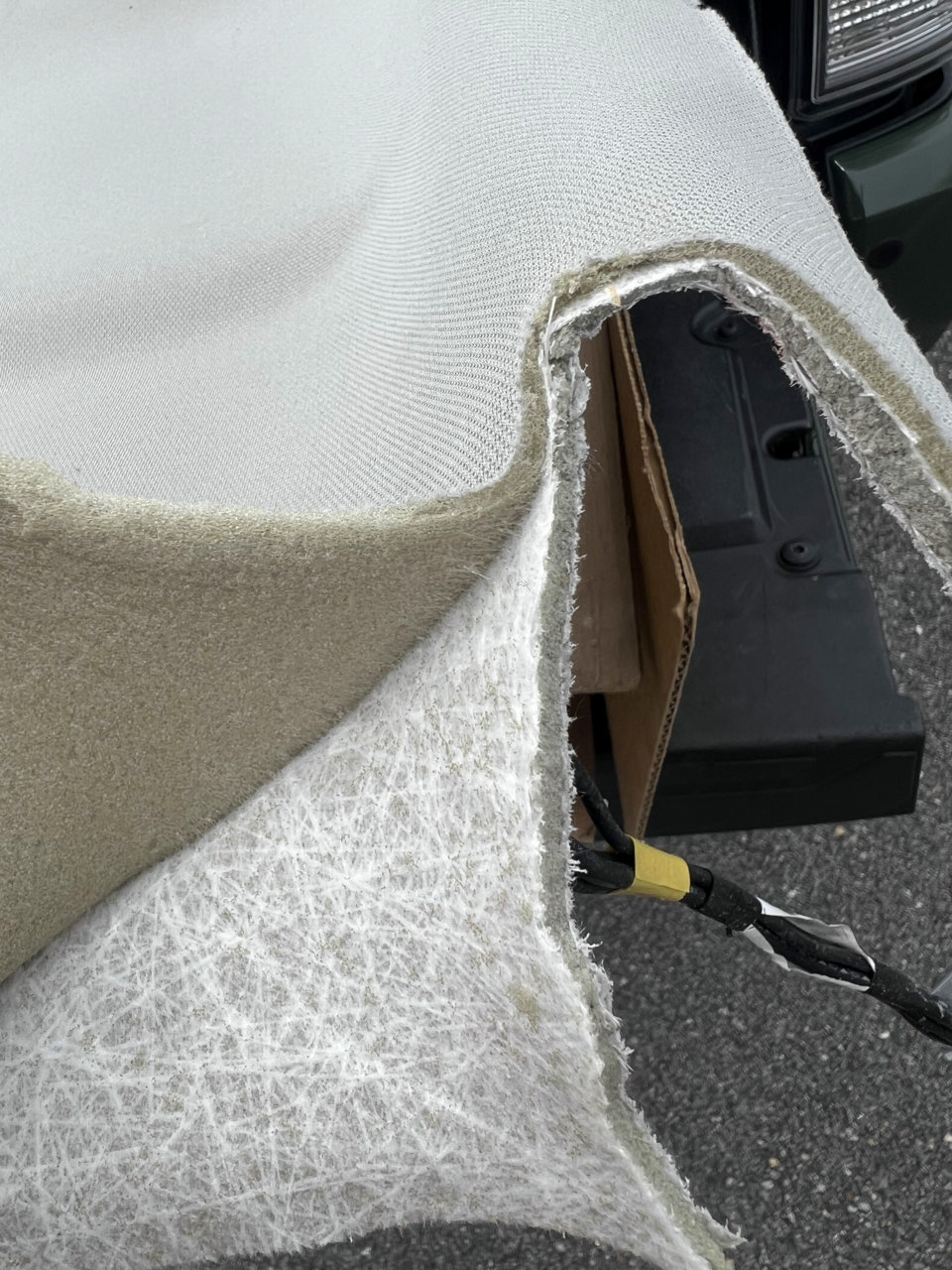

    Third Step: Peel off the first two layer of the headliner. DO NOT PEEL THE FIBERGLASS LAYER OFF. THATS HOW I MESSED UP.
    Here is a picture of what it should look like being peeled off.

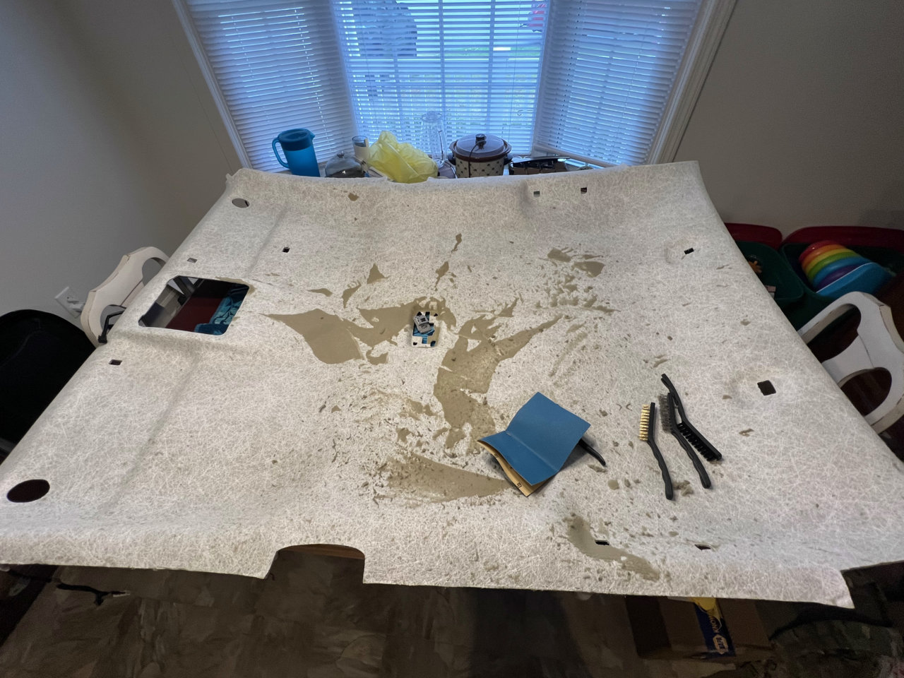

    Here is a picture of what it should look like being completely off.

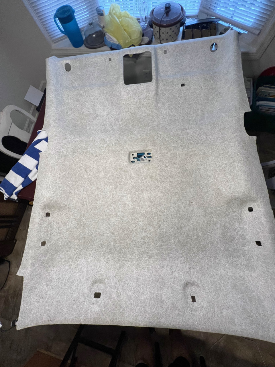

    Here is a picture of it ruined, I accidently ripped the fiberglass off...
    Forth Step: Remove all excess foam with harbor freight steel wire brush and sandpaper after. Tools pictured above. You might be able to find a better method. This worked for me. It’s cheap.

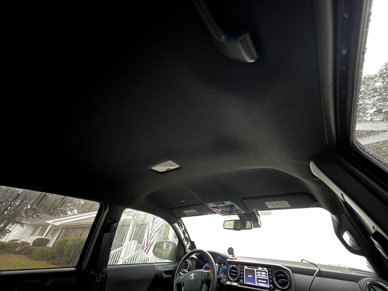

    Fifth Step: Take to a reupholstery shop and get them to use industrial glue. It’s worth it. It cost me $50.
    Sixth Step: Reinstall everything the way you took it out.
    tip: watch this for reinstallation of rear grab handles and coat hooks https://youtu.be/aGv6AbZRuus?si=pIOmayGSEbl-FOhY
    It reinstalled.

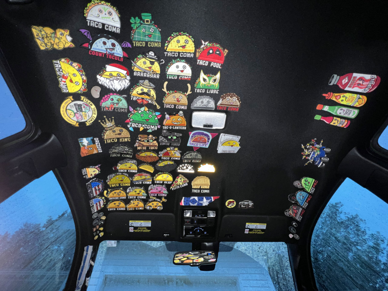

    Seventh Step
    : ENJOY THE PATCHES NEVER FALLING OFF AGAIN!!!!!!
