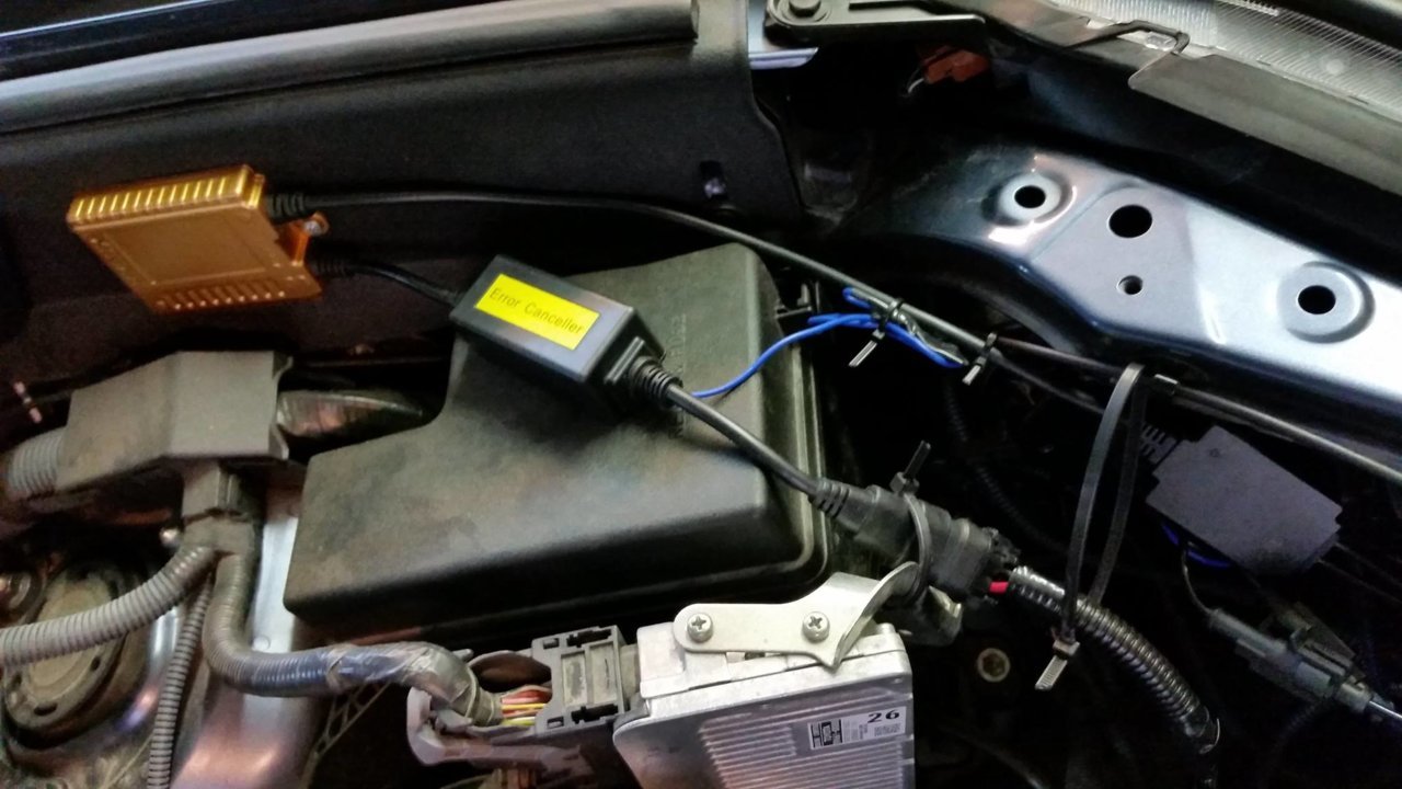

  9. Dec 3, 2019 at 2:51 PM
    #2069
    ppat4
    ppat4 Well-Known Member
    Oct 7, 2019
    #307325
    1,004
    Paul
    Kelowna, BC
    2016 Tacoma TRD Off-Road Access Cab
    Just added toolbox and roof-rack to haul my fishing boat 100's of miles into the backwoods every week. Goodrich K02s, Bilstein 5100 front and back, no lift.
    Fantastic post by the OP.
    I can't comment on my 2016 Tacoma, as I am still running the stock headlights. They are ok, barely...
    I did install a set of HID headlights into my wifes 2013 RAV4. Pretty simple install.
    Unbelievable quality! Yes, drivers coming the other way, have objected. However, she only gets flashed maybe once every 2nd day driving home in the dark. So not too bad.
    Had to put them in. Here, a lot of the roads she takes are country roads with no homes, no road lighting of any kind.
    Before, with her old Halogens, we could see at most 3 car lengths down the road. Now, at least 20 car lengths down the road.
    Those stock halogens on the RAV4 were terrifying. In my 45 years driving, by far the worse headlights of any car or truck we have owned. I tried a number of different halogen bulbs, looked at LED, but the dealer/installer said go HID for her driving case, so I did. He was going to charge $150 for the install. No way, did it myself in 1 hour. The lights have been in for about 1.5 years now, no issues. We take her RAV4 now whenever we go out at night, the Tacoma stays parked.
    We do a lot of driving on country highways, where the limit is 70mph, and there are cliff drop offs hundreds of feet down. A lot of very bad accidents and deaths on those roads. The HID are life savers.
    Some pics under the hood of the RAV4.

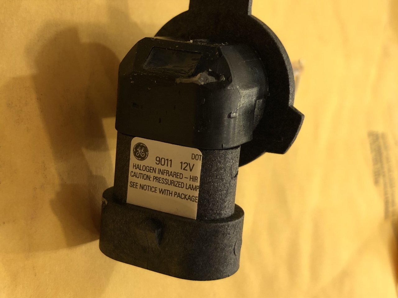

  15. Dec 3, 2019 at 6:52 PM
    #2075
    NMTrailRider
    NMTrailRider Well-Known Member
    Sep 28, 2009
    #23469
    5,293
    New Mexico
    Could a 9005 high beam (which doubles as the 4runner DRL) also be swapped to 9011HIR1?
    Is every 9011 an HIR1 or must it be labeled specifically 9011hir1?

  18. Dec 3, 2019 at 7:08 PM
    #2078
    crashnburn80
    crashnburn80 [OP] Vehicle Design Engineer
    Jun 6, 2015
    #156893
    14,758
    Kirkland, WA
    2003 DCSB TRD OR
    Yes. 9011s are HIR1s, just a different labeling system for the same bulb. Some 9011s do not have the IR coating anymore and use more conventional means to get the same performance, I haven’t kept up on which bulb brands still use the IR coating.
  19. Dec 3, 2019 at 7:34 PM
    #2079
    NMTrailRider
    Sep 28, 2009
    #23469
    5,293
    New Mexico
    I’ve been googling... it’s an HIR/toshiba/Philips rabbit hole going back several years.

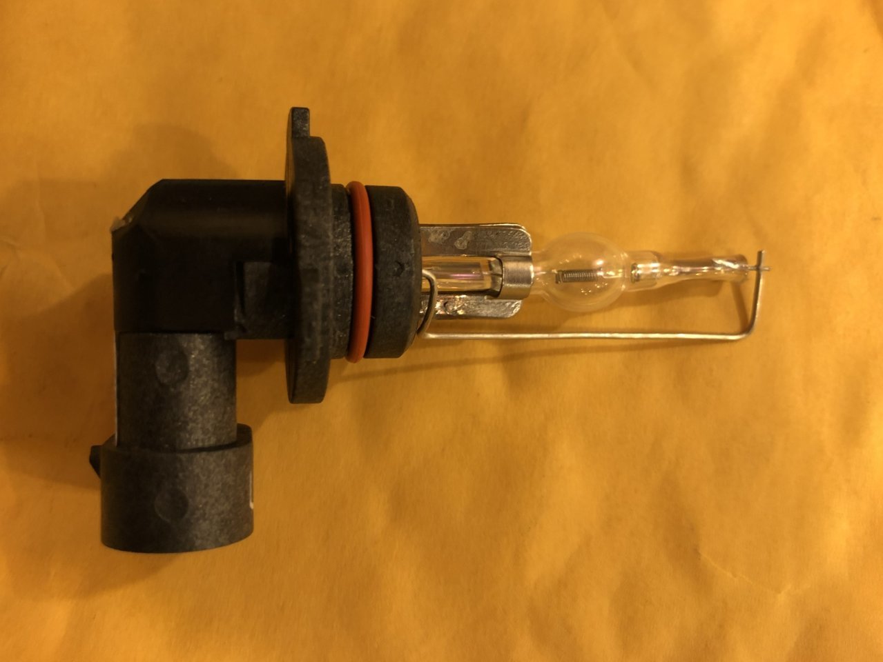

  20. Dec 3, 2019 at 7:50 PM
    #2080
    crashnburn80
    Jun 6, 2015
    #156893
    14,758
    Kirkland, WA
    2003 DCSB TRD OR
    Yessss. Then you end up hunting down exotics like these. :)
