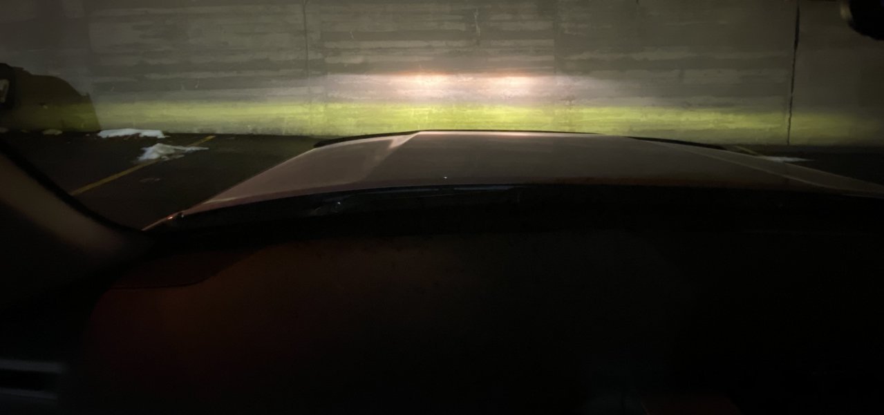

    I’m loving my Philips H9 low beams. I have a question and I apologize if it’s been asked before. On dips in the road and downhill grades I’ve noticed a pretty decent blind spot a few car lengths ahead. I’m guessing it’s due to the sharp cutoff of our low beams. Should I raise the low beams up a little to compensate or will that just reduce visibility directly ahead?
    I tried to capture what I’m talking about.

    I’d worry about dazzling other drivers if you bump them up at all. Even more so if you are carrying a load in the back.

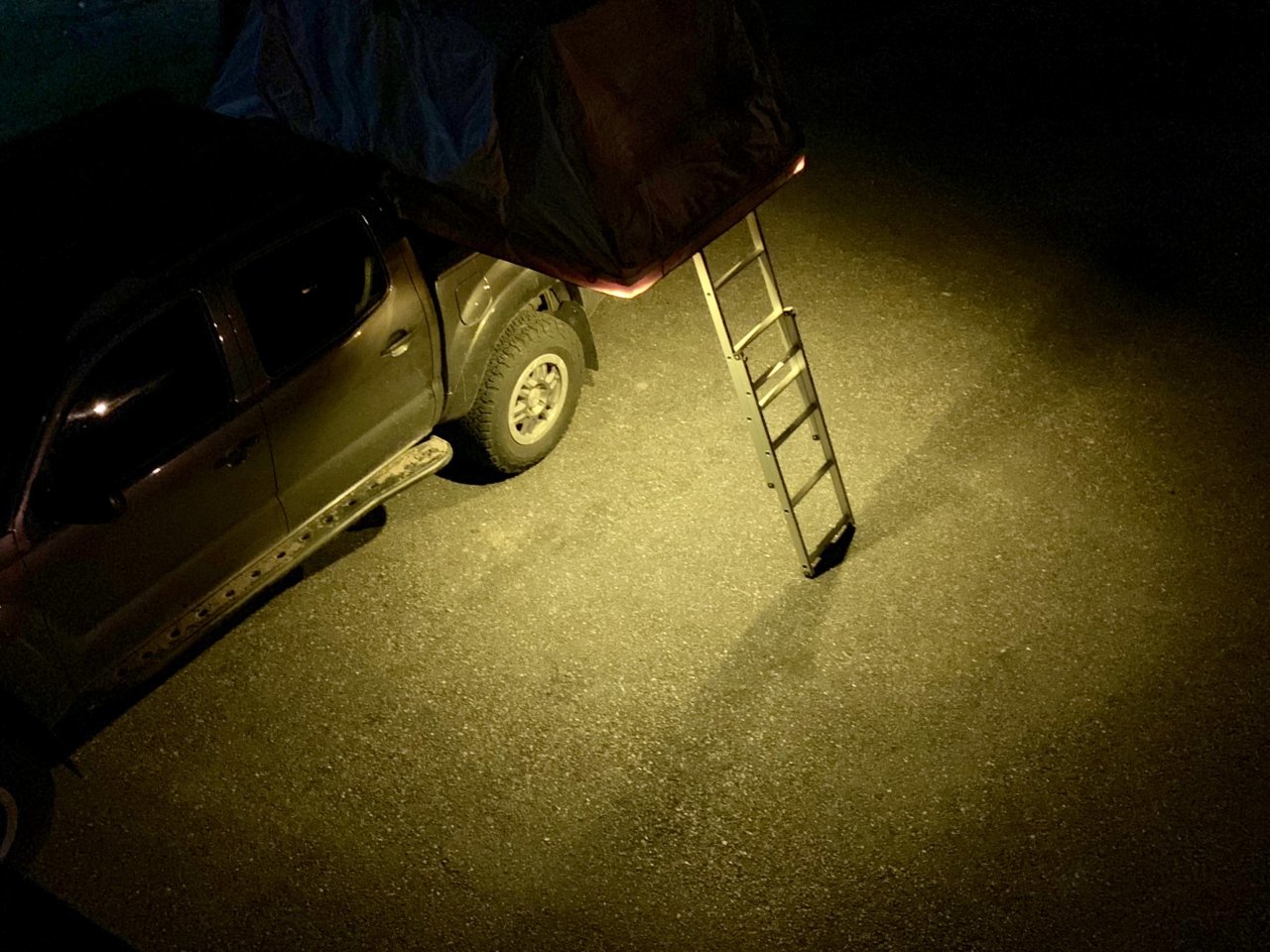

    Here’s my GE130’s with my Philips LED fogs (with yellow laminX). It’s a 4runner, so not apples to apples. But wanted to share the beam pattern with you guys.

    I was thinking that as well. I mean, the lights are leveled how they are for a reason. I guess I’m wondering more if it’s normal. If so, I’ll leave them alone.

    I think the cutoff is just more pronounced due to the added brightness.

    I thinking you’re right. Thanks :thumbsup:

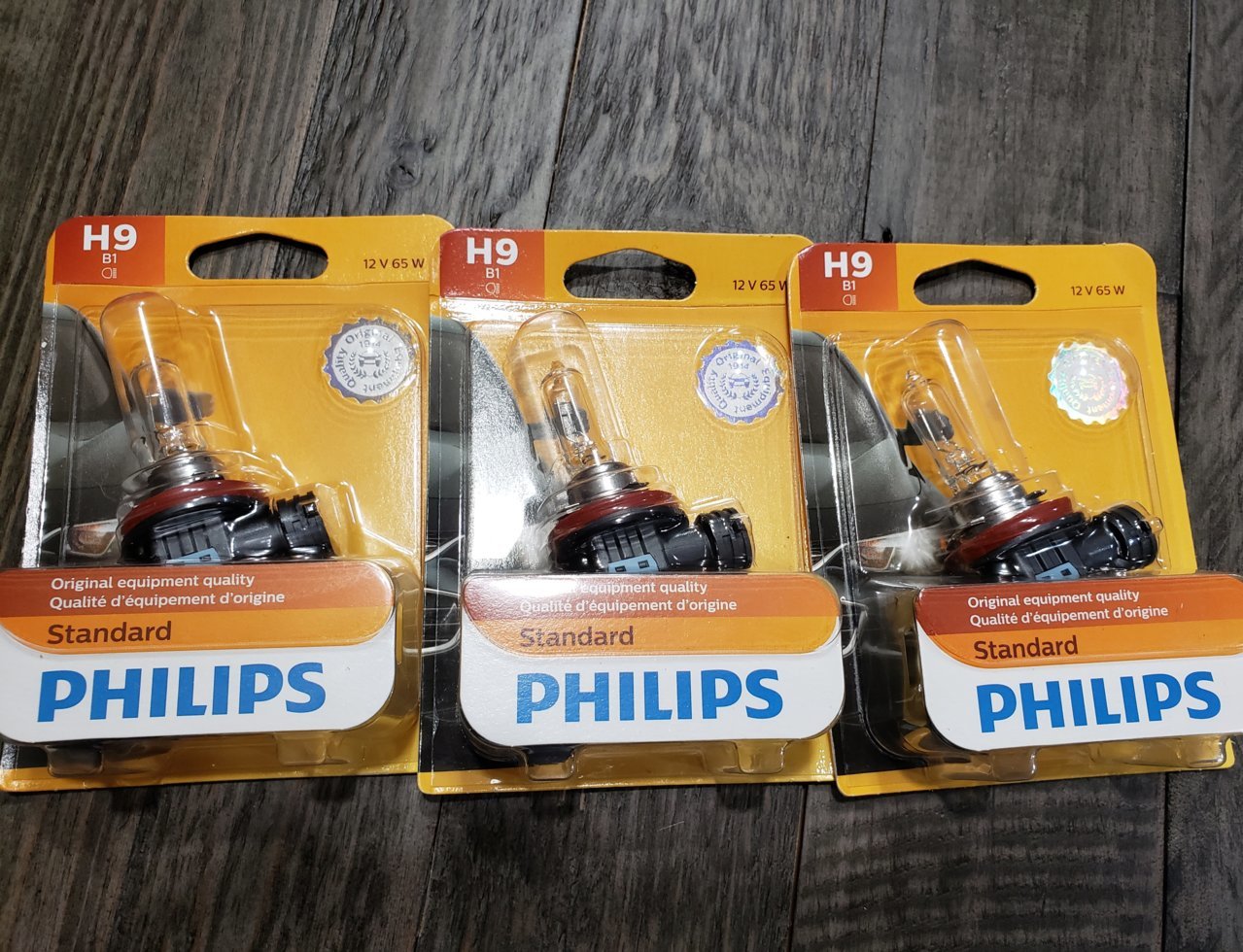

    20191208_175604.jpg Swapped my GE +130's with these tonight. Nothing wrong with the +130's and I haven't had them for too long. Just couldn't wait to swap em with the H9's because who doesn't want a better light right? The 3rd one is a spare in case one burns out and I need to replace asap. Since they are so cheap I may just stock up on a bunch lol.
