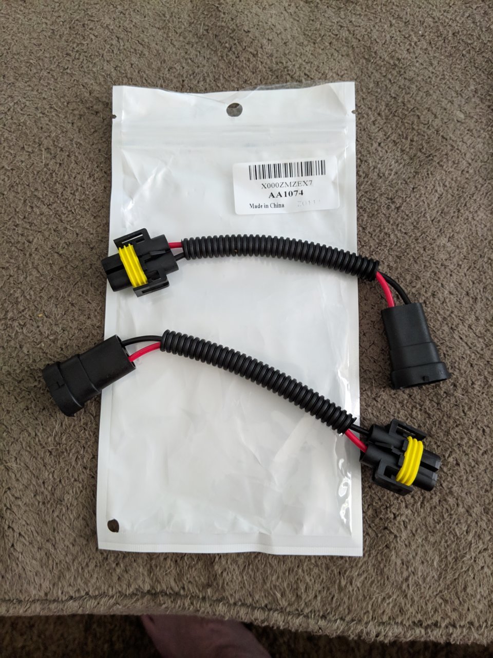

    14,772

    Mail Call. Just need my Bulbs. Which are being Drop Shipped from Hella. IMG_20190205_150039.jpg
