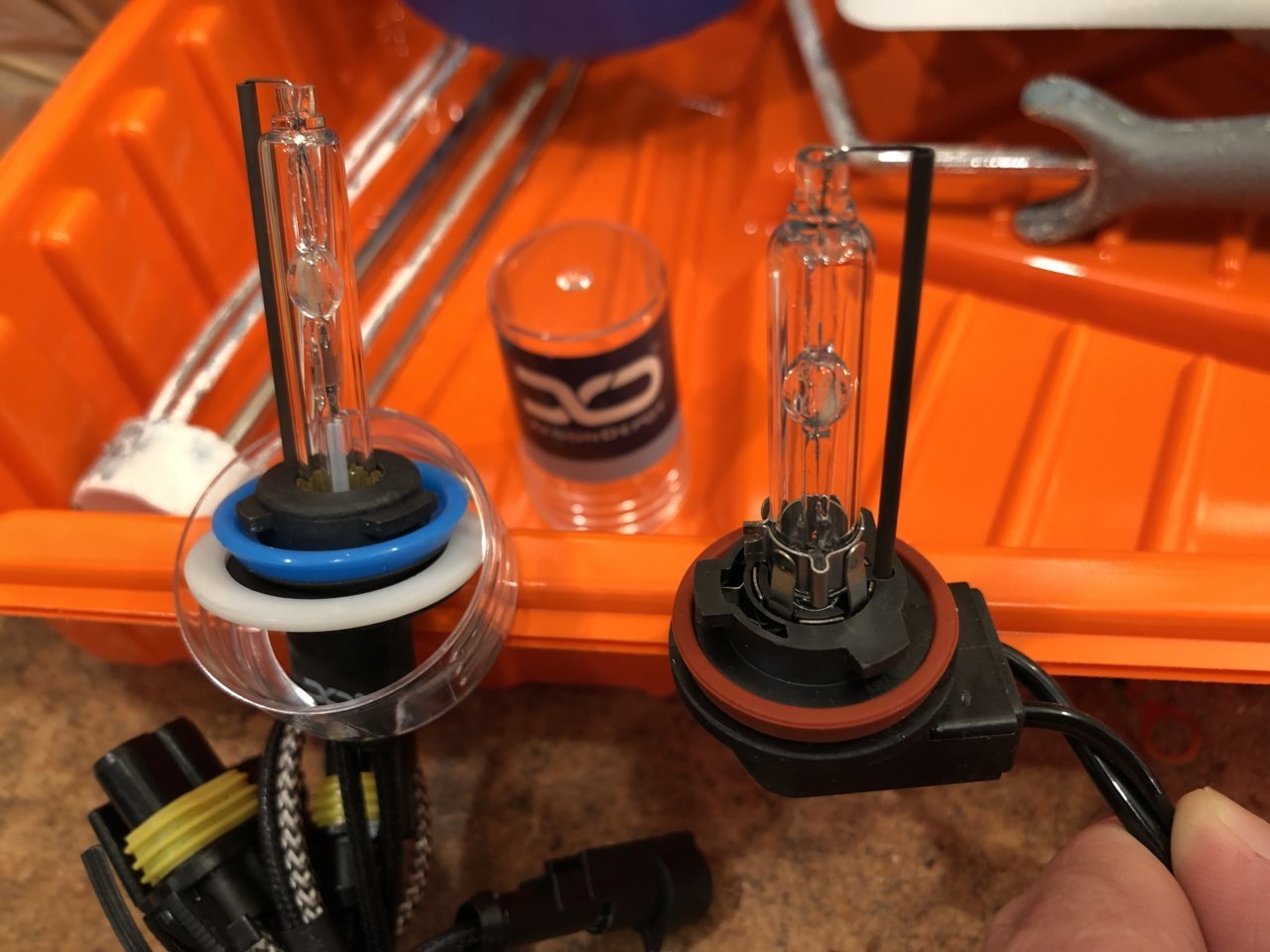

    Thanks to @crashnburn80 for this original post and continued engagement in what's a remarkable body of work. I've read nearly all of the pages on this thread, and many of the other lighting threads where he's helping lots of people in this community.
    I recently picked up a 2018 Pro 6MT and based on @crashnburn80's study/measurements, bought the @XenonDepot Xtreme H11 HIDs with the Philips 43k bulbs. These puppies. I placed the order on a Sunday and had them by Wednesday, sooner than expected.
    I installed them this past weekend and at the moment, have no bulb shake. I temporarily secured the relays and wiring wondering if I'd have any of the issues others have reported. So far, so good. This weekend I'll go in and tidy up the wiring.
    How do they work? In short, these lights are stoooopid good. So damn good. So bright. I adjusted the headlights down as before doing so, the cutoffs were just high enough to catch the outside rear view mirrors on some of the cars in front of me. SUVs and trucks were fine, but cars were on the cusp while traveling at a safe distance. So down they went.
    These lights excel everywhere and exceeded my expectations. I drive a mix of city, highway and country everyday, and on the back roads these lights make the journey so much safer and so much more enjoyable. The stock H11 bulbs are pretty pitiful, these lights are such a relief.
    The only thing I'm wondering is if I actually got Philips bulbs. In this picture from @crashnburn80 in his original post (page 1), the base looks like the bulb on the left, not the right. The seal/o-ring appears to be the silicone one pictured on the right (good!), but the actual base is not a right angle base similar to the OE H11 bulb. I'm not familiar enough with the nuances of the rest of the bulb construction to know if @XenonDepot changed the bases they were using and the bulb is actually still a Philips bulb. However, I was expecting the bulb base to look more the image on the right. If they don't hop on this thread and reply, I'll call or email them.
    All in all, I'm happy camper so far. Can't speak to the durability yet, but these things are legit. One of the best daily driver upgrades I've ever done, and I've many...!

    After TRS bought out Xenon Depot the Philips bulbs became unavailable for a while as the Philips bulb bases were changed over to match the XD house brand bulbs, in what I assume to be a cost cutting measure. If your bulbs have the OEM style red seal then you have the XD Philips bulbs.

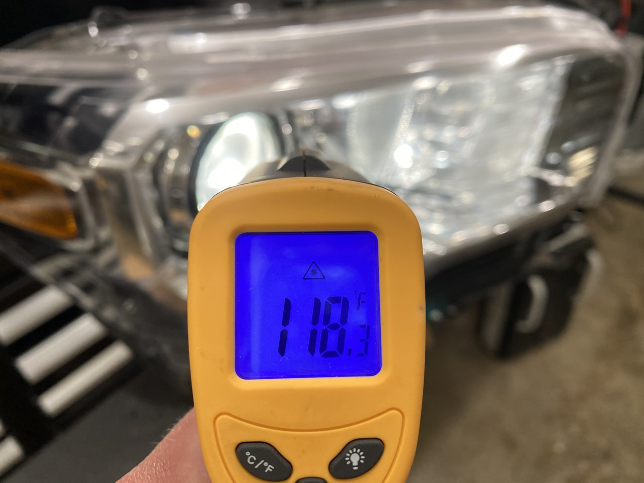

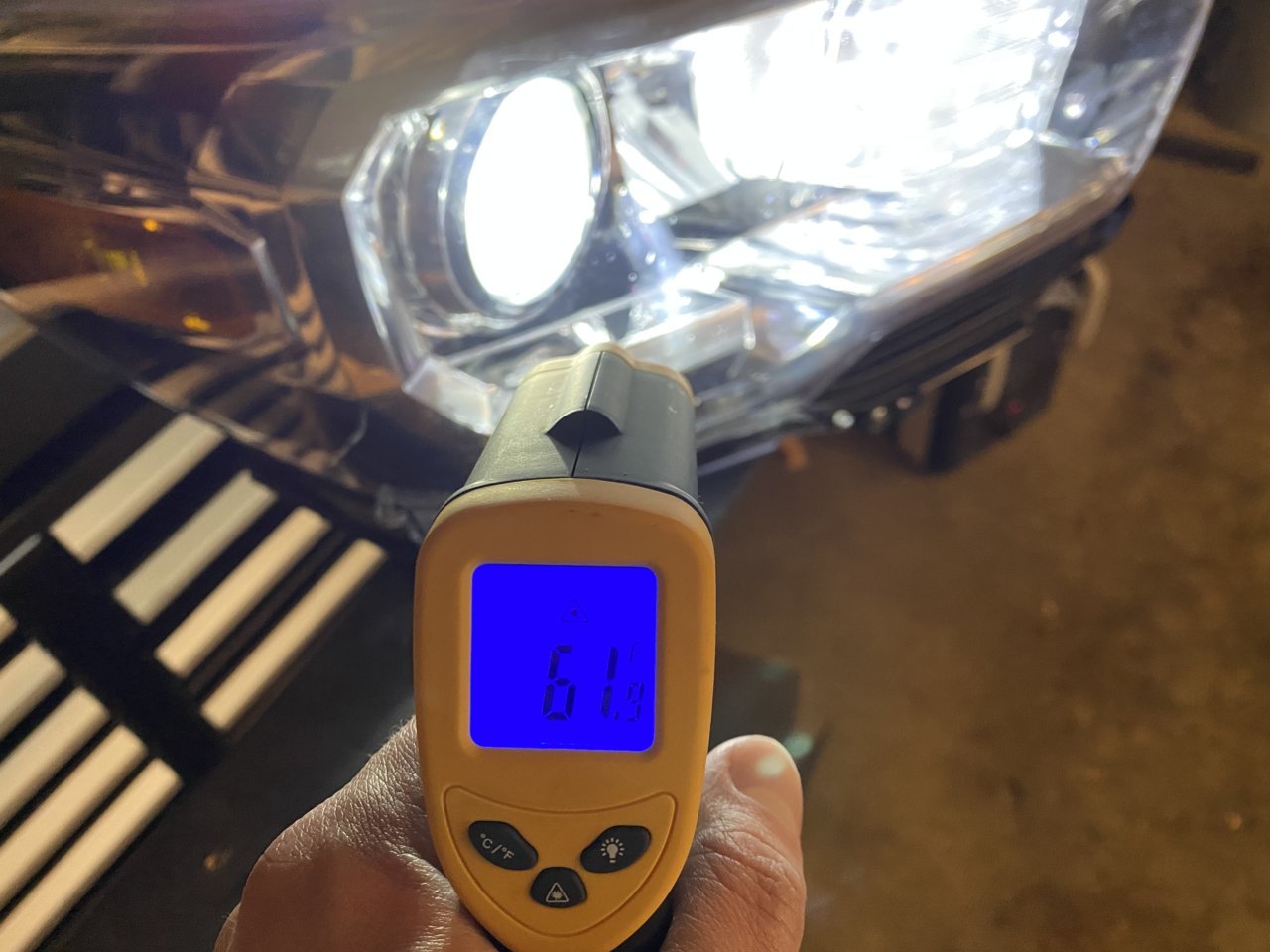

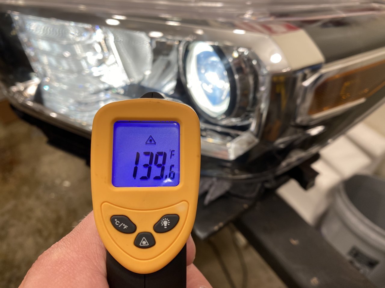

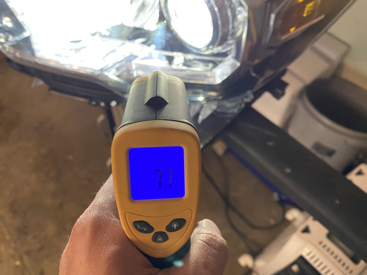

    Headlight Temperature Testing

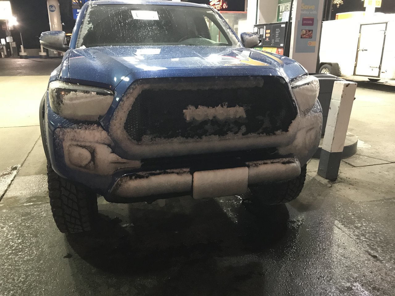

    With winter rolling in a common real concern is headlight freeze over for those in cold weather environments. I thought it would be interesting to capture representative lens temps across the various lighting technologies to have some quantitative data.
    The goal is to not end up like this, making your headlights completely useless.
    The above truck had drop in LEDs in a snow storm and lost forward visibility due to the LED lights lack of ability to self clear the snow.
    Measuring lens temps. For this test I focused the IR temp gun on the light output on the outer lens at an offset angle. Ambient temp was 60 degrees. Lights were run for 10 minutes before taking a reading.
    Baseline: Stock Osram H11 halogen, 118 degrees, or +58 degrees over ambient.
    Hikari LED, 61.9 degrees, or about +2 degrees over ambient.
    XD Philips HID, 77 degrees, or +17 degrees over ambient.
    Philips H9, 139.6 degrees, or +79.6 degrees over ambient.
    To summarize:
    Ambient 60 degrees
    LED: 61.9 degrees
    HID: 77.1 degrees
    Stock: 118.3 degrees
    H9: 139.6 degrees
    Pretty easy to see that LED offers almost no forward heat and will likely immediately freeze over in snow conditions. HID does moderately better, but still has lower freezing resistance than stock by a significant margin. H9s run a fair noticeably warmer than stock and will offer the ultimate protection in preventing lens freezing. If living somewhere with a high snow environment, I would recommend the H9s for best output and best resisting to freezing.
