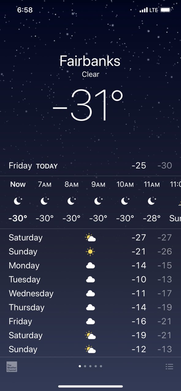

    Brr! Last year two other family family members and myself were driving in the same winter snowy conditions in eastern WA, each of their vehicles were equipped with HIDs. One was OEM RX350, and the other was the Xenon Depot Philips kit in a LX470. Both the HIDs continually froze over requiring them to stop and clear the headlights. My 2nd Gen running 85/80w Osram Hyper H4s obviously had no problem. While HIDs will provide better resistance to freezing than LEDs, HIDs will freeze over, but I think the likelihood is more inline with the water content in the snow for it to be sticky. At -31 degrees the snow is probably pretty small flakes and dry, reducing the sticking issue.

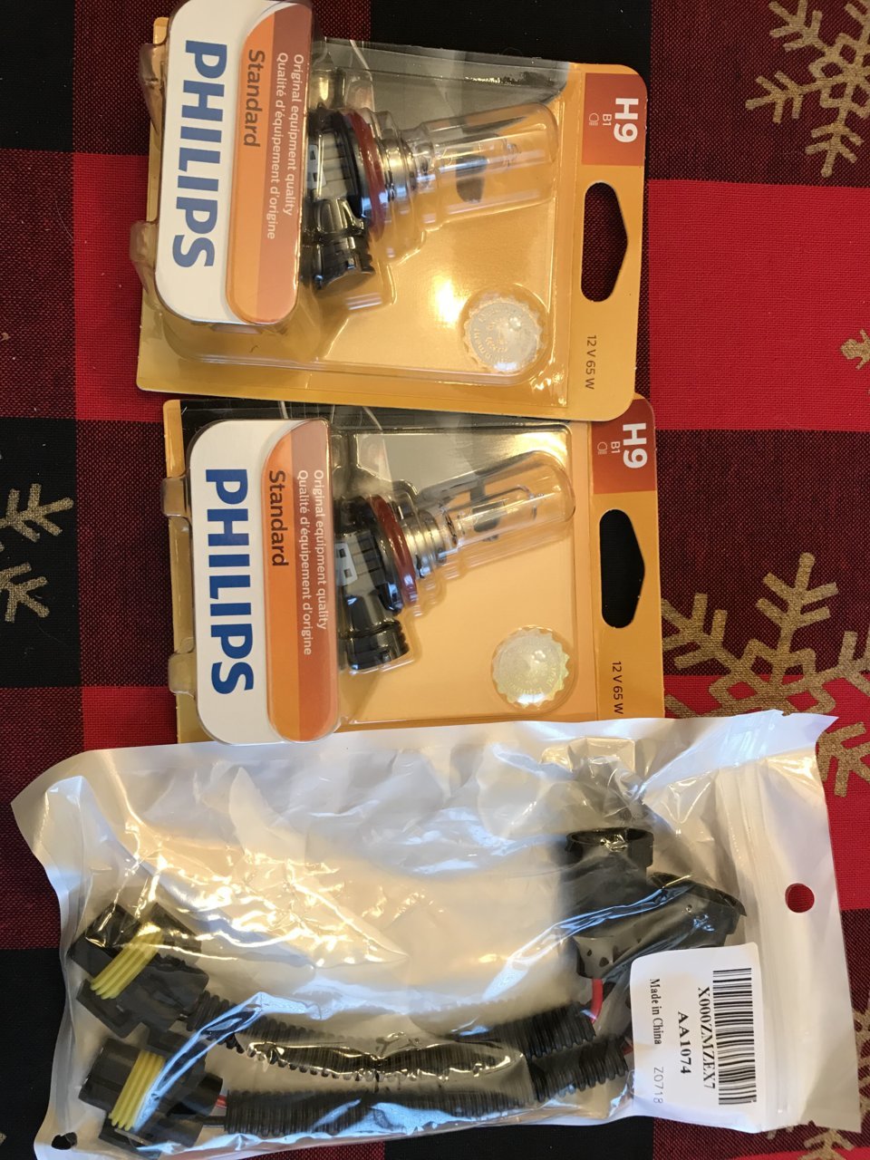

    Today’s project, headlight upgrade!

    Agreed!
    Crash is the man!
    He has completed all this testing on his own dime in an effort to educate the masses on proper illumination!
    Thanks to Crash’s efforts not only did I learn more than I thought possible about lighting, I was able to make much more informed choices. I upgrade my low beams to H9 and fogs to KC G4’s. So far I am extremely happy with the results!
    I was literally thinking how much better the night and inclement weather driving will be: “she blinded me with science” started playing in my head.
