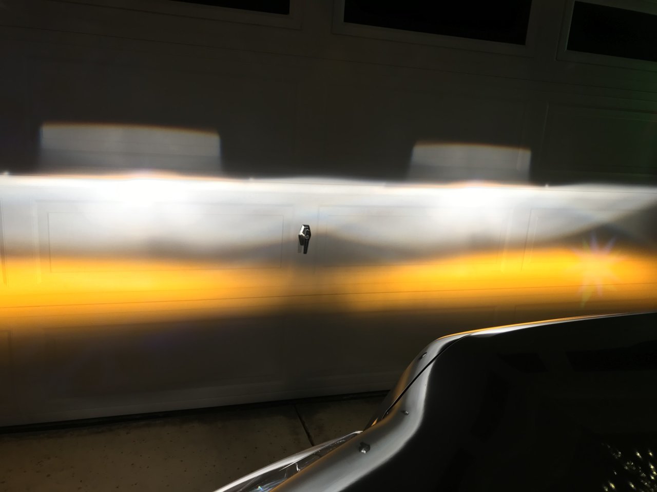

    First night drive with the H9’s and G4’s and all I can say is WOW!
    Here is a crappy iPhone pic of the garage door, I cannot believe how far out to the sides the G4’s throw light!
    crashnburn80[OP] likes this.
