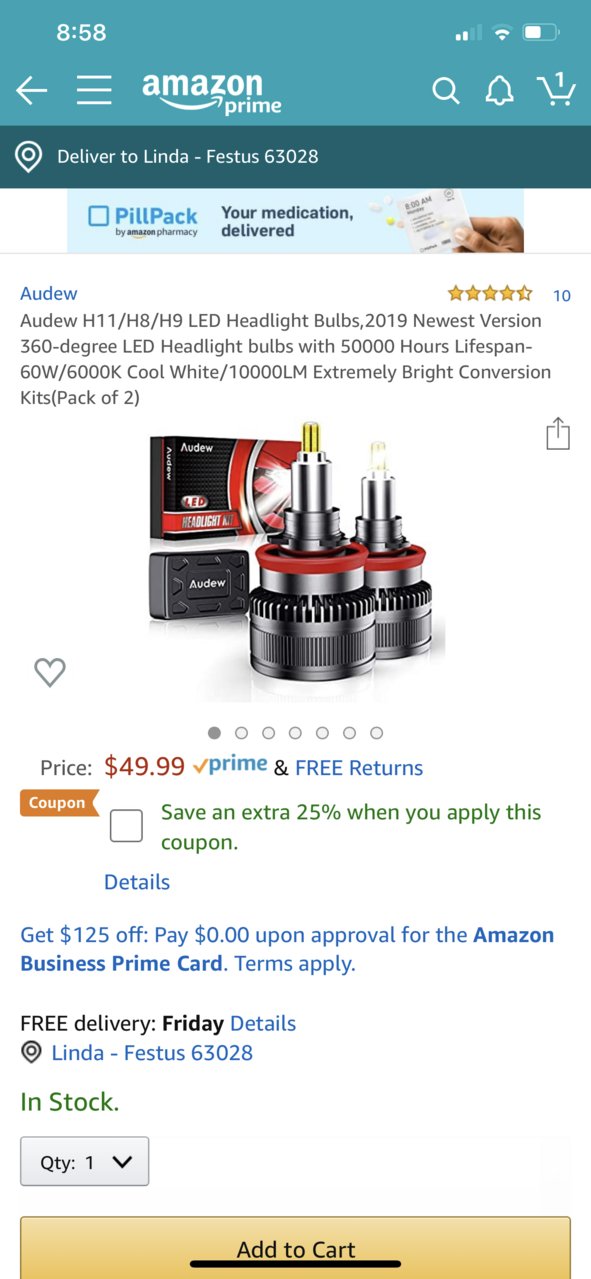

  10. Jan 8, 2020 at 7:16 PM
    #2310
    Sasquatchian
    Sasquatchian Well-Known Member
    May 30, 2018
    #254922
    723
    Those bulbs don't even come close to the filament placement in a halogen bulb. You don't have to go any further than see that to know that they're crap. That filament in a GE or Phillips H11 has to be within .2-.3mm of spec for it to work as designed.
  11. Jan 8, 2020 at 7:21 PM
    #2311
    mynameistory
    mynameistory My member is well known
    Jul 3, 2012
    #81862
    1,046
    Tory
    Redondo Beach, CA
    4Runner
  12. Jan 8, 2020 at 8:32 PM
    #2312
    Rockoma5
    Rockoma5 Well-Known Member
    Sep 19, 2014
    #138625
    805
    St Louis
    2019 TRD Sport Lifted
    Design is different. Seen a couple YouTube videos also. Looks interesting
  13. Jan 8, 2020 at 8:57 PM
    #2313
    crashnburn80
    crashnburn80 [OP] Vehicle Design Engineer
    Jun 6, 2015
    #156893
    14,772
    Kirkland, WA
    2003 DCSB TRD OR
    As @Sasquatchian pointed out, the design does not replicate a halogen filament. While it might first seem that the '360 degree' style LED bulb would work similar, the emitters end up being spaced way too far off center, which causes very poor focus. The best type of drop in LED bulb replacement is the opposing LED emitters on a thin blade design, and making the distance between emitter faces as small as possible (making the blade as thin as possible) will help improve focus. The emitters do need to be sized appropriately to also replicate a halogen filament.
    There are lots of garbage youtube videos out there that may look convincing, but most videos supporting/selling/reviewing these types of products are deceiving. And it is pretty easy to make a misleading video, many reviewers I think don't even realize they are doing so. Diode Dynamics produces some that do a reasonable job of explaining how replacement LEDs work in headlights, though they do typically paint a best case scenario and leave out some info but overall for LED marketing videos they are some of the better ones.
