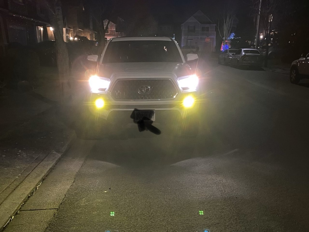

    Superhulk LB
    Superhulk LB Well-Known Member
    Mar 22, 2019
    #287595
    2,269
    Josh
    Oregon
    2019 superwhite DCLB off road
    Tonneau cover, Black exhaust tip, blacked out badges and tailgate lettering. Black rhino(glamis)18x9 wheels with +12 offset. LT265/70/18 Toyo Opencountry ATIII. Metaltech 4x4 rock sliders Cali Raised lower grill light bar/mounts TRD Pro Skid, DD Fogs(pro), Ironman 4x4 FC pro lift.
    Just for reference. Top picture is the GE+130 H11
    Bottom is the Hikari “eyes of megatron” H11
    1E50AF5B-7772-4F90-9C15-29AC538BA0D1.jpg 11A8BE90-40BF-4ED9-BE59-763057EE953B.jpg Not a very good comparison photo; but driving, the light output difference is negligible. I could be happy with either option in. I got the Hikari from Amazon for 40% off recently so gave it a try.
