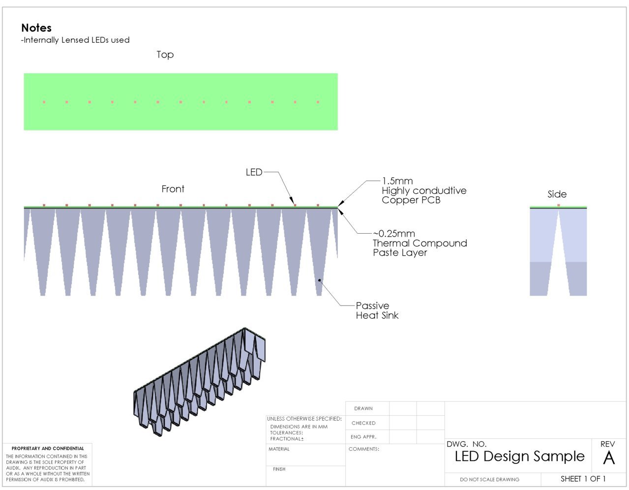

    For example most good LED bars and pods have the following construction: Light emitting diodes on copper PCB with big ass heat sink directly on the back of the PCB.
    This means that the heat from the Diodes is soaking into the copper PCB (great heat conductor) then out the heat sink.
    LED bulbs have none of this...

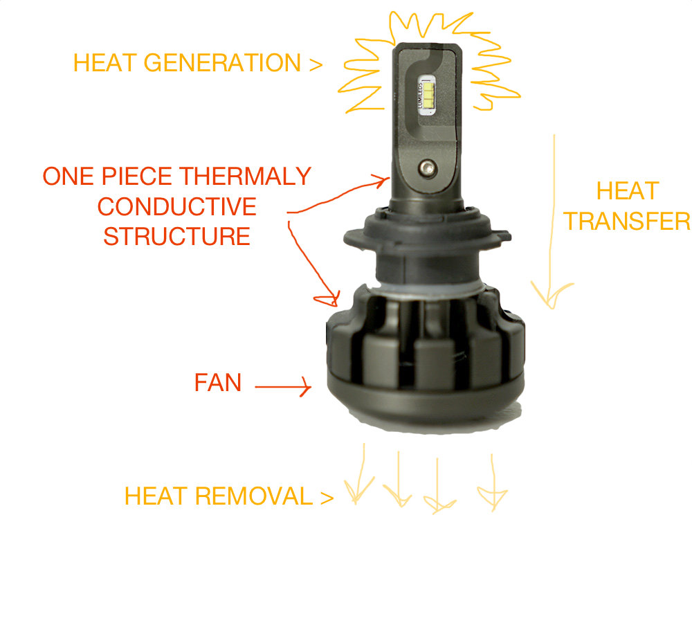

    You're going to force me into engineering mode, aren't you?
    Here you go:

    Engineering mode always!!! haha I love it
    IMO:
    Those 3 LEDs in that picture are way too close together concentrating all that heat in one spot
    The heat sink is way too far away
    Plastic is not thermally conductive
    If you're going full engineer then I will too!
    Below is a simplfied version of an LED assembly I designed as a part of a larger project. We did quite a bit of testing on this because power, efficiency, lifespan and beam pattern were critical for this project. Nothing on the market met our requirements so we had to design and manufacture from the ground up.
    I had to remove quite a bit of proprietary design elements to be able to get this released, but the general design concept is consistent.
    Let me know what you think. Lighting is fascinating

    At the risk of boring those who are here for the Tacoma content, here are some enginerd thoughts:
    The success of any high performance, value engineered design is always in the details. Overkill is an easier way to solve a problem, but won't sell on Amazon. How close to the limits can the engineer get and still be cost effective?
    Pretending to be that engineer, armed with little knowledge but lots of Google:
    <start pure speculation>
    - Hikari Ultra is using Lumileds, which is a reputable OEM mfg of lighting. Specs for the LUXEON F headlight LED I found online show Tcase is 130C, which I think means that the LED top surface can be up to 130C without failure. Even if the heat sink design is inefficient, as long as it is efficient enough to keep the top of the LED below 130C it's good enough.
    - The LUXEON F in the online spec has a dedicated thermal pad. So if the pad is bonded to the heat sink, it eliminates the thermally lossy PCB of an ordinary SMD LED.
    - The thermally conductive body of the Hikari appears to be anodized aluminum, not plastic. Aluminum is a good, inexpensive thermal conductor.
    - Active cooling using a fan makes the heat sink a lot more efficient than passive cooling.
    How close did the real engineers get to the limits? The bulbs have 11% 1 star reviews on Amazon. About half of those are from people dissatisfied with the light output (on lots of different vehicles - we know they work OK in Tacoma projectors thanks to Crashburn80). The other half of the reviews are from people who had the lights fail after a few months.
    Of those failures, you have to wonder about the percentage that are thermal failure vs other failures:
    - Some have failed because the installer left the driver box flapping in the breeze, hanging only by the cable, and the wires broke
    - Some have failed because the heat sink is trapped inside of a small enclosure created behind a rubber splash guard and it ends up simply recirculating the same hot air and overheating
    - Some have failed because there is no splash guard (like Tacoma) and dirt can get into the fan and stop it
    - Some have failed from poor installation of the LED onto the heat sink (poor factory QC)
    - Some have failed from poor thermal design. Perhaps the cooling system is not efficient enough when ambient temp is extra hot, or some LED's fail on on the low side of the max temp specification.
    Let's assume that 33% of the 1 star reviews are failures from poor thermal design. Not OEM quality for sure, but is a 97% success rate acceptable for an under $100 Amazon product? Just barely, but perhaps. The engineers of this product cut the design of these REALLY close to the acceptable limits!
    <end pure speculation>
