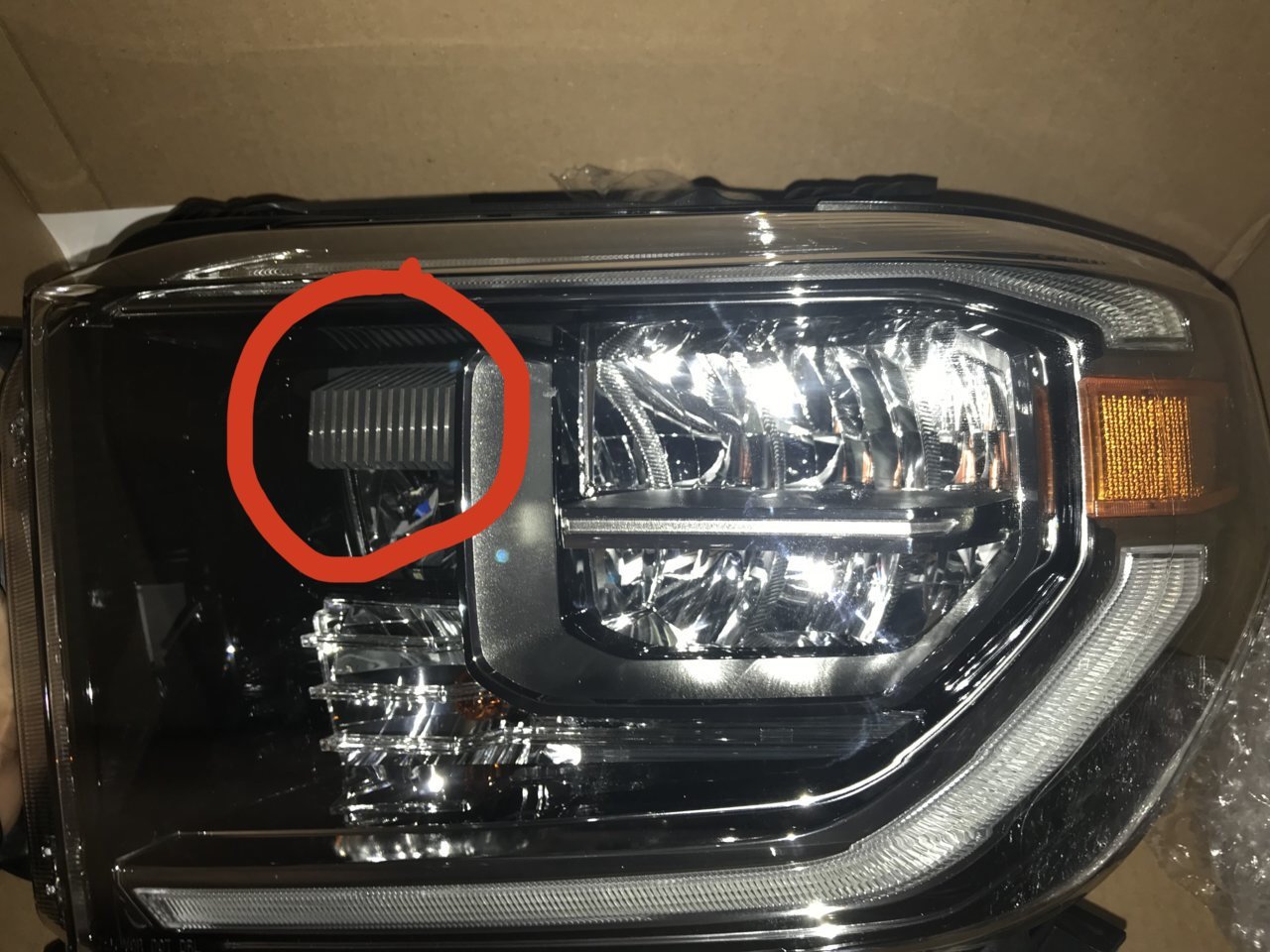

    I have seen some manufactures put the LED driver exposed in the headlight and make it part of the style of the headlight. I don’t know how much it helps, but I would imagine it may help a bit.

    KC does this as well. However, the problem with this design is that the reverse facing LED reflector optics are super efficient, meaning the power required is very low by comparison. And since the power is much lower than the forward facing optics designs, the heat is almost non-existent. Nice idea in concept, but I haven't seen it executed in a way that makes a significant difference yet.

    Iowa
    That makes perfect sense! I was just thinking they put it there for a reason to help keep heat in the housing, although I imagine it’s quite minimal at really low temps with snow and freezing junk that many of see. I’d be curious to see how much heat actually puts off.
