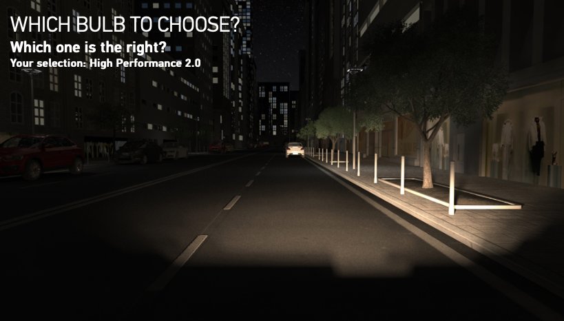

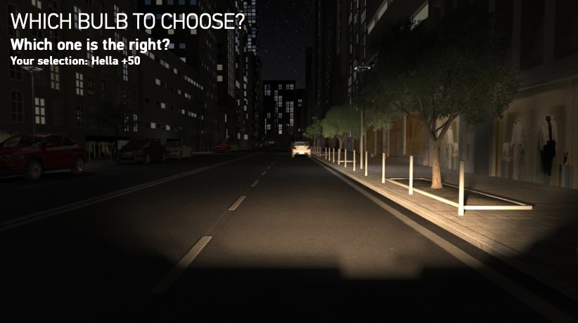

    I think this image on Hella's site does a great job at showing the side-by-side differences between their uncoated +50 series vs. their +100 High Performance 2.0 series. To me, the +50 actually illuminates the foreground better with similar distance projection. Overall while the 2.0 "looks" brighter in color temp the lower temp appears more functional in terms of light output due to the lack of the same level of filtering...

    I must be really getting old because I don't see any difference between those two pictures! :anonymous:

    In the photos the +50s are warmer in color temp, as would be expected since the 2.0s have a light blue coating. However I place little stock in these kinds of comparisons as they are typically “simulated”.

    Most of the metadata has been stripped from those two "comparison" images, which essentially means they're meaningless. To do a proper photographic comparison, a professional wide dynamic range camera shot on manual exposure recording RAW data and then both RAW files processed identically in the same raw processing software. About 98 percent of the images of headlight beam patterns are completely worthless because the process was incorrect and non scientific to begin with.

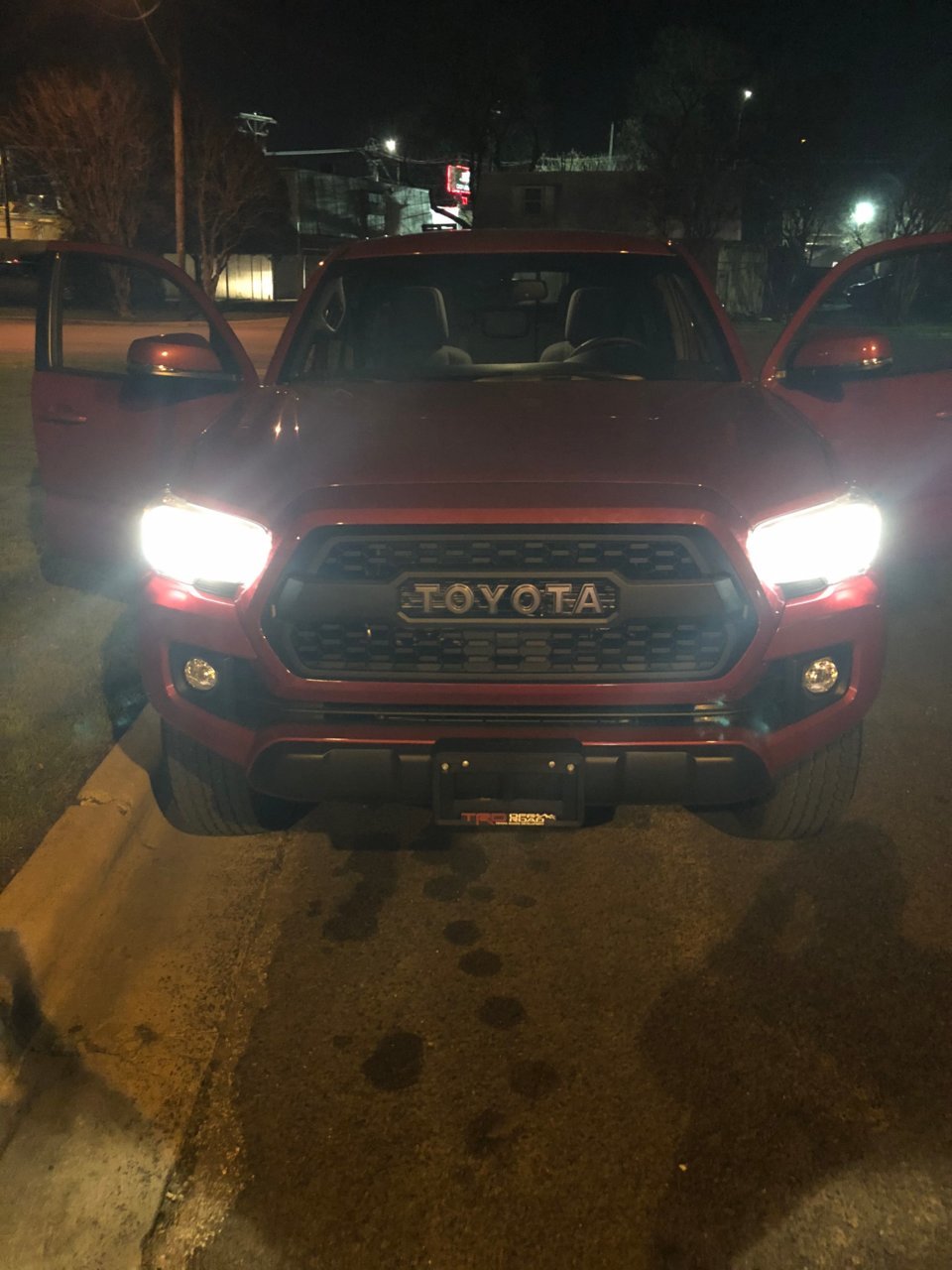

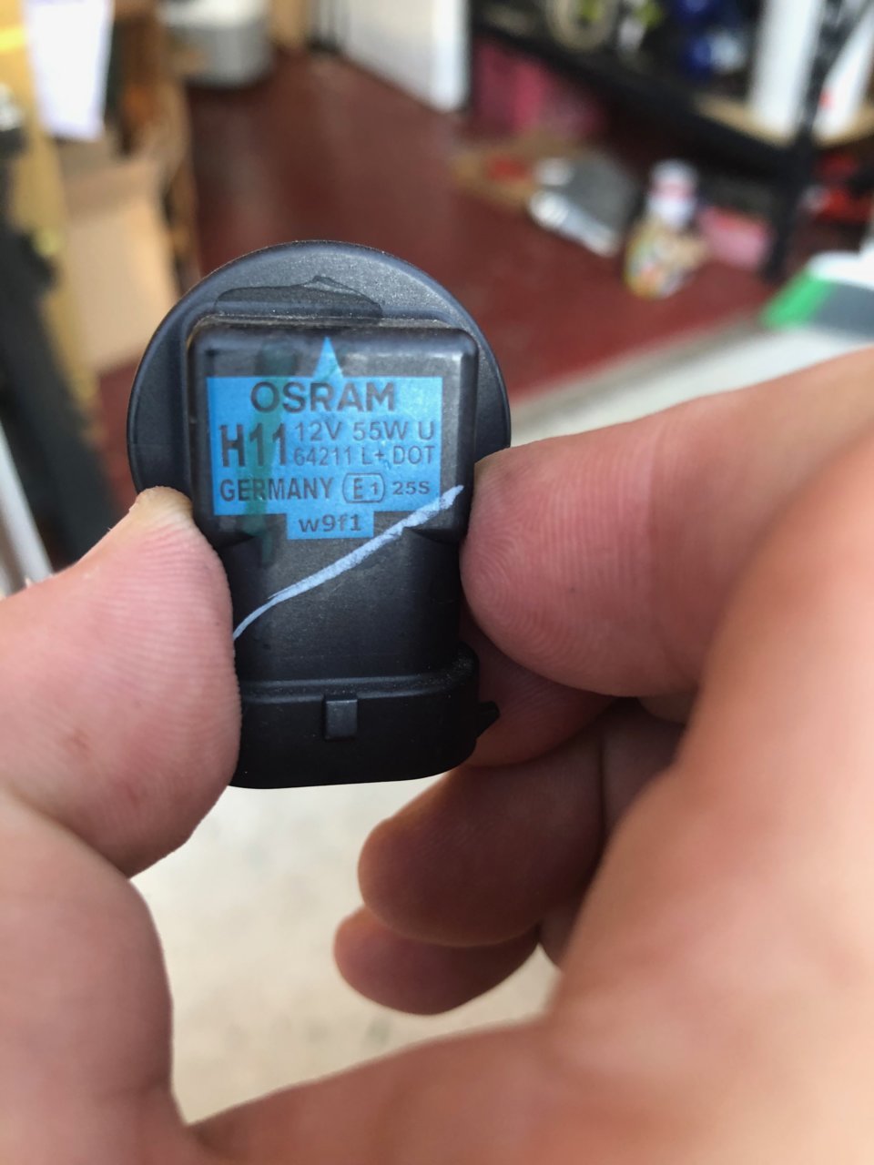

    Got around to replacing the headlight bulbs today and a big thanks to Crashnburn. I've never quite seen so much research on truck headlights but it was informative. I ordered the Philips H9 with the adaptor kit, (wasn't needed... It's a simple modification to make it fit) and replaced the H11 Osram stock halogen. IMG_0923.jpg IMG_0924.jpg
    So now I'm running the Stock H9 Highbeams and the Philips H9 Lowbeams. I didn't touch the fog lights because really, I don't use them too often and the lights are good enough. I'm very pleased with the light output and it's worked well for me.
