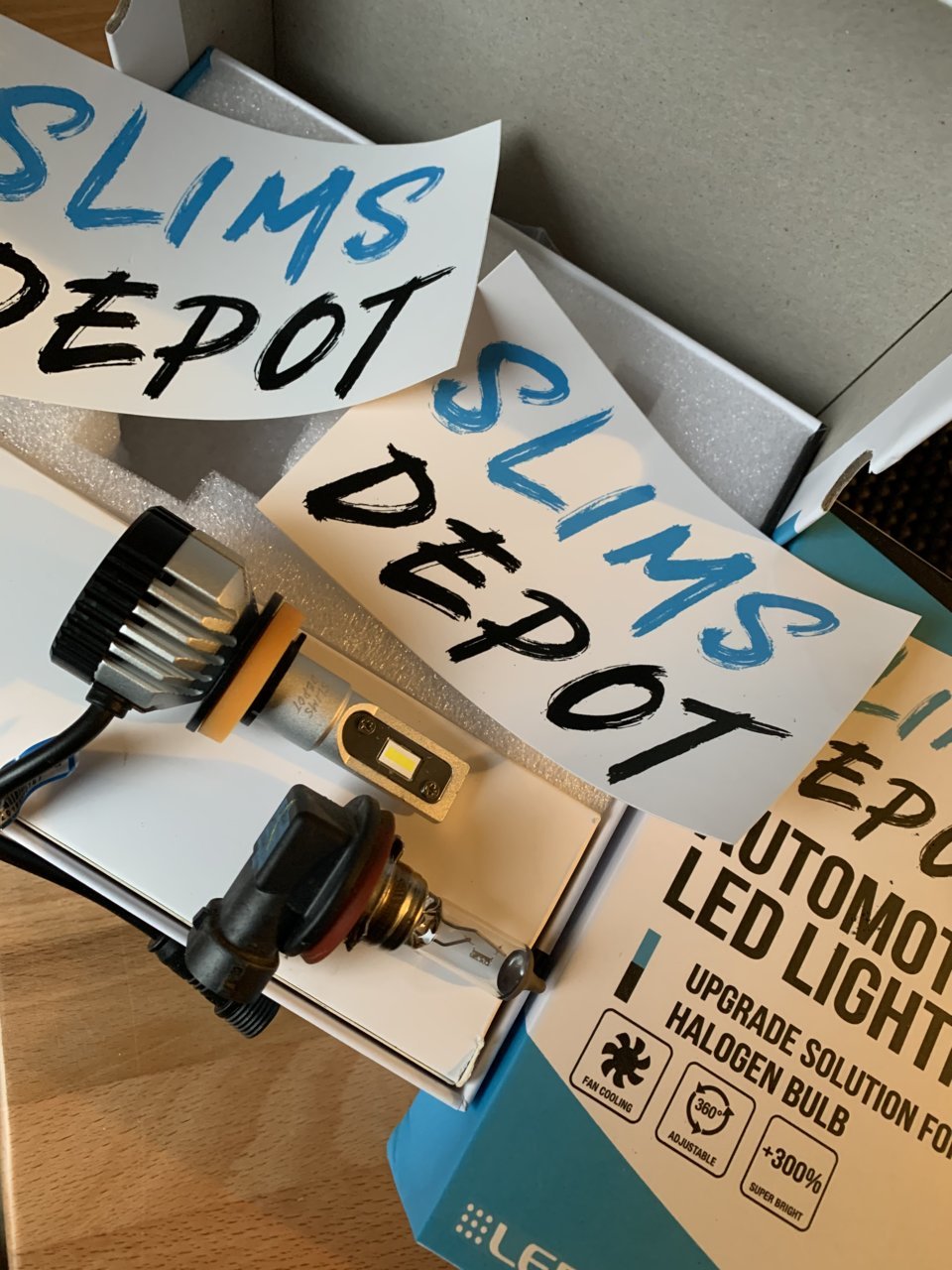

    The emitters on those are quite large as you’ve shown in your picture, much larger than the filament they are supposed to replicate. Meaning they will lack focus which is going to give you more foreground light and less distance projection.
