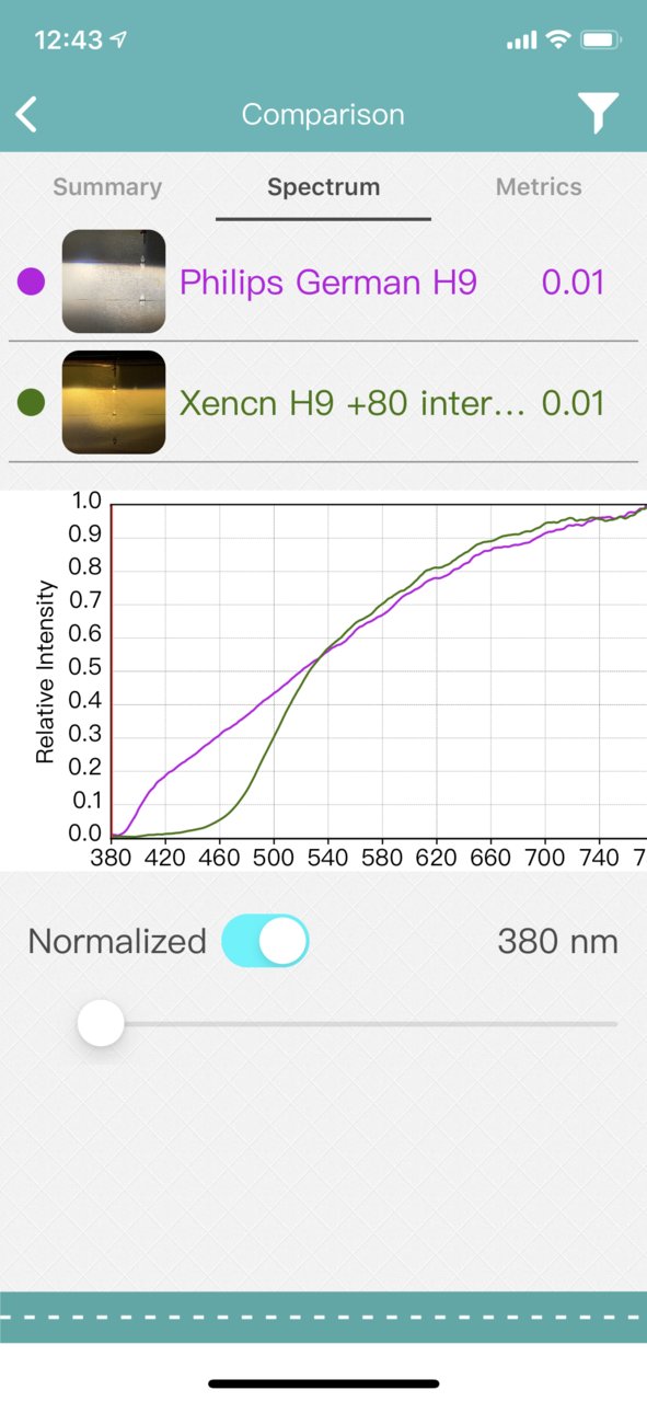

    No worries, see post #2 in this thread for all the updated halogen results, no need to sift through the whole thread! The H9s will provide increased light to the sides, within the existing pattern. They will not change the pattern as that is a function of the headlight assembly. The only wider area pattern that you can run in oncoming traffic is a SAE J583 fog light, but it is a short range pattern with low cut off. You might checkout the latest from Diode Dynamics in post #2369 here.
    If wanting to experiment for fogs, I would use a lower color temp, I was thinking your intended use was headlights thus suggesting a higher color temp. Xencn Goldeneye H9s are a lower color temp diffraction bulb, they spec 2500k but my readings are a bit higher. These also fall into the same brand bucket as Lunex, as not a reputable one I would recommend. They are out of China, you can get them through ebay and aliexpress. The further away from the natural halogen color, the greater the output loss you will incur, so no yellower bulb is going to compete with the Philips H9 in output. You can see the Xencn bulbs have more short wavelength light removed to achieve the lower color temp, at a cost of lower output. Another option to consider if wanting to experiment is Nokya Hyper Yellow H9s, they are a yellow coated 2500k spec bulb. I haven't tested those myself, but I'd probably lean that route if wanting to try a lower color temp H9.

    Those Lunex I mentioned earlier are pretty mild and would likely hit the white chromaticity windows requirements, though I did not validate that with measured chromaticity data. The pictures of the color in the app are not great, but you can see they have a slight golden hue but don't jump out as being a significantly altered halogen color. For temp I had them at just over 3000k. I didn't have the ability to measure and plot chromaticity before when I tested them, but I do now. Bulbs that advertise 2500k or have yellow coatings will be far to yellow for the required 'white light' for headlights. A white sheet of paper is obviously a pretty poor technical assessment, but if it stands out and looks the part to the point where an officer is performing that 'test' on the vehicle, your likely going to get cited for it regardless.

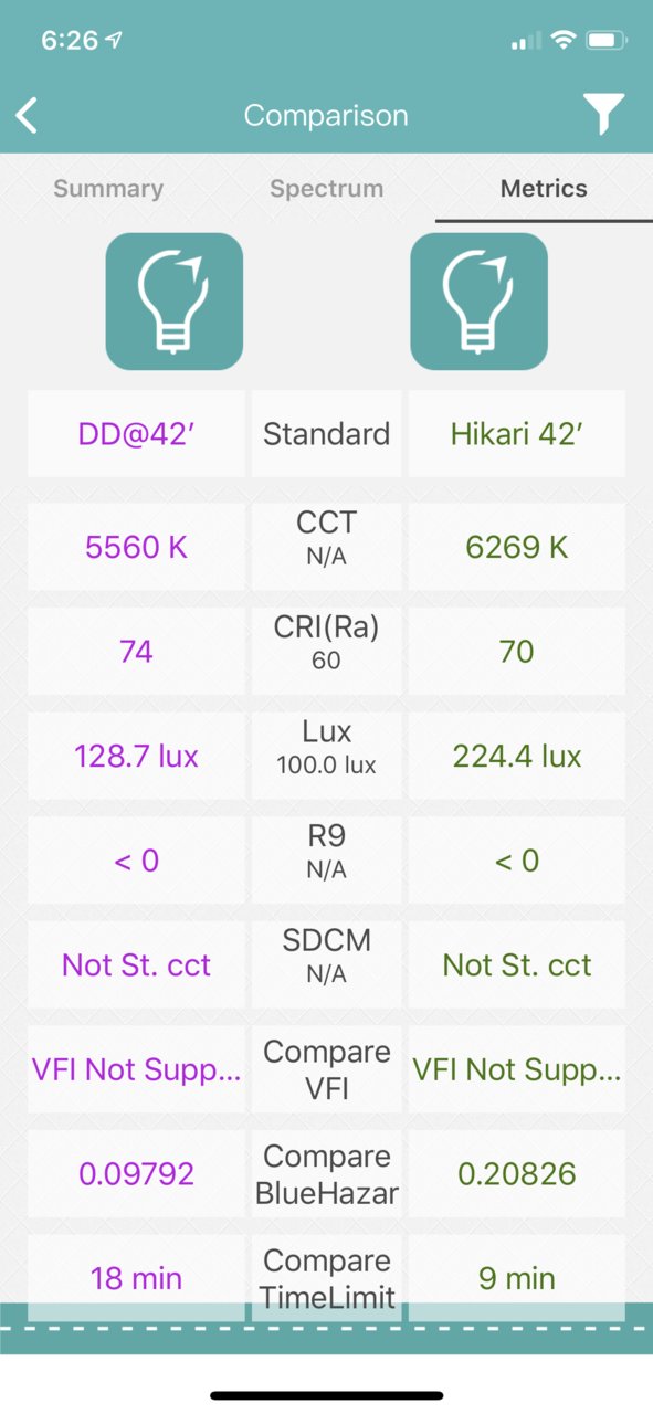

    How would you compare SL1 from Diode Dynamics vs the Hikari Ultras?

    You can see the reviews of each below.
    Diode Dynamics SL1 LED Headlight
    Original review posted here.
    Hikari Ultra "Eyes of Megatron" H11/H9 LEDs
    See the original review in post #1608 here.
    The Hikaris have better focus and much higher intensity output. They are the only replacement LED I have tested that outperform stock in the 3rd Gen projector. While optical performance and design is good, the build quality for the long haul seems questionable. Here is a 42’ distance test intensity comparison between the SL1 and the Hikari Ultra.
