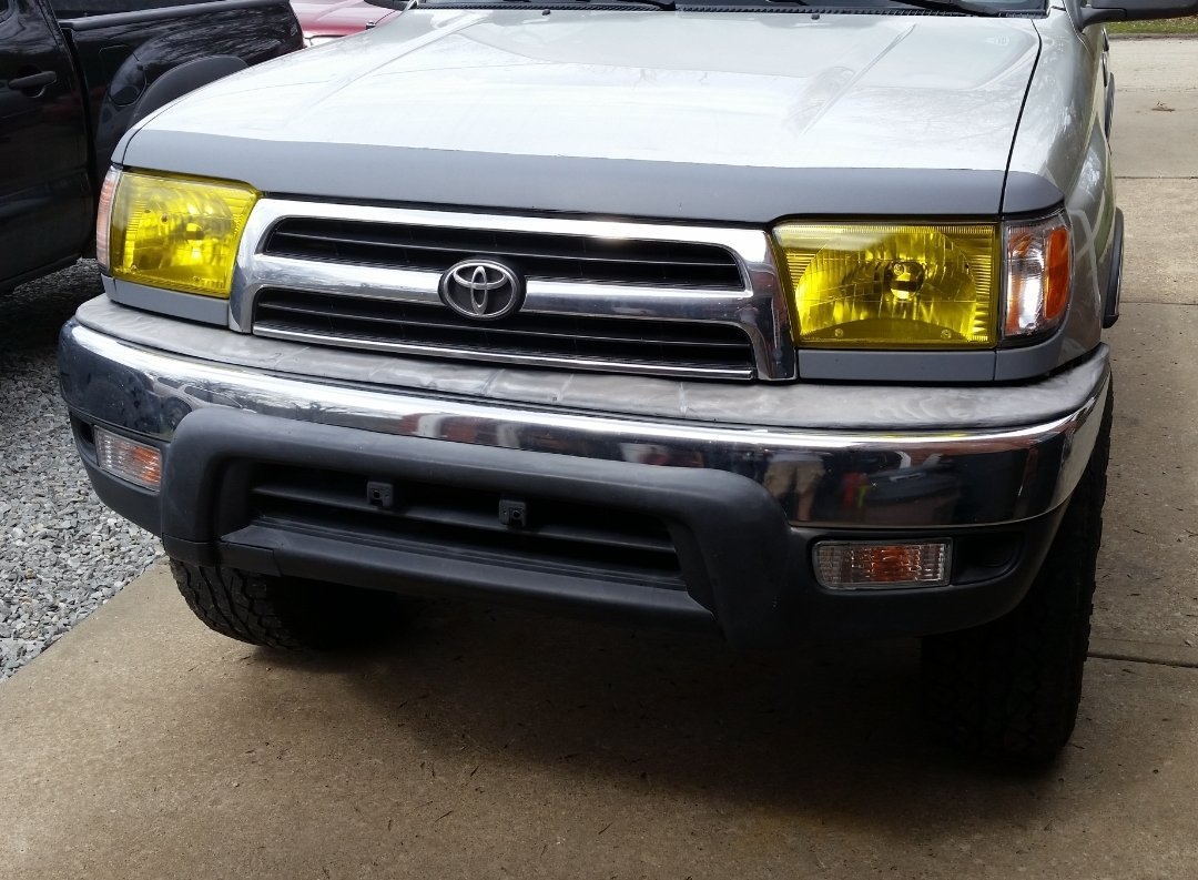

    @ TacoFergie and Crashnburn80
    You could apply a layer of kapton tape over the len. iirc it has a fairly high melting temp, and it will effectively filter a halogen to selective yellow. Surprising durable.
    I don't have pics of it, but I used large sheets of kapton tape over the lenses of my 4runners lamps. Apply it over a wetted lens, and squeegee out the water, like you were applying window tint or a sticker. It doesnt look likeit will go on clear, but it does. Very very similar tint effect to the paint I ended up using later, Duplicolor metalcast anodize yellow. Easily removed as well, didnt really leave an appreciable residue from the adhesive.
    I would definitely try kapton vs a vinyl lens cover, its thinner and should block significantly less light. And definitely kapton or other lens wrap before trying paint over a plastic lens of any sort.

    I haven't used Kapton tape before. I looked it up and it seems like its mainly used in electronic insulation among other uses but it does not seem like it would handle impacts from rocks and such. Fortunately for me, Iowa doesn't have vehicle inspections and doesn't care what you do to your vehicle.

    @TacoFergie
    The benefit is that its cheap to use the kapton, and much less permanent than paint over a plastic lens (unless you are willing to polish off the paint and then whatever is left of the original uv hardcoat). So if it starts to get noticeably torn up, its easy to peel off and reapply. Vinyl is going to hold up better, but is also going to block more light.
