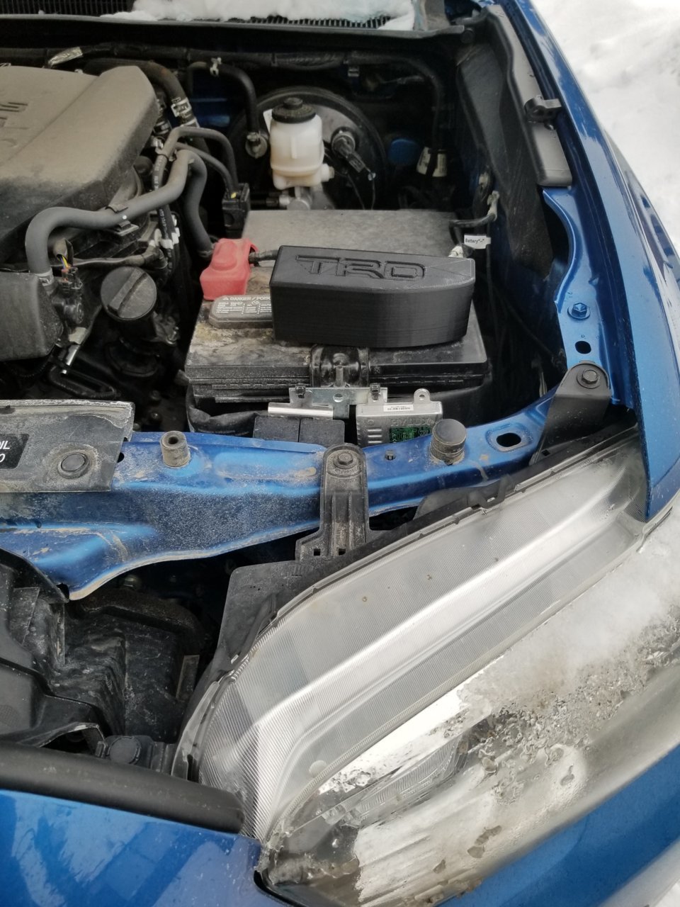

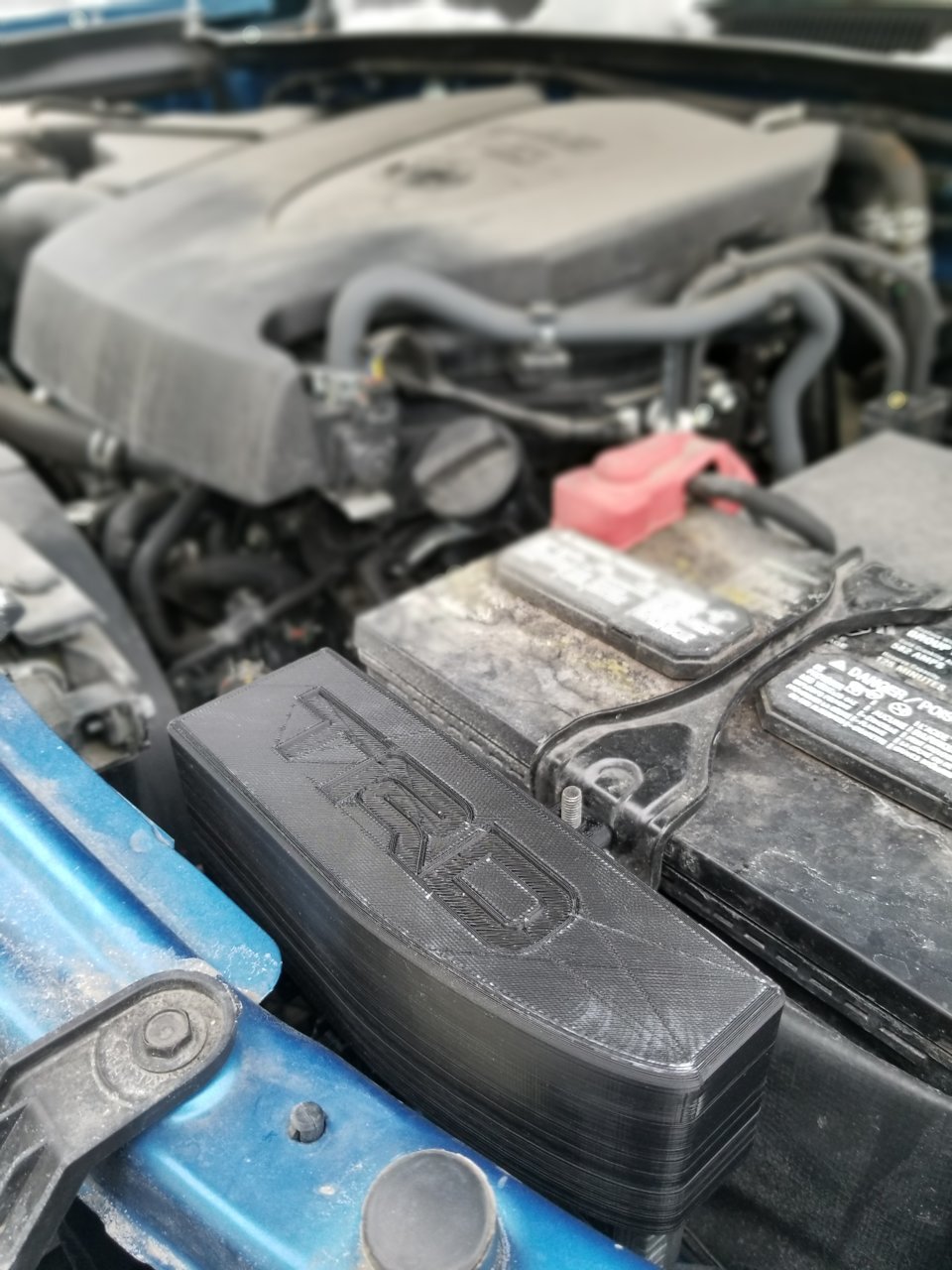

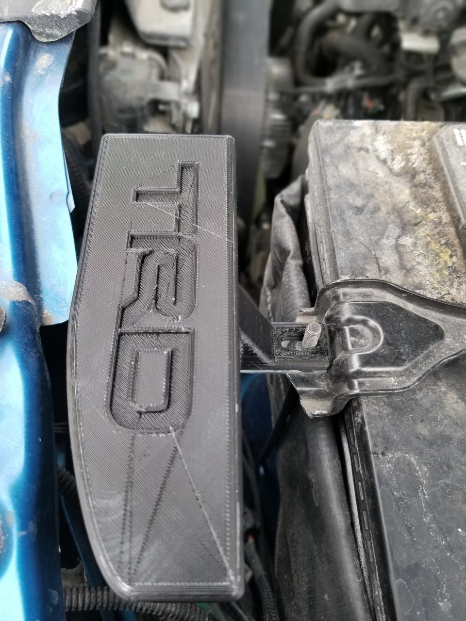

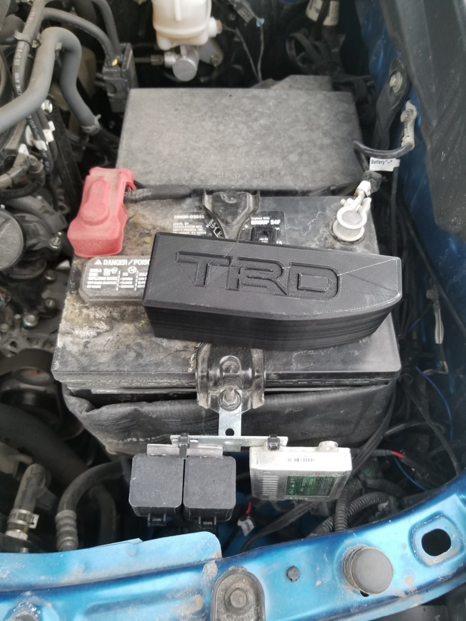

    Custom 3D printed HID / Relay cover!
    20200213_163658.jpg 20200213_163701.jpg 20200213_163726.jpg 20200213_163731.jpg

    Sharp! You should make a bottom for it as well so they are in their own box!
    shane100700 and abhamber[QUOTED] like this.

    I was worried about excessive heat and still wanted to maintain some level of ventilation.
