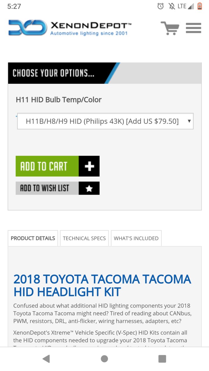

    A/C Drain Pro Grille Intermittent Wipers Blacked out Wheels Blacked out Badges Gasshole Nfab Predator Bars Tweeter Upgrade Kicker Upgrade Morimoto Amber LED Fog Lights Meso fuse box Stage 1 taillights
    Looks like XD has the Philips bulbs again .

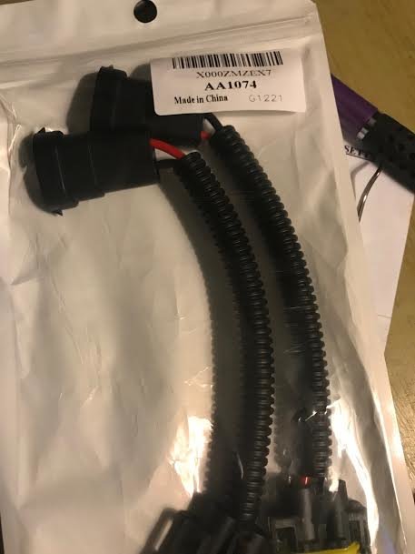

    What's the difference between these
    And these
  17. Feb 10, 2019 at 1:53 PM
    #257
    kakwvu
    kakwvu Almost Heaven
    Jun 27, 2016
    #190707
    6,768
    Kyle
    WV
    ‘24 JLURX
    That’s what my research shows, too.
    Sort of like flash lights. I got a small Streamlight and it came in possible two product numbers. One was an easy to open cardboard box, and one required a torch.
    replica9000 and Boghog1[QUOTED] like this.

    2003 DCSB TRD OR
    Yep, agreed. Googling the part number differences shows the same thing, packaging difference.
    replica9000 likes this.

    New Mexico
    The top photo is the newest packaging.
