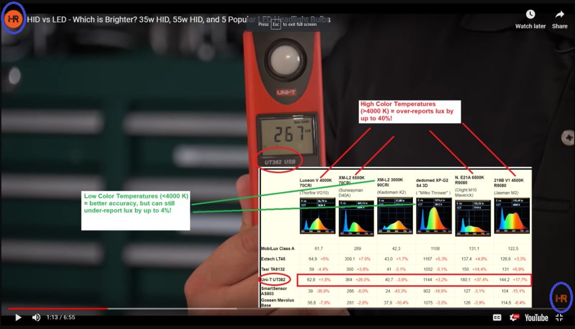

    I've put blue circles around who it's directed at:
    It's clearly not directed at OP, who uses a spectroradiometer, which completely sidesteps the issue of incorrectly/inaccurately tuned lux meters, as well as lux meters that are specifically tuned for the SPDs of LEDs. This is only directed at people who go out of their way to choose the world's most inaccurate lux meter so they can inflate the numbers of their LED bulbs (Headlight Revolution, TRS, etc.)

    So just some random dude on YouTube who may or may not have even heard of TW?
    Guess I’m just confused as to the point of your post?

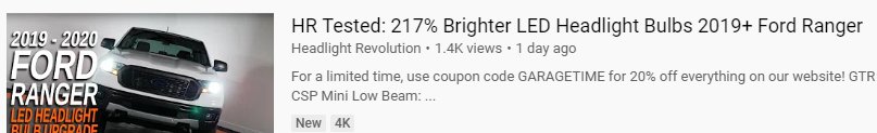

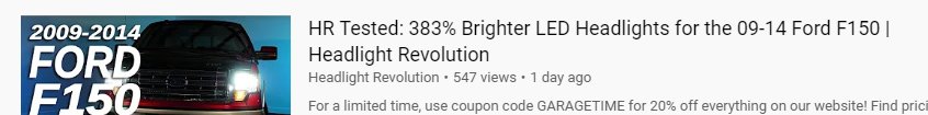

    I wasn't aware that Headlight Revolution is a random dude on YouTube
    https://www.youtube.com/user/HeadlightRevolution
    I just found the graphic interesting and it really goes to show that all their claims (below) need to be cut by 40% if not more.

    HR is so completely full of shit weasels.

    Sorry, I don’t follow any headlight influencers. All your circle showed was an “HR.”
    Got it. So no change, I’ll still stick to @crashnburn80 recommendations, supported by TW user experiences.

    Good idea, since he's not going out of his way to source inaccurate lux meters. Quite the opposite, actually; he paid extra for a NIST-certified lux meter and a spectroradiometer.
