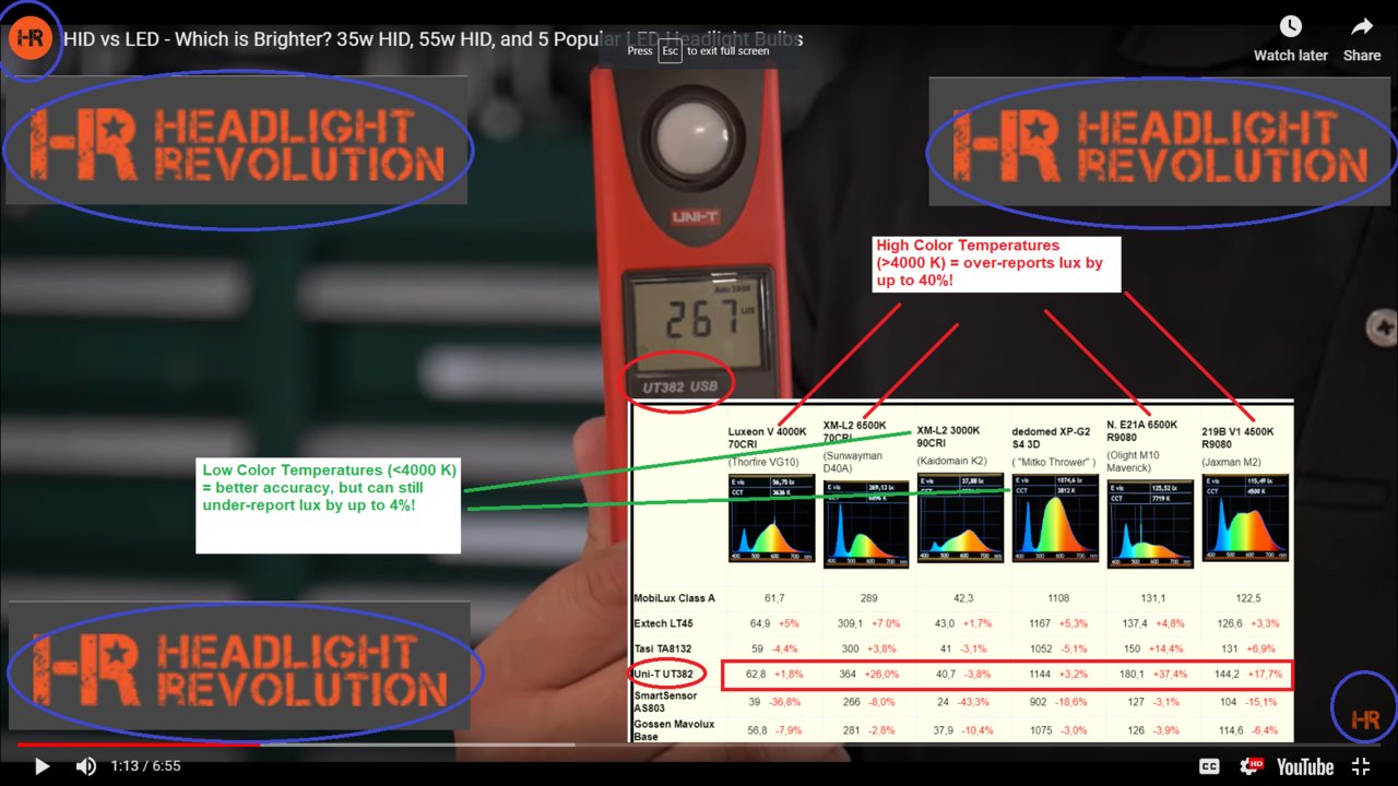

    The other thing lots of the LED shops do is test at very short distances, which conceals the lack of focus and highly inflates the output intensity values compared to what a driver will see in a real world application. I've seen some test as short as 12'. The best I've seen is Diode Dynamics which tests at 50'. I test at 18' indoors do to space limitation, and 42' outdoors which I do now primarily for testing LED focus.
    If you are set on 6000k the Hikari Ultras are the best drop in replacement I have tested. Not to be confused with the worse 'new' Hikaris. You want the Ultras, they were reviewed in post #3 with the other LEDs. As others mentioned they are outperformed by performance halogen alternatives. The replacement Morimoto LEDs (I think you mentioned later) are not recommended, even though peak lux reading are just above stock, the focus is poor due to their wide design and the hotspot is dipped far lower in the pattern than it should be.
