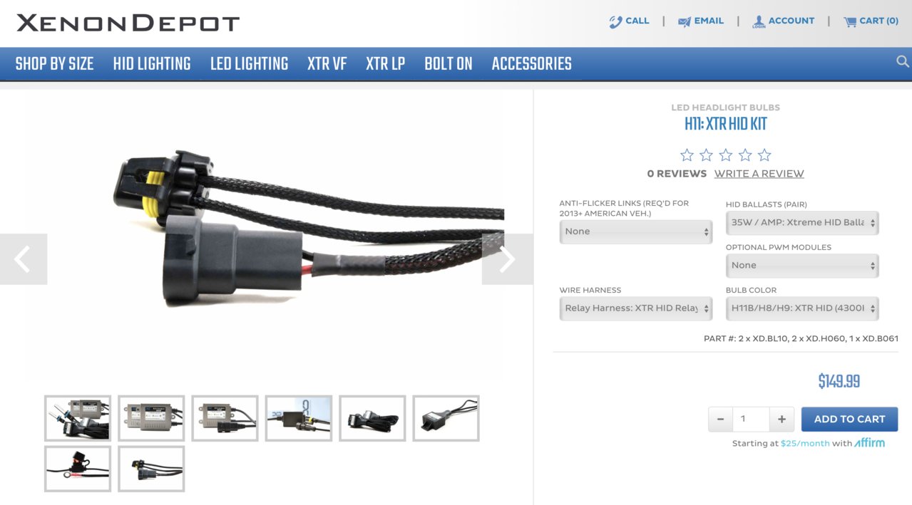

    Sorry...probably a dumb question:
    Are the H11 4300k Phillips worth the extra $150 these people are asking ($149.99 for the standard kit as is vs $274.42 with the Phillips bulbs)? Also, when reading the first page, the OP stated that we don't need a PWM module, yet these guys are saying all 2013+ "American" models do. Do we really need it? Are they implying "American" market vehicles or "American" vehicle manufacturers? Additionally, why offer the PWM in the first box then offer an optional one?
    Just started looking into an HID conversion kit. This crap is confusing AF.
    Thanks in advance.

    Yes, the phillips bulbs are much better.

    The XD Philips bulbs are about 36% brighter than the XD house bulbs. The XD Philips bulbs are also on spec for color output at about 4400k, whereas the XD house bulbs were lower at 3850k. There is also bulb longevity to which I have no comparison data. Worth the extra cost is up to you. In a halogen projector they will produce excessive amounts of uplight (glare) to oncoming drivers, and the Philips will be 36% more.
    The Tacoma does not use PWM, regardless of what they say you don’t need it.

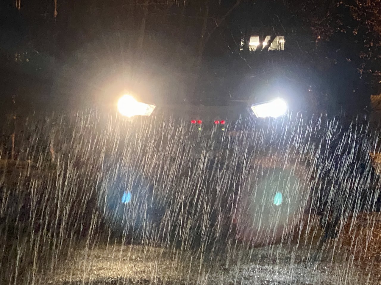

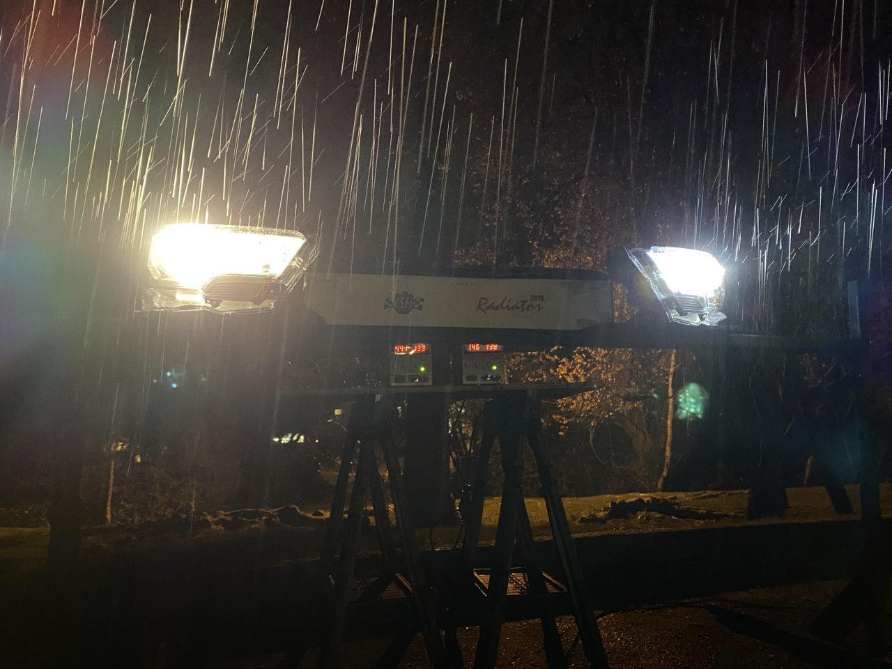

    Running outdoor distance test now. Trying to brave in between the rain showers but got caught being overly optimistic. Right now I have a giant CSF radiator box with a large plastic trash bag over it protecting my running power supplies in a down poor.
    Moments later:

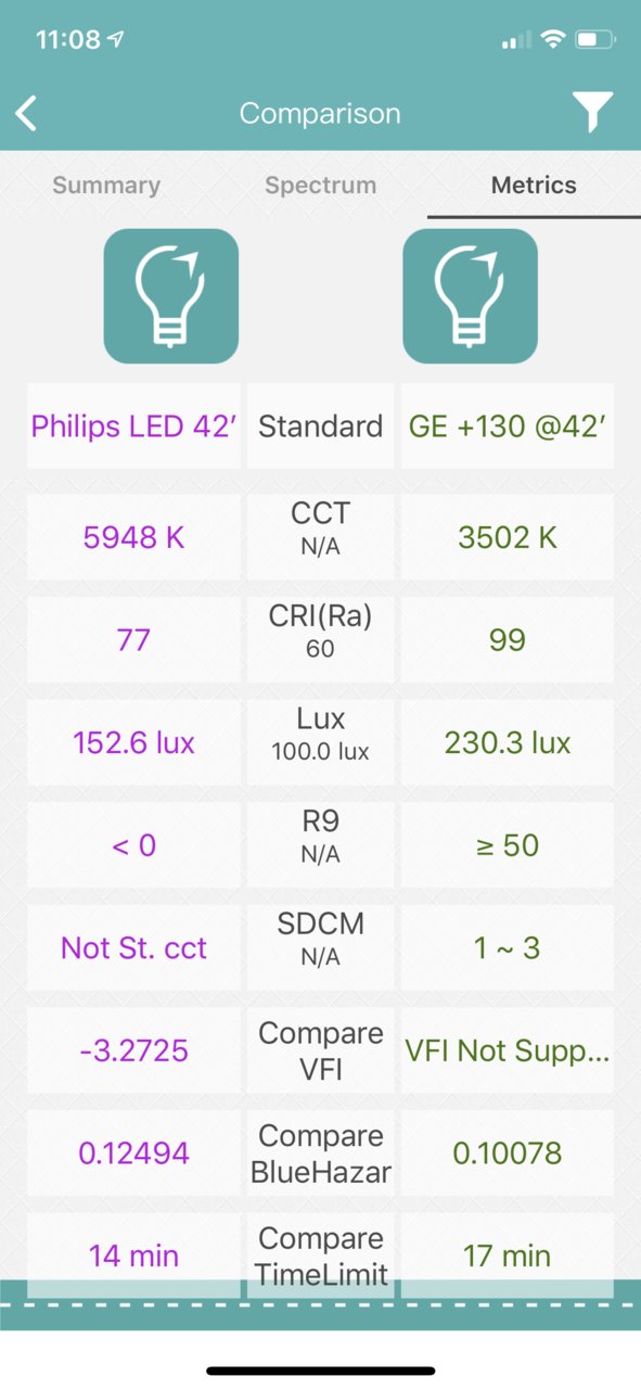

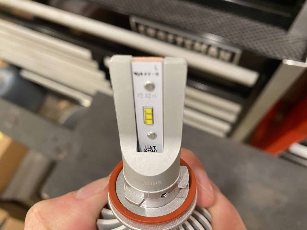

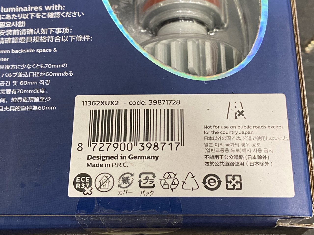

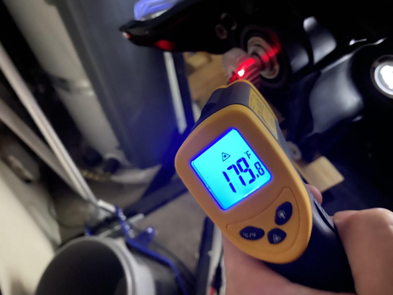

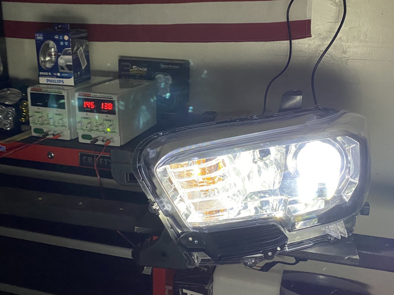

    Philips X-treme Ultinon H11 LED headlights
    Not available for sale in the USA, I imported these from Japan.
    Not to be confused with the H11 Philips low output fog light version commonly available in the USA.

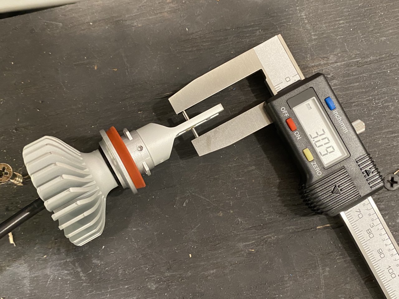

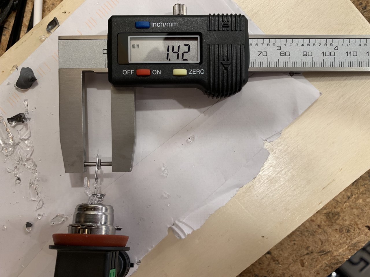

    H11 halogen filament cross section, 1.42mm. This is the target width for proper focus.
    Cross section, Philips LED 3.09mm. Over 2x wider than a standard halogen.
    For comparison to others, Sylvania's LED is 2.95mm and Hikari Ultra is 2.64mm. The Philips cross section is subpar, wider LEDs cause loss of focus and a dip in peak beam pattern intensity in the beam pattern from where it should be located near the top of the pattern. Not impressive.
    Interestingly the Philips LEDs specify right/left on the blade. The bulb tabs should prevent incorrect installation, so the cause seems somewhat dubious. As a credible manufacture Philips doesn't make those garbage 'adjustable' style LEDs promoted by lessor manufactures.
    The Philips LEDs are advertised as 22w. After 15min runtime in 59 degrees ambient temp, they pulled 20w. (1.45A at 13.8v).
    After 15 min of runtime in 59 degrees ambient heat, the Philips heat sinks were hitting nearly 180 degrees. Note these are the highest performing passively cooled LEDs I am aware of. Others performing at this level are using active fan cooling. As such you'd expect high temperatures on the passively cooled heat sinks.

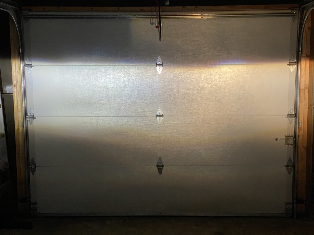

    18' indoor test.
    Philips LED 809 lux left vs GE +130 1085 right. Recall photos make higher color temps look brighter.04B54A00-E227-42DC-9549-D64FBA610F85.jpg
    The Philips LED Hot spot is poor, which is not surprising given the cross section width. While the halogen peak intensity is near the cut off, where it should be for proper distance projection, the LED 'hotspot' is clearly dipped in the pattern.

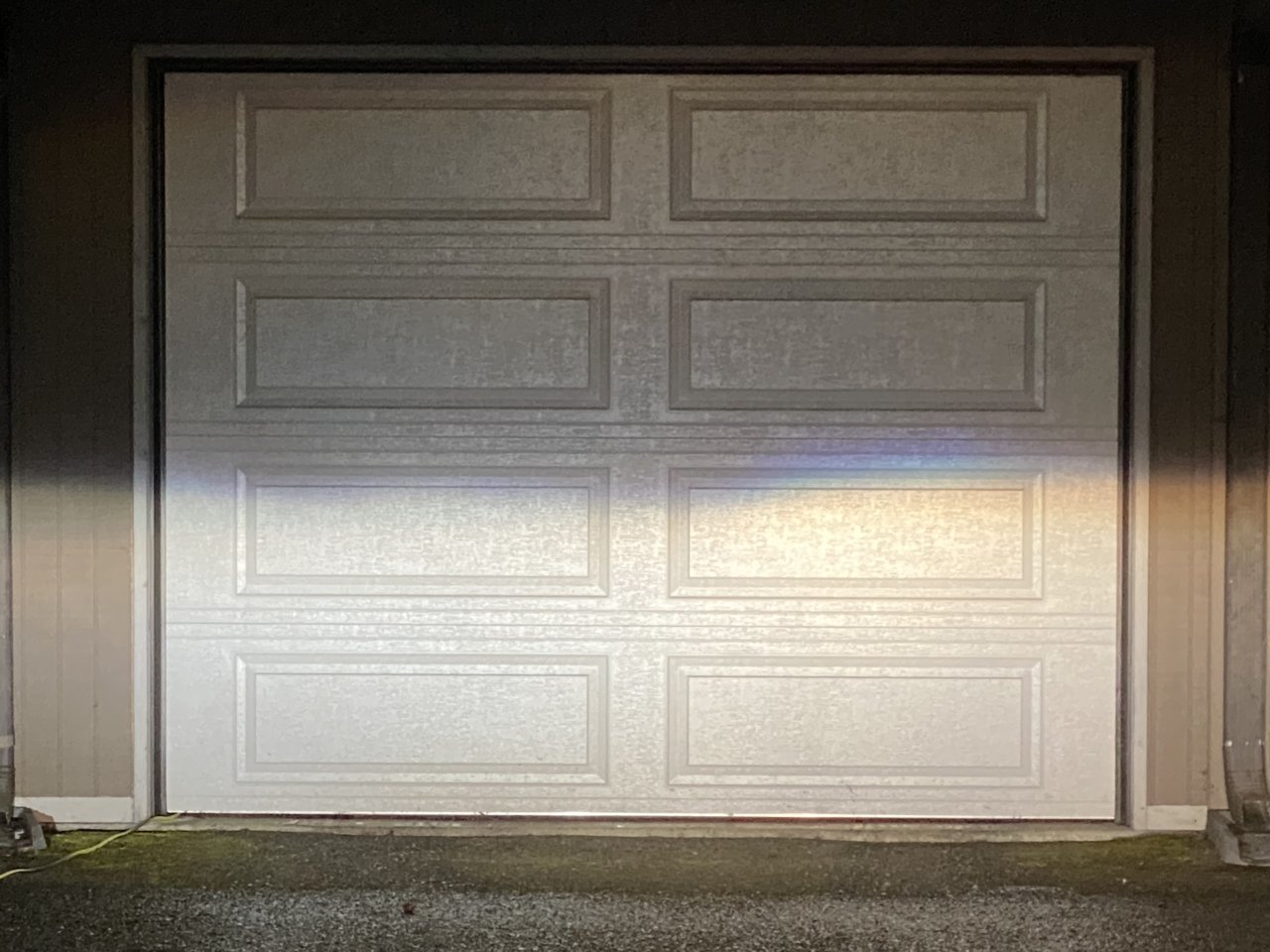

    42' Distance test
    Philips LED 152 lux left vs GE +130 230 lux right
    A basic H11 performance halogen (GE Megalight +130) outperforms the peak output intensity of the Philips LEDs by over 50% in the 3rd Gen Tacoma projector. And the GE Xenon +120s perform even better than the +130s.
    But compared to stock, the peak output intensity of the Philips LEDs is slightly higher than stock at 42'. Philips LED at 152 Lux vs Stock at 144 lux.
    But here is the problem with simplistic single peak intensity lux numbers, they do not tell the entire story. While halogen peak intensity lux values are up near the cut off maximizing distance projection, here is where the peak Philips LED lux value was recorded at:
    15" down below the cut off for peak intensity output, which is far from ideal. Dipping peak intensity causes increases in foreground light and losses in distance projection. This picture should speak volumes about how LEDs will cause loss in distance projection performance.
    While these Philips LEDs have the 2nd best peak intensity recorded behind the fan driven Hikaris, and are the highest output passively cooled LEDs, I'd still rate the performance as poor and not recommend them.
