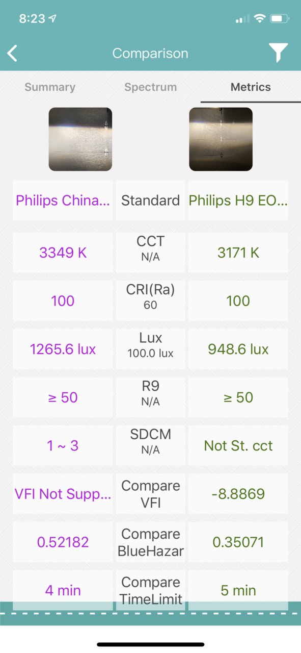

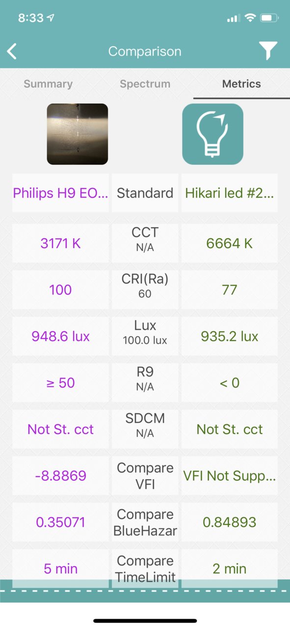

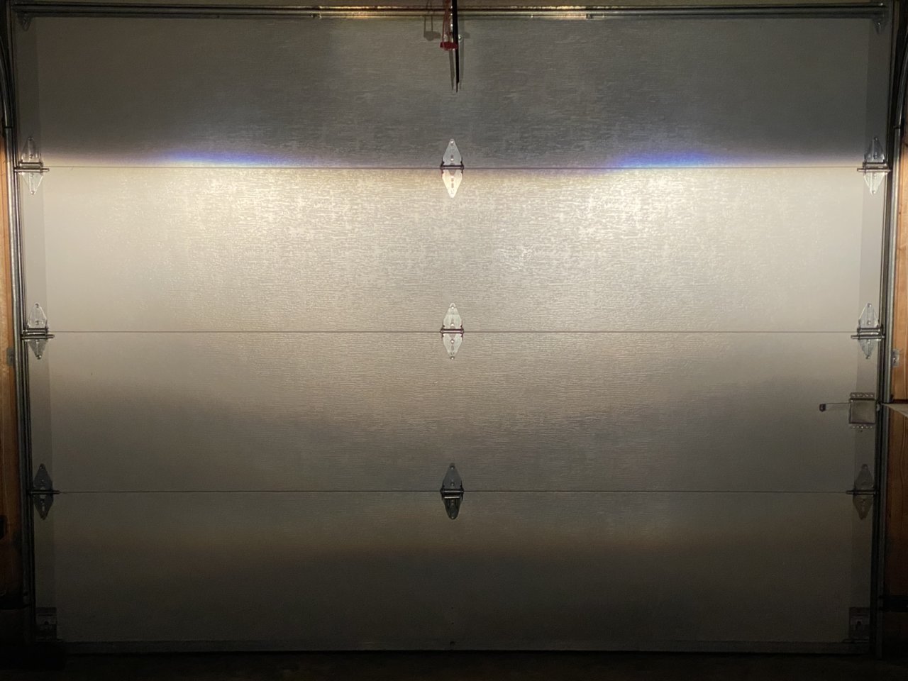

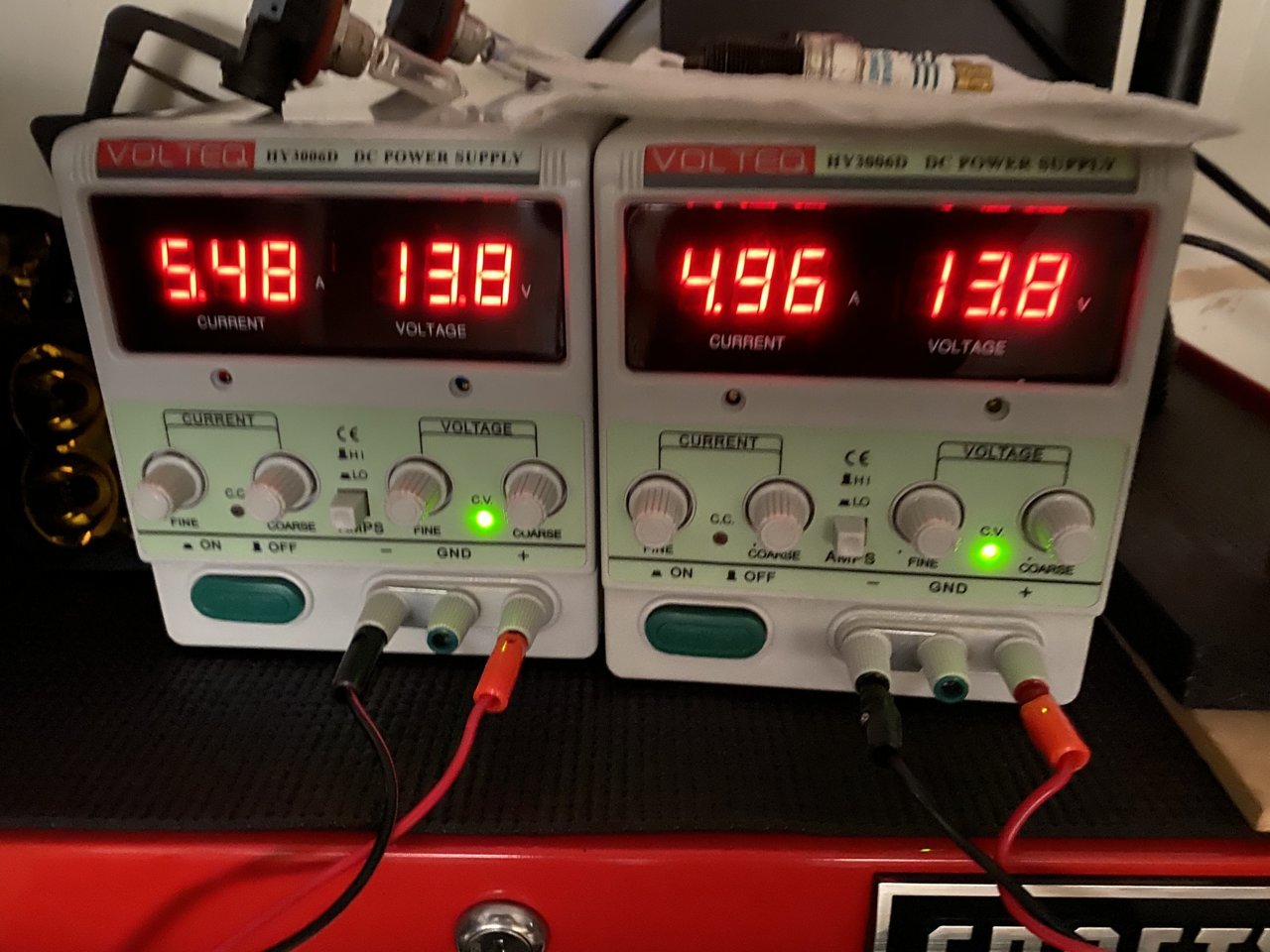

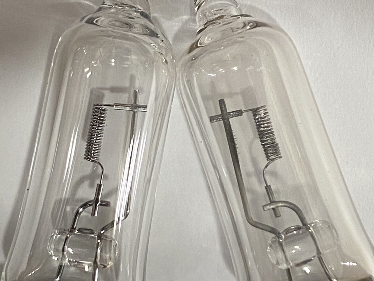

    End of life H9 bulb testing
    @skierd sent me his Philips H9s after one blew to evaluate the performance loss over the life of the bulb, as halogens dim over time. Since both bulbs were installed at the same time and run till one failed, the other bulb is effectively at the end of its life span.
    New Philips Left vs EOL Philips Right
    Clearly the halogen cycling has taken a toll on the filament.
    EOL Philips H9 left vs new H9 Philips right
    New Philips H9 vs EOL Philips H9 (both China made)
    You can see the EOL bulbs suffer about a 25% output loss, which is reasonably consistent with my other EOL halogen output loss findings. I believe I’ve seen GE claiming their Xenon bulbs only lose 10% over their lifespan, though the lifespan is much shorter.
    What was also interesting, the EOL bulb draws less power, by about 0.5A.
    New H9 left vs EOL H9 right
    It is also worth noting that peak intensity of an EOL Philips H9 bulb is still slightly higher than peak intensity of the best tested replacement LEDs to date, the Hikari Ultras at stable output in a 3rd Gen projector.
    Remember to always replace bulbs in pairs. If one bulb failed the other is likely not far behind. You want the best performance possible and a 25% loss is noticeable, however with gradual dimming over time you won’t notice the difference in daily driving, but you will likely notice a difference after installing a fresh set of bulbs.
