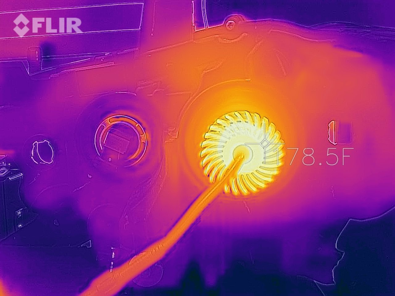

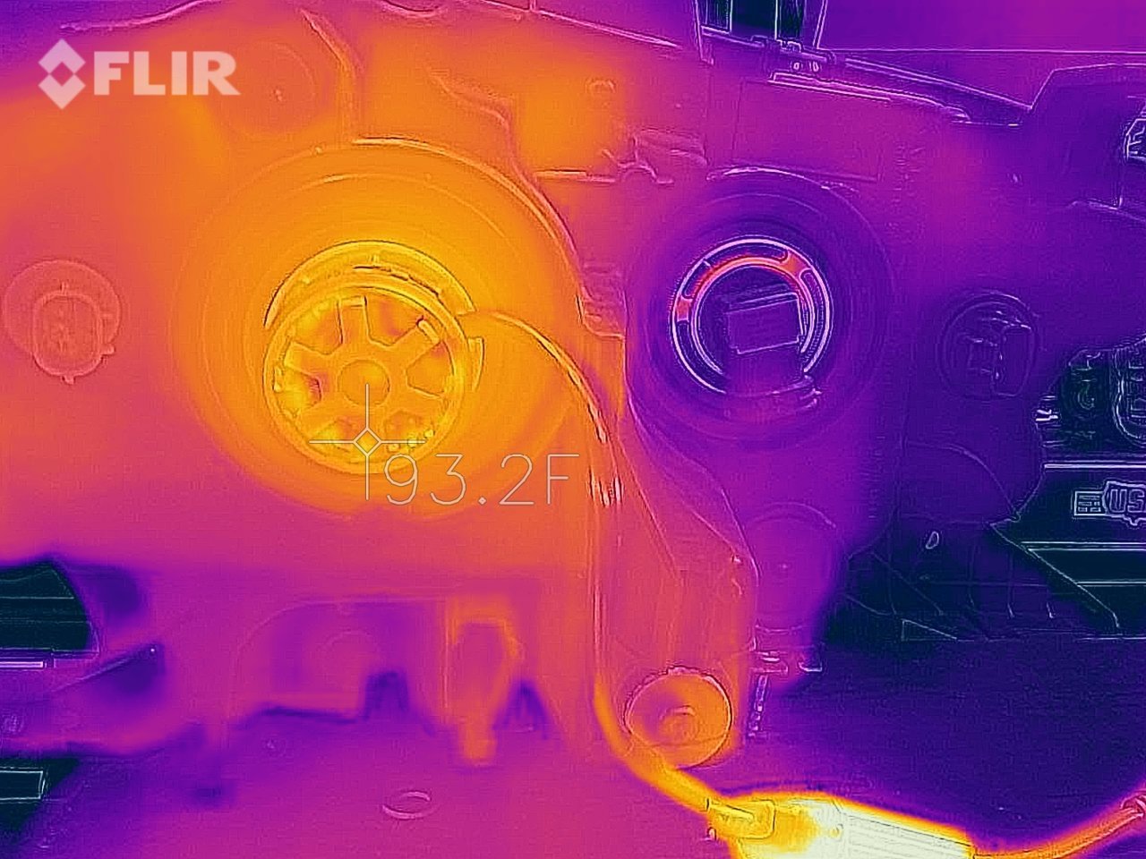

    Some interesting thermal testing for the Philips passively cooled LEDs vs the Hikari actively cooled LEDs. LEDs were run for 20 minutes in 64 degrees ambient.
    The LEDs Philips are hot
    As expected with fan cooling, the Hikaris are much cooler, 85 degrees cooler.

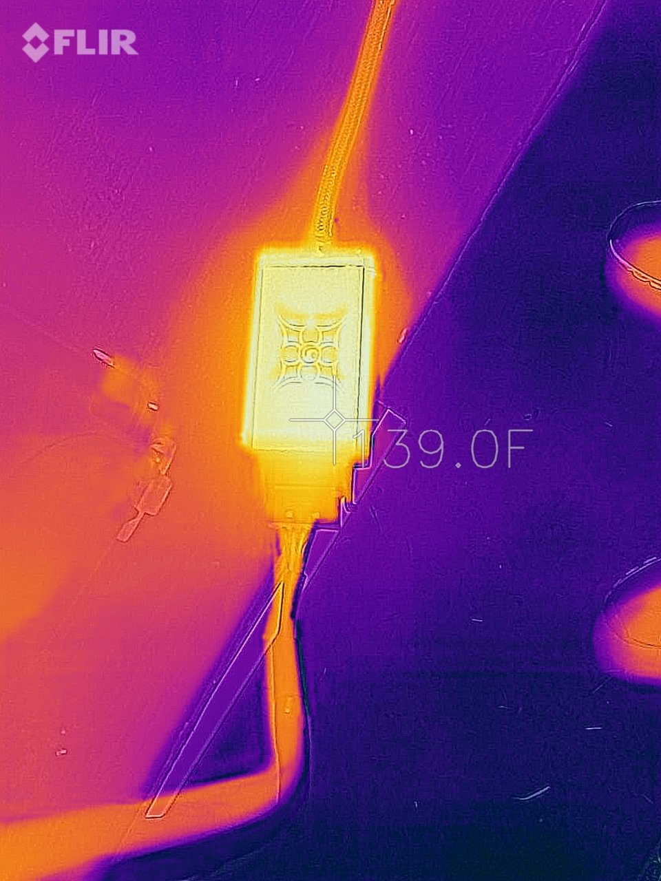

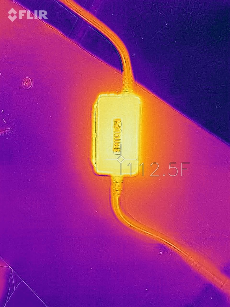

    It is worth noting the Hikaris pull almost 30% more power. Looking at the drivers, the Hikari runs almost proportionately hotter to the power difference.
    Philips driver

    While the vehicle is in motion, I wonder if the Philips might run much closer in temp to the Hikaris.

    Not going to get a whole lot of cooling flow behind the headlight, if anything I’d expect it to likely run hotter being in the engine bay.

    I suppose the housings can handle those temps. People stick them in the oven at 300° just to soften the glue to take them apart.

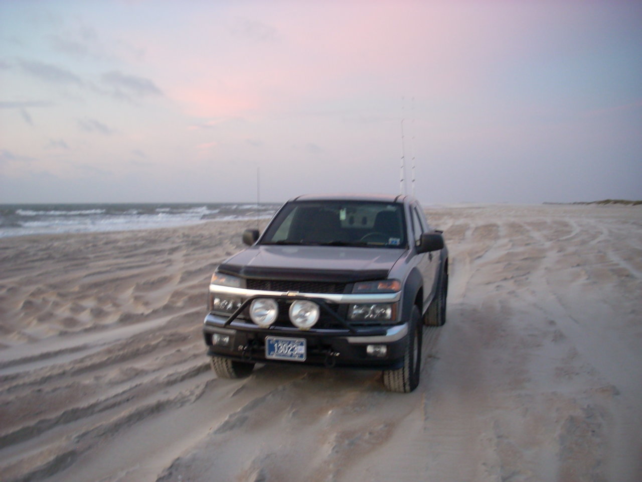

    A large reflector, purposely designed for the application, makes a HUGE difference. I had a pair of Pro Comp 9911 lights using 55W H11 halogen bulbs with 9" reflectors. They were bright AF! Seriously off road use only.
    I don't think they make them anymore, but there's still NOS available.
