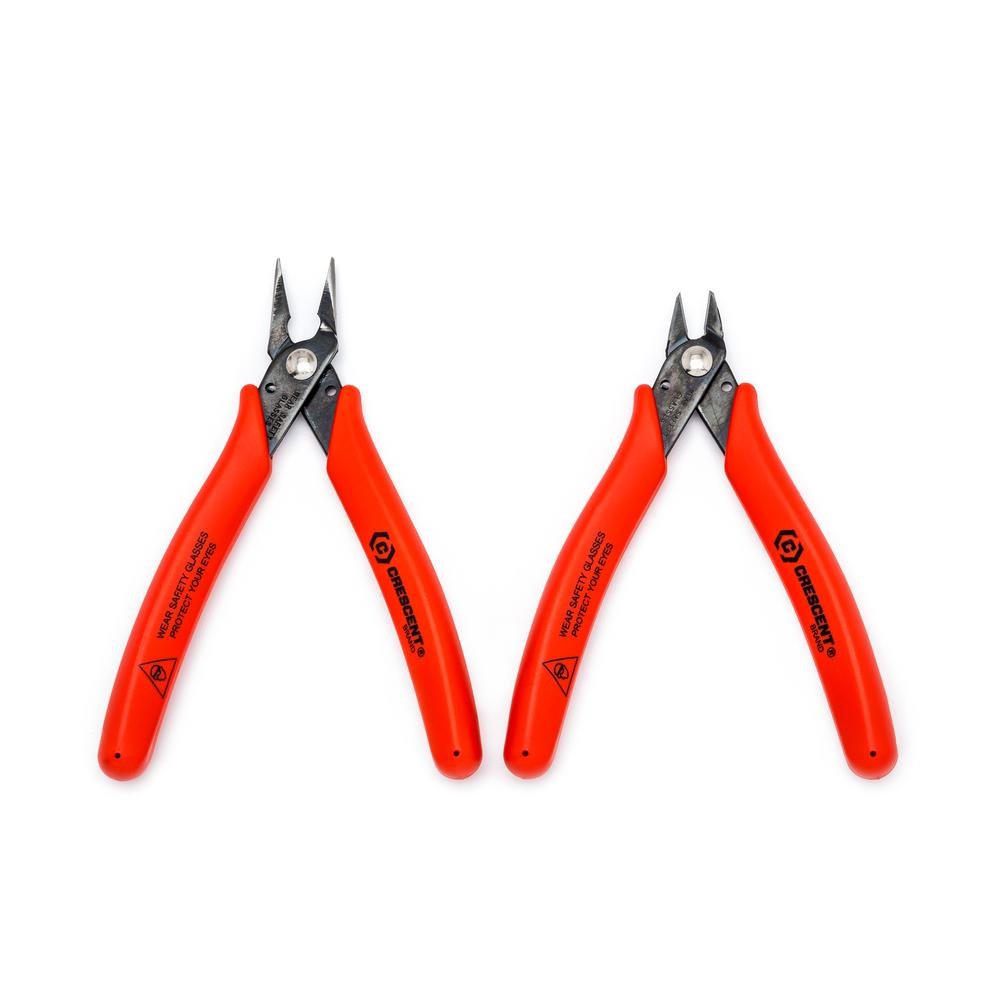

    As others have posted, you can use the adapters and modify them. I needed some small wire cutters and got a flush cut wire cutter and mini pliers when I was doing some wiring work. The flush cutters will make short work of the H9 plug tabs for drop in convenience. Got them at Home Depot.
