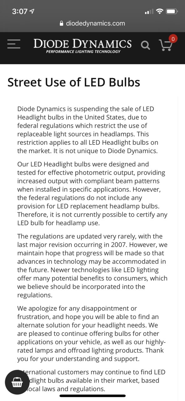

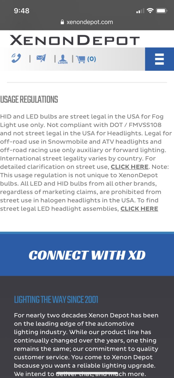

    Probably because they are illegal for street use, and someone from the government department in charge of such things sent them a cease and desist order.

    Gee, this is gonna disappoint a lot of folks who favour bling over performance. But it could also make driving a little safer..........

    Sort off. They removed all listings for headlight bulbs from their website and now sell them as fogs only (which are not regulated at the federal level). Other brands have started doing the same, at the same time. Clearly something changed.
