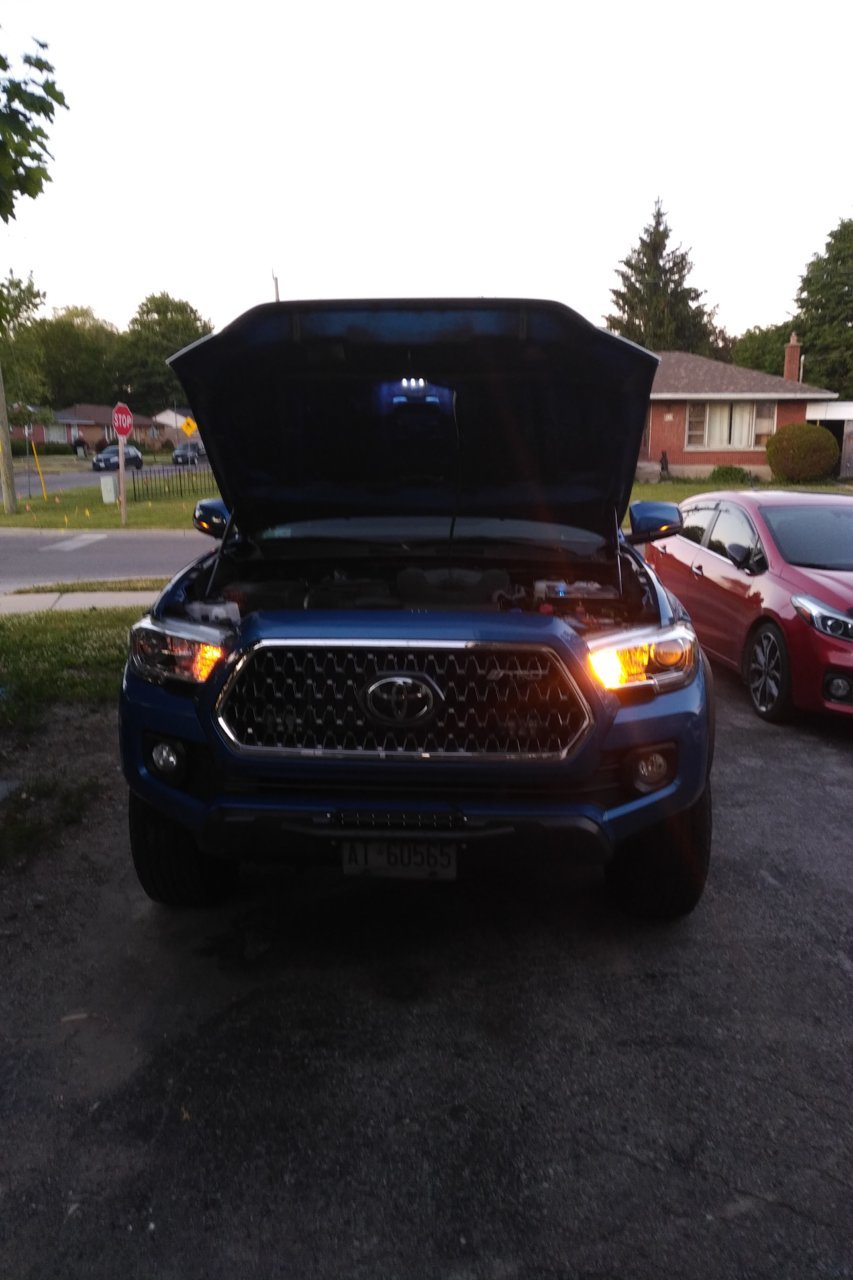

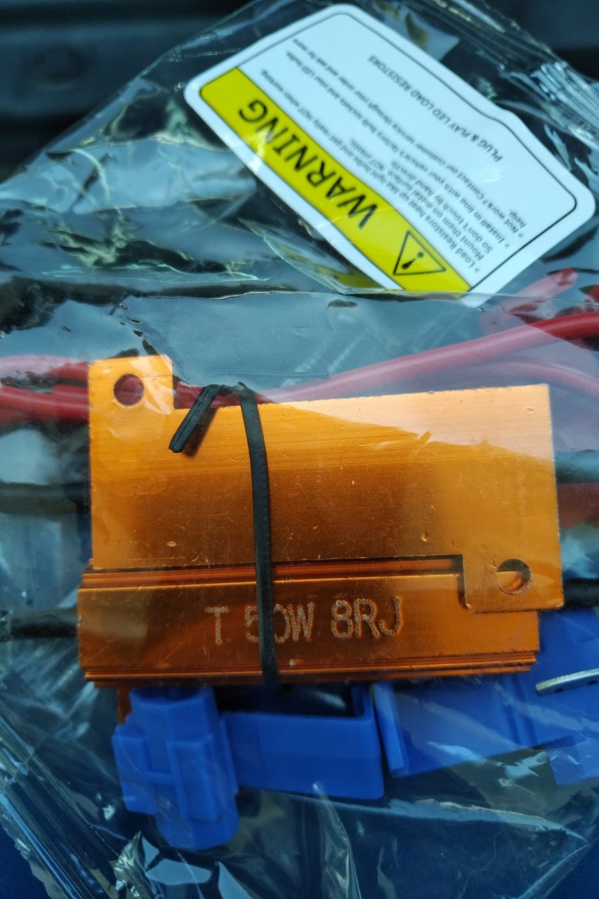

    Not sure where to post this issue I have so I will start here.
    So I upgraded the mirror housings with sequential flashers and replaced the mirrors with LED arrows in them with no issue. Then decided to replace the front signals with LED and everything appeared to work for a day. Then I started getting hyper flashing so I installed this resistor pack on the front LED flashers. Still getting hyper flashing. Anyone find a solution for this that does not involving replacing the front headlight assembly entirely?
