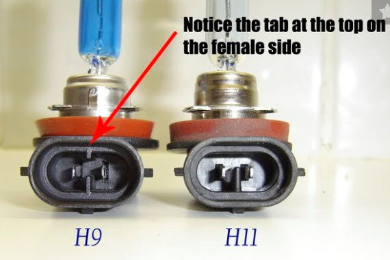

    So on a 2020 Offroad, it seems like some Philips H9s in Low give a pretty good performance for minimal fuss/expense? Do I have that right?

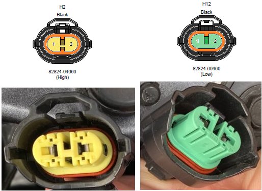

    The OEM lights are not HIDs. But to swap to the OEM LEDs you need the adapter harness. There is a thread on here of someone who sells another one as well.
    https://www.theretrofitsource.com/H128?quantity=1
    The Amazon one others have used is linked in post #2, but that one posted above looks nicer. Simply modding the bulb base is easy to do though and eliminates unnecessary wiring. Any extra wiring theoretically reduces performance, although by an unnoticeable amount in this case.
    Correct. They will provide the best performance the OEM halogen lights are capable of.

    Got my h9s in the lows. Major difference. I did have to trim the metal keyway for it into my headlight housing. Something that should be mentioned.

    It is tricky but possible to fit the Philips H9s in the 3rd Gen lows without trimming the outer metal tabs. It is about finding the right angle, they don't go in nearly as easily as the H11s.

    On my 4Runner, I was able to get the passenger H9 in almost right away. The drivers side, I gave up after 10 minutes and trimmed the tab. Popped right in after.

    I haven't tried on 4runner headlights. Sometimes trimming the tab can be worth it to just make it easier.
