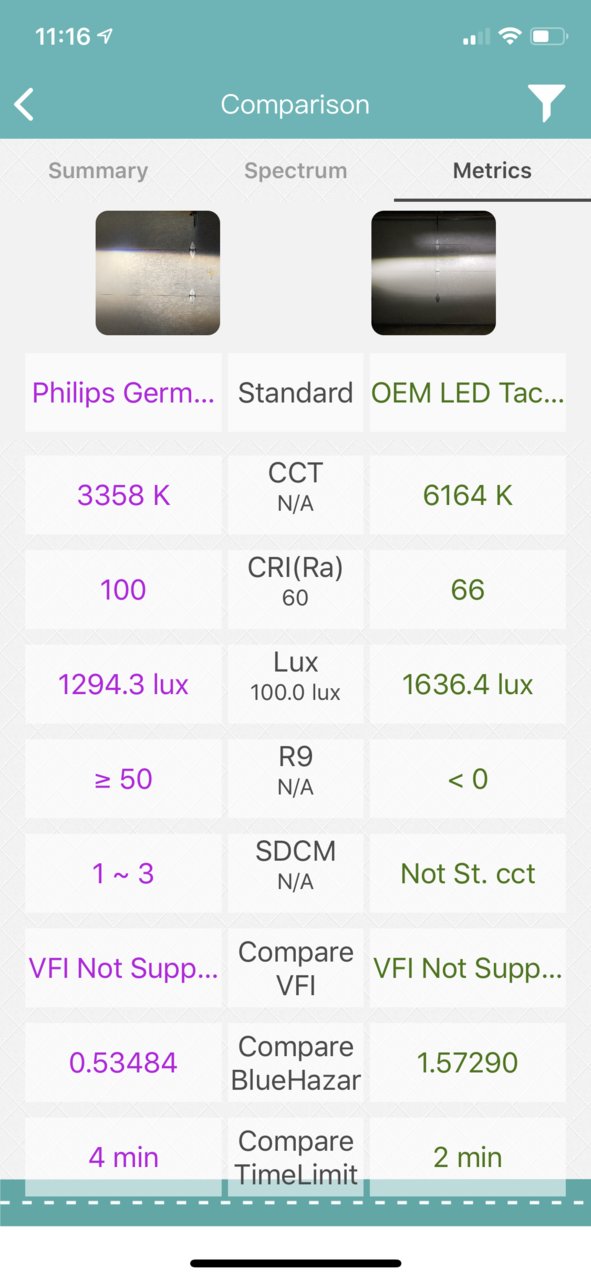

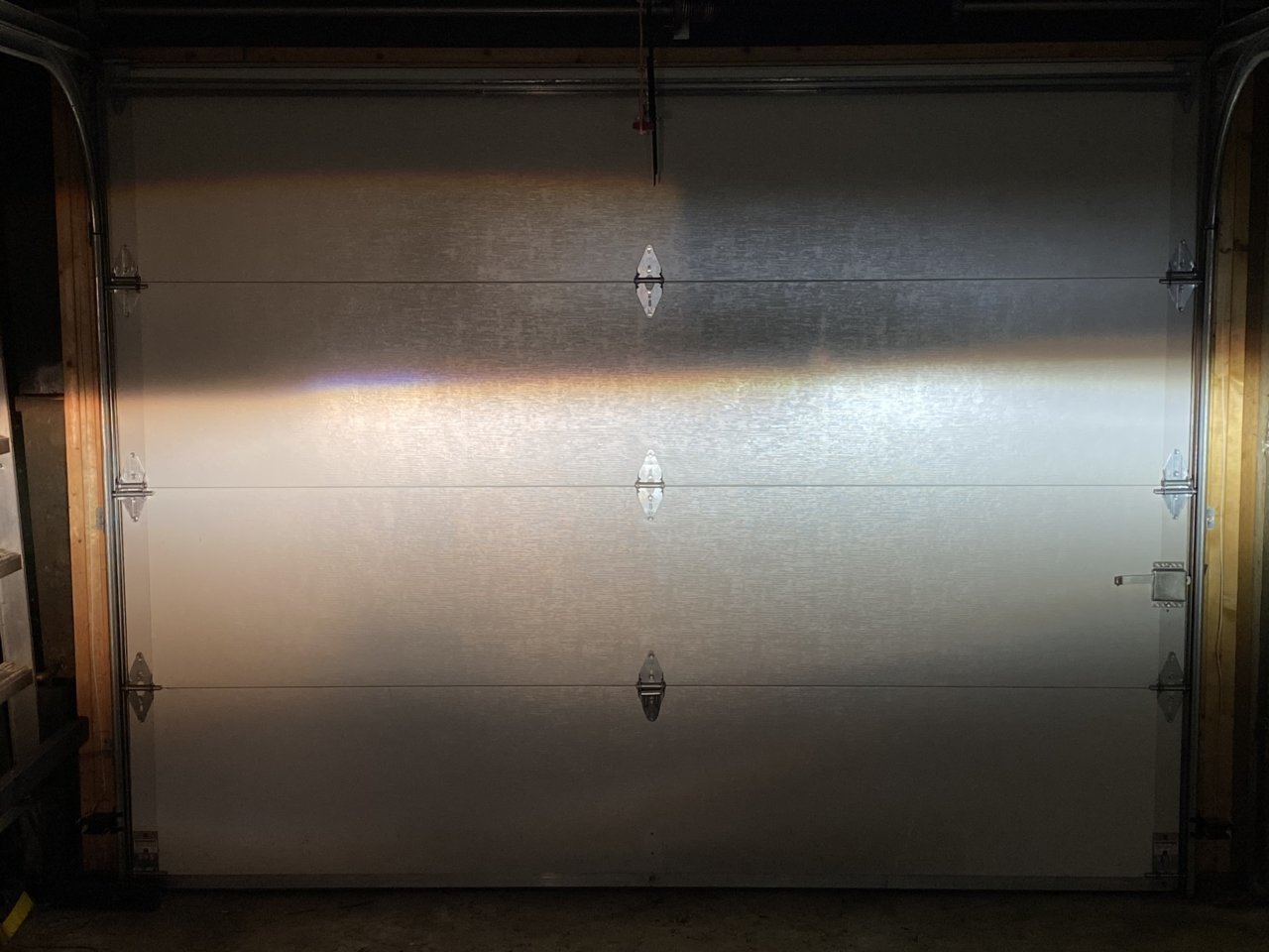

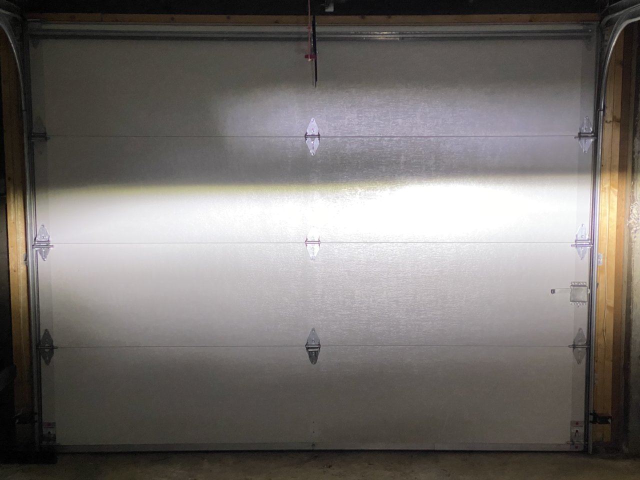

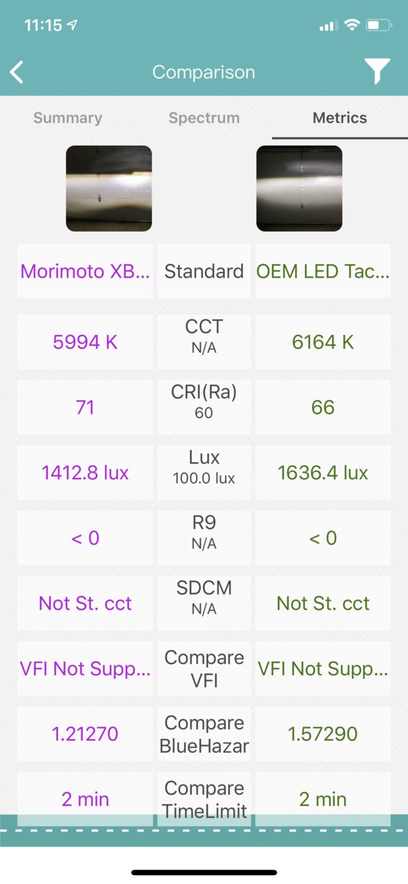

    OEM Tacoma LED Headlights
    These results are extremely preliminary and not the final review
    Ran into a few very minor but inconvenient setbacks, the new 3rd Gen LED headlights lack the rear tab present on the halogen lights that I used to secure and aim them on my rack. Interesting that component changed but still fit the same trucks. I did an initial test indoors but will want to come up with some better way to secure them for an outdoor distance test. I also had one of my fine power supply leads go out, so I had to hold the lead with one hand while trying to get a comparison pic with the other. This is not a complete review, the most critical measurement is the distance measurement, which was not yet tested at this time. This is just some initial data as I know many are interested.
    Beam pattern
    Right beam only pictured. The beam pattern looks to be excellent, the hot spot is right up at the cut off where it should be and the highest intensity parts of the pattern carry up near the cut off across the pattern with a very smooth and full natural blend downward.
    GE +130 vs OEM LED
    The GEs certainly look brighter in this picture, but the measurements say otherwise. The OEM LEDs do have uplight above the cut offs unlike Morimotos, (headlights are supposed to have mild uplight) though that uplight appears less than the halogens running performance bulbs. The OEM LEDs appear to do an great job of matching the halogen pattern in light distribution.

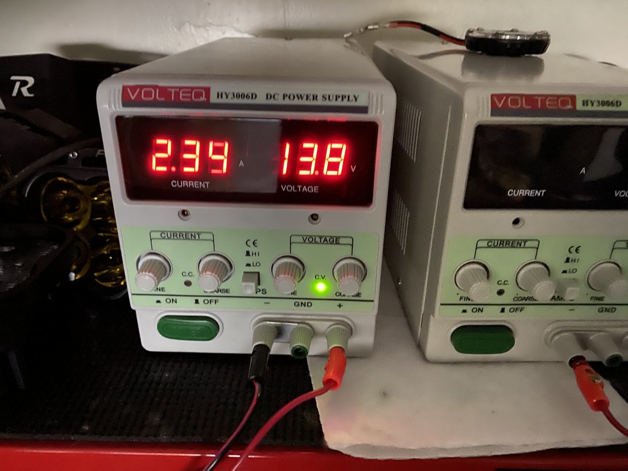

    Here is where it gets interesting.
    Recall the most efficient form of lighting projection technology is well designed reflector. A reflector is far more efficient than a projector, which blocks light from leaving the assembly, but the projector does have a small form factor advantage which is often why they are often used. The 3rd Gens projector headlights were a significant downgrade in performance than the massive 2nd Gen reflectors, but it allowed for more modern styling. If you look at KC's gravity series, their lights outperform the competition using a fraction of the power and lumen output because they use highly focused reflectors which are drastically more efficient. Their 8w G4 gravity fog can go toe to toe with a 22w projector based Rigid fog. While some might bash Toyota's decision to use reflector LED headlights instead of projectors, it is the higher performing more efficient technology and the better engineering design decision.
    Using a more efficient projection technology, one might expect the OEM LED headlights to draw less power than say Morimoto who which uses less efficient projectors. But they don't. They draw more. Morimotos draw 1.46A, or about 20.2w. The OEM LED headlights draw 60% more power at 2.34A, or about 32.3w. Combine higher power with higher efficiency projection and the results shouldn't be suprising.
    OEM LED low beam draw
    As measured at 18', Morimoto vs OEM:
    German Philips H9s vs OEM:
    Based on initial testing, the OEM LEDs have excellent beam pattern distribution, they don't have the odd dark spots below the hot spot that Morimoto has or the less than ideal double cut off low hot spot, the OEM lights have appropriate uplight unlike Morimoto and they are higher in peak intensity output than Morimoto or a Philips H9 bulb swap. To further put the low beam performance in perspective, lux at 18' with the OEM LEDs is higher than the Xenon Depot brand HID swap, while being street legal without blinding glare.
    I still need to do the critical distance test to evaluate focus and high beam comparison tests, but initially these appear to be an outstanding performance lighting option.

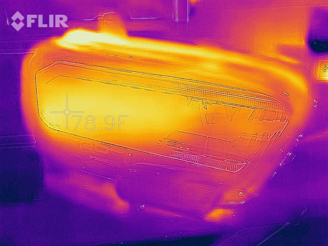

    Would you be able to look into how hot the OEM lights get next time you have them fired up? Wondering about their ability to melt snow and frost as I’m picking up a 2020 soon and am considering these lights.

    I did take a FLIR thermal reading, they did have a little forward heat. I think it was about 10 degrees over ambient. I’ll be sure to capture the delta more specifically next time. Note in the image export the scale is not shown, this plot ranges from about 60-83 degrees, with ambient temp of about 69, so it isn’t as hot as one might think by looking at the image.
