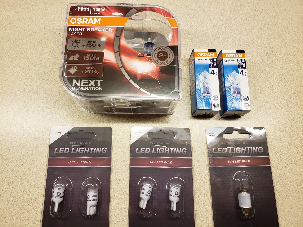

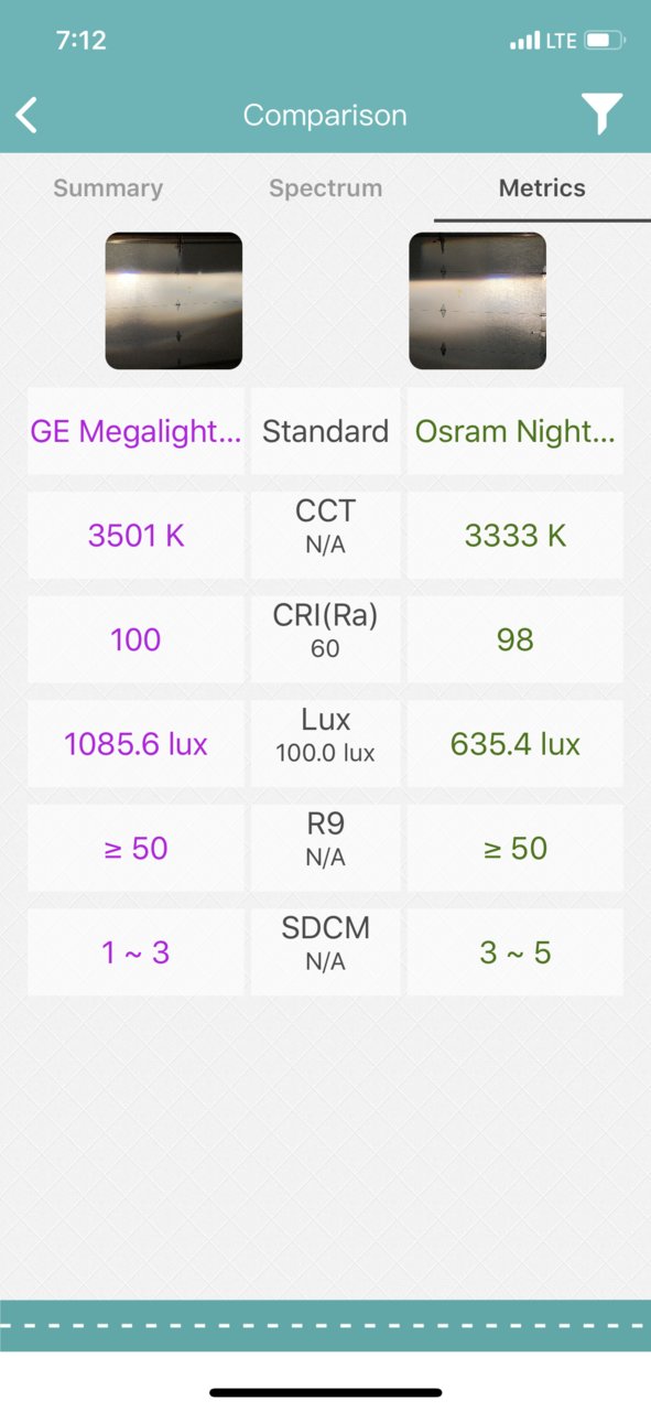

    You’ll like the reverse lights but the +150 lasers are disappointing. They have too much blue coating I think. They are an upgrade from stock, but not by as much as it would seem.
  19. Feb 14, 2019 at 7:25 PM
    #299
    WiscoPat
    WiscoPat One does not simply purchase a Ridgeline
    Jan 1, 2019
    #277680
    1,853
    Pat
    Wisconsin
    2019 TRDOR Tacoma 1995 JDM 80 Series
    Mall Rated
    I figured as much going into it, but could not find the GE's in stock from the usual dealers and the nightbreakers were on Amazon for just over $30. More out of desperation to improve output from stock than anything.
    That being said, I may end up liking them fine - the low life of the GE's are still a sticking point for me.
    Bottom line though, your info and content has been top notch!
